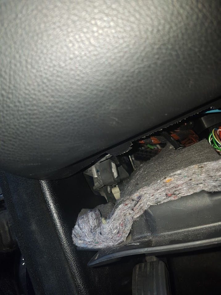

Also check the parking brake "switch" that are in front and over the parking brake if you are sitting in the drivers seat. Mine came loose which caused the light to stay on.
I am "pointing" on the switch on the second picture. I just clicked it back in place.

I found the switch and was loose as you said. I snapped back in place and back to normal.
Thanks again
