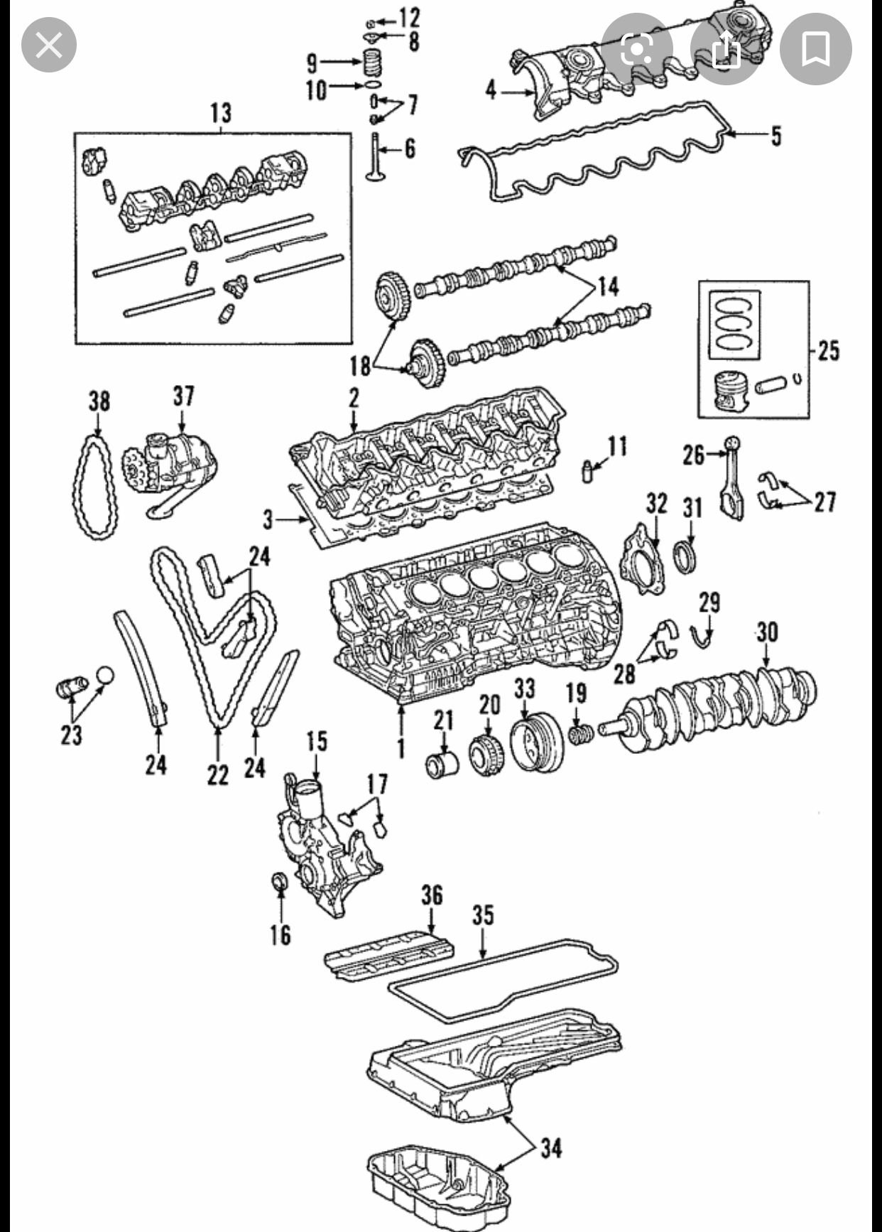

Simple. Where the engine meets the transmission, right smack in between them. Best to remove transmission and find it right there sticking out of the engine. Located on the graph #31 and #32. 31 will be your seal and 32 will be the retainer, check for cracks or just replace it all together for that retainer for less headaches in the future. It literally cost “$32”
