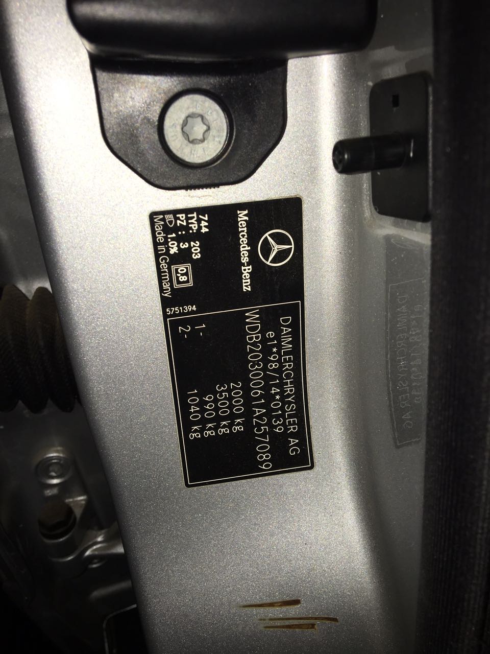

I think this is the VIN number(picture attached)

I have replaced that gear selector in my CDI and I think I used the same part which I had in my car (ending 2524)
See my thread for DIY, hope it helps you
https://mbworld.org/forums/c-class-w...ode-p1856.html
I bought it for $130 from Ebay, dealer wanted $1300, there is one for sale in ebay.co.uk for £134 right now (A 203 267 25 24)
It is not too hard DIY, there is video attached. Reserve approx. 1h and 3 beers.

Been through this. Thought, how different can they be?
Early versions have wires coming out with connectors on the wires.
Later versions have just connectors on the module.
Pulled on from a 2003 1st, it worked for a little while, but I wasn't able to connect
both connectors, so shift surround didn't show the gear I was in but did on the dash.
Before long though, it was not working and going into limp mode...again.
Parked and waited....till a 2002 C240 showed up in picknpull. (or was it 2001?)
Nabbed it and returned the other one. Was exact replacement and still working...
$30. But had to go to Richmond...which is like Oakland but worse....
Whats the pn # on yours? Should be a 203XXXXXXX pn.
