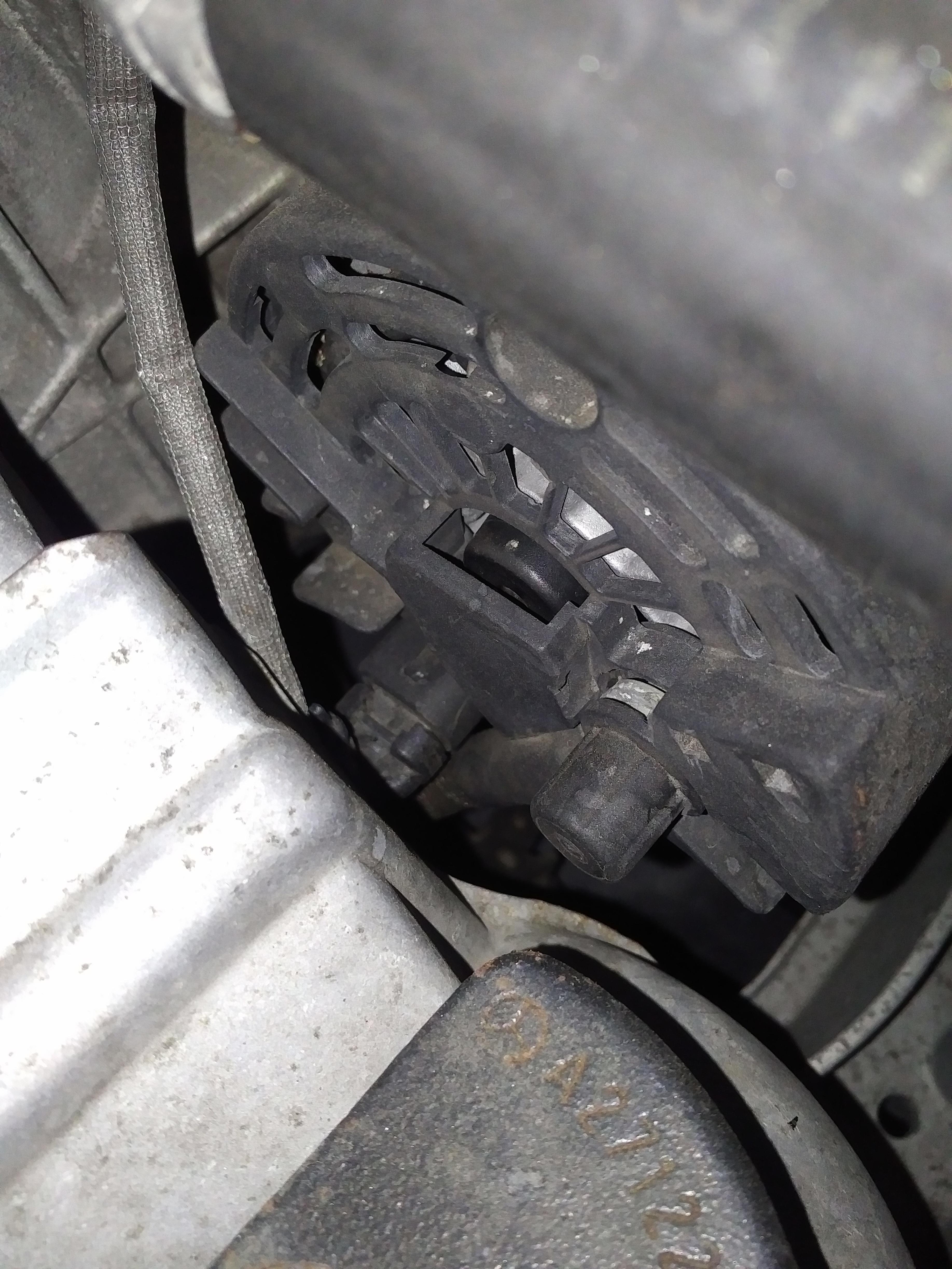

Ok. So I need a little help. Picked up a brand new Bosch alternator. I put it in the same way the old one came out. However, when I tighten it down, the alternator housing is hitting the side of the engine block. If I rotate it 180*, it no longer hits, but now the wiring will not reach. Can someone take a picture or look at the back of the alternator in their c230 and tell me if the black plastic plug is on the top or bottom and if the large positive cable is at the top or bottom?

Ok. I got it figured out. The Bosch does fit. I had some work done a couple years ago in which the alternator was removed. The shop reinstalled the alternator incorrectly which is why the Bosch was hitting. I have some questions regarding the wiring. Can someone take a picture of the routing of the sensor wire and the large positive cable that attaches to the alternator? Thanks.

I'll take some pics for you in the am, but IIRC the sensor wire clips to the heat shield behind the PS reservoir, then is routed down between the engine block and the PS reservoir to the alternator. The main cable is not very long so its routing shouldn't be difficult to figure out, as long as it doesn't get to rub on any bare metal..

Here are some pics...
Attached Thumbnails Alternator interchangeability-img_20170624_0826334.jpg   Alternator interchangeability-img_20170624_0949337.jpg   Alternator interchangeability-img_20170624_0950028.jpg

thanks for the pictures. They were a big help. Got everything back together today.
