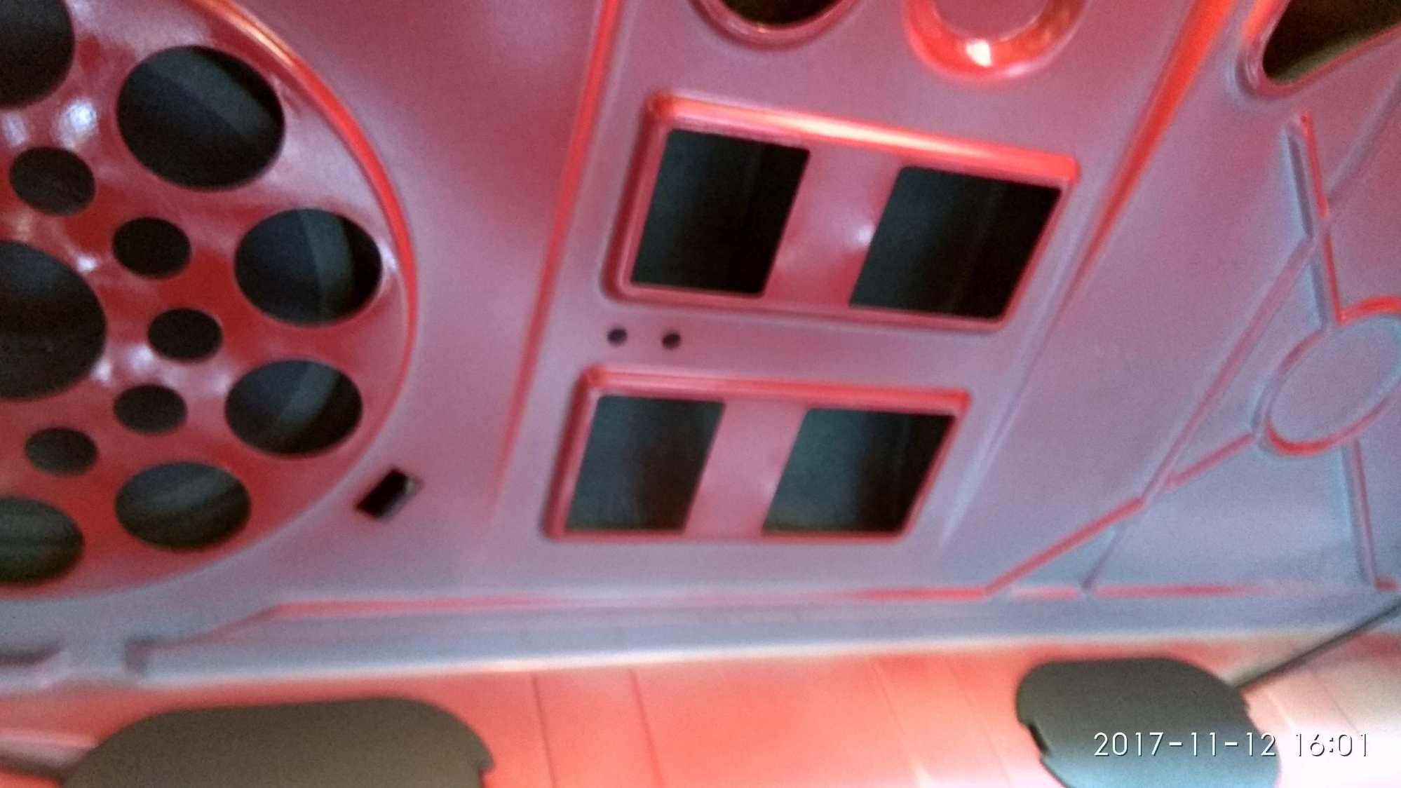

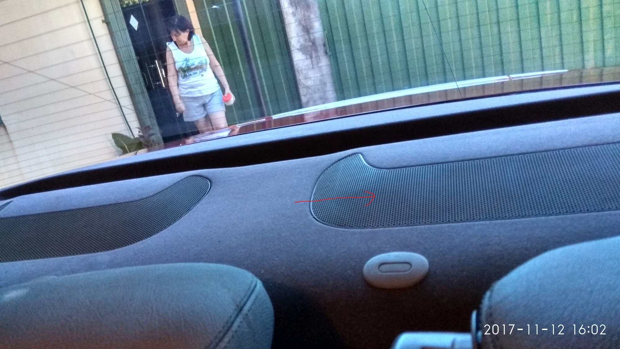

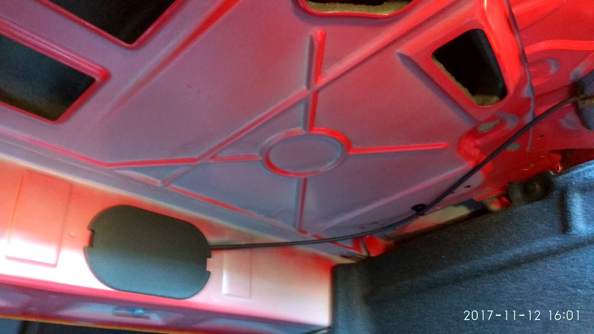

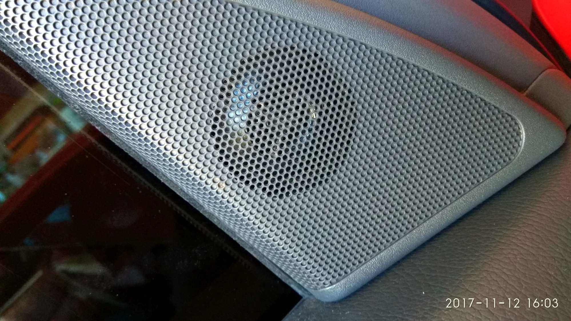

fiber optic. First of all, I ask for help to you for understand, first to disassemble the radio cm1010, if my
system has the BOSE system or not because I have counted the speakers and its are 7 in everything:
2 Tweteer at the corners above the side ventilation fins
2 Speakers in the front doors
2 Speakers in the rear doors
1 Speaker (woofer?) In the rear hatch
I did not see any Bose writing on the loudspeaker grids but the number (7) makes me doubt ... or is it wrong?

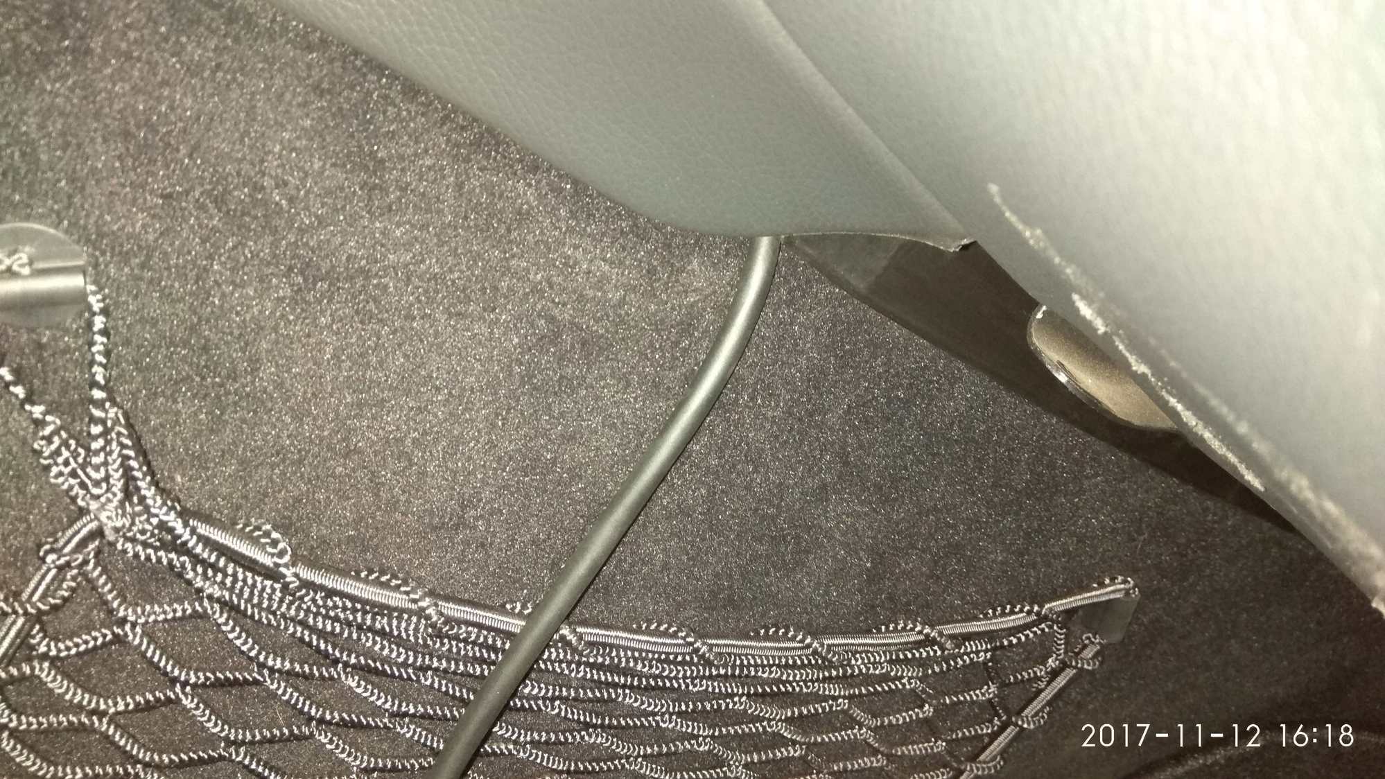

Last question ... comes out a spiral cable from under the radio dashboard on the right hand side with a strange
connector with Japanese writing but i do not understand if it is connected internally to the radio ... you know
what type of cable is it?
I try to attach some photos of both the stereo and cable and also the VIN that might be helpful to decode the type
of BOSE or not. VIN is WDB2030421F400052

Fixed,
after see other thread I do not have a bose system
