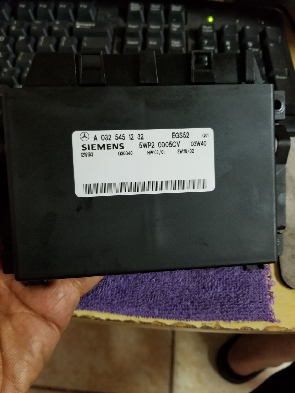

Pull of the cover to check for oil contamination but didn't detect any visible signs.
No oil contamination visible
ICarsoft CR Plus code P2500
Code P205A-008

In the Diagnose Process window, there are four items:
(1)Transmission
(2) ME-SFI-Motor electronic.
(3) ESP
(4) AB- Airbag.
Transmission gave me the P500 code and the ME-SFI gave me the P205A-008 code.
Oh, one more thing. I tried driving the car about half hour ago and this time the transmission went into neutral at 30mph while in 2nd gear. The rpm climbed to 4000 and won't cross that mark. As I backed of the gas, 2nd gear engaged then down shifted to 1st gear somewhat fierce. As I applied gas it went neutral again. I stopped the car, manually selected 1st gear and drove off, but it won't exceed 4000 rpm. Put it back in drive and went back home with it going only up to 2nd gear. Fortunately I was only 1 mile from home.
I can ask my brother to pull down the valve body and let him check the solenoids while I purchase a conductor plate. But I will have to wait until he's free this weekend.
