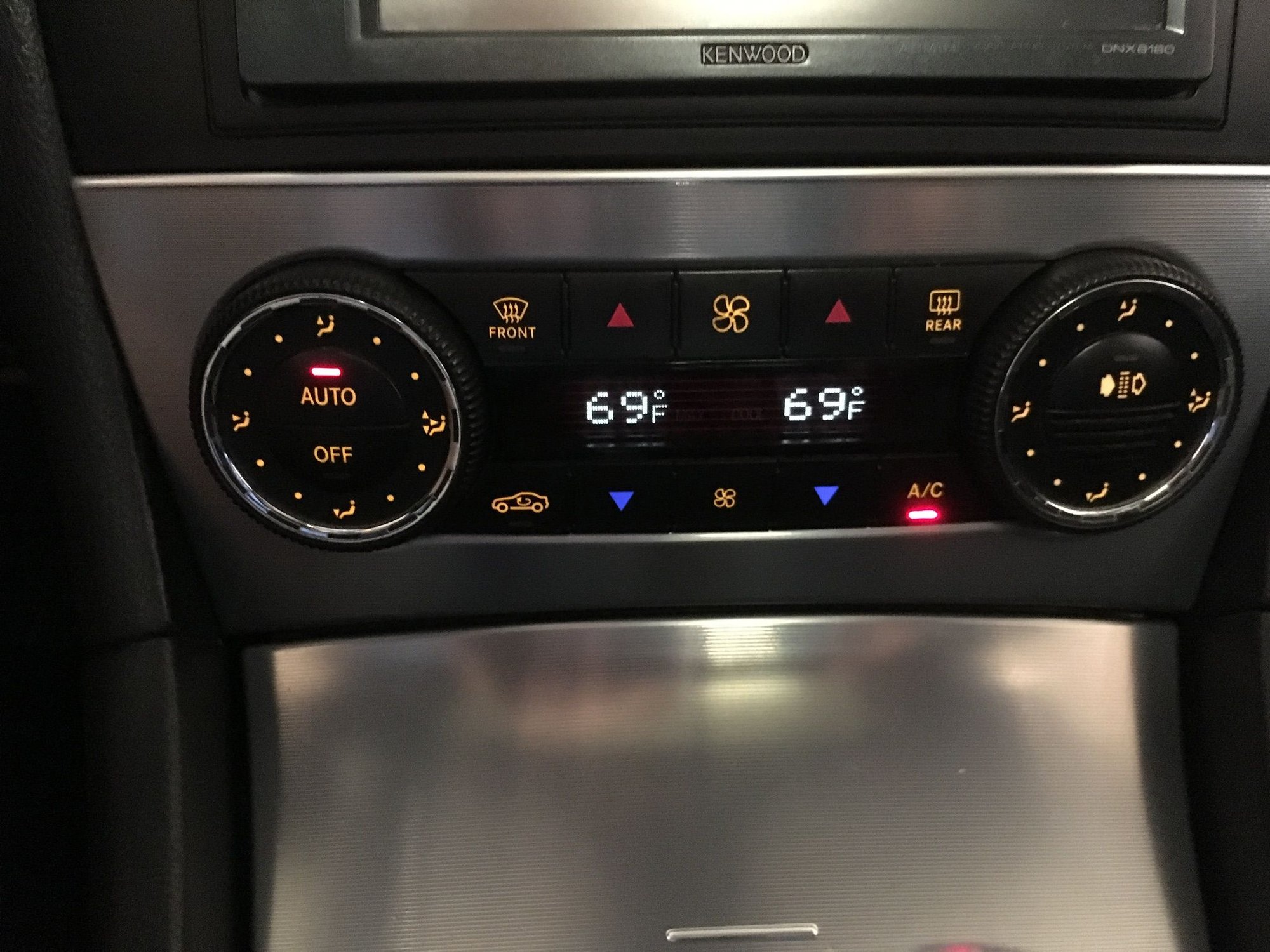

A203 830 44 85 worked fine on my 2005 C230. It looks much better than the analog control, but it doesn’t add all the functionality that you would receive in the cars that were equipped with the thermatronic units at the factory. I wonder whether there is a way to change from Celsius to Fahrenheit by holding down a combination of buttons.

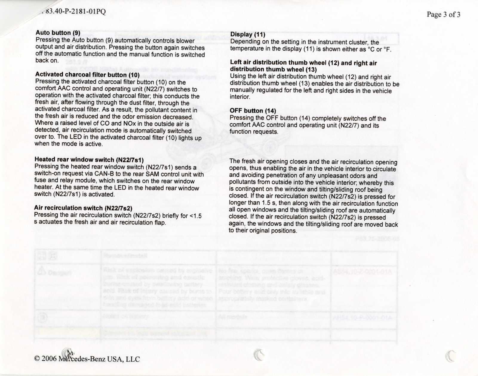

Use the steering wheel buttons...
Make the change from Celsius to Fahrenheit with the steering wheel controls in the Settings menu...
Also...Here is a little info on PART NUMBER and it's correlation to CHASSIS BUILD DATE...

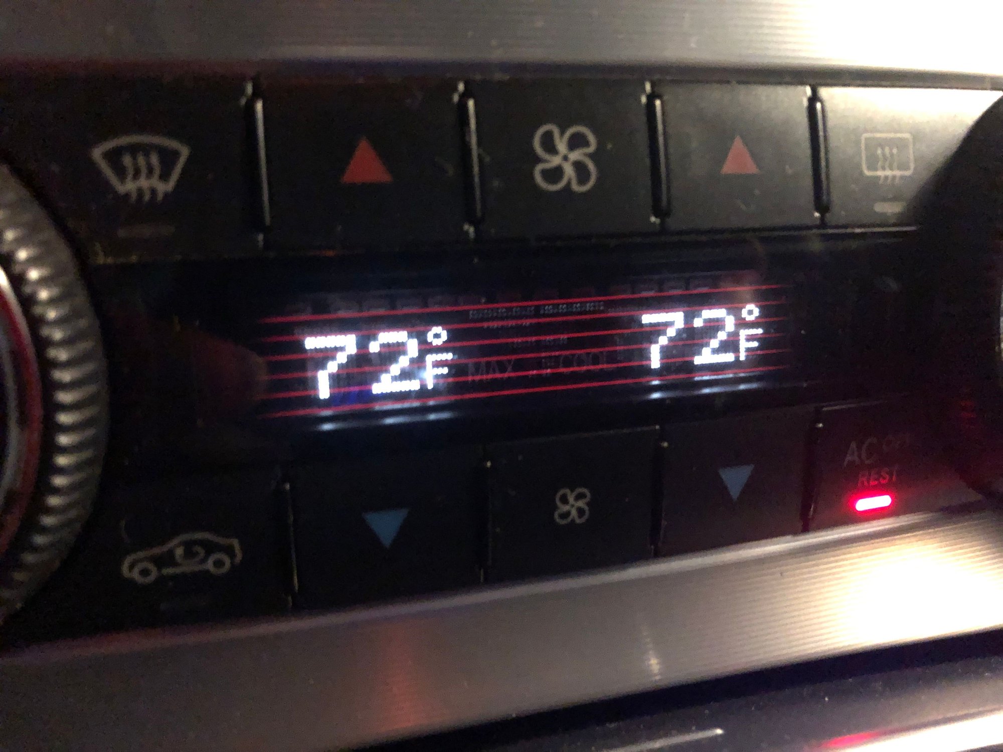

I received my climate control unit yesterday and wasted no time, installing it immediately. Mine is part no. A 203 830 43 85, coming from a 2007 W209.
As you posted, Fahrenheit and Celsius settings are informed by vehicle settings through steering wheel control buttons.
I believe most of the expected functions work-- fan control, directional control. auto (less-informed auto, since I don't have all the necessary sensors), temperature control. I am unclear as to whether the compressor control works. At least it seems like it has a mind of its own right now. So maybe my climate control unit works but doesn't fully work? When people say particular part numbers don't work with particular W203 builds, do they mean that no functions work at all?
My car was built in 5/04. As noted in the document posted above, builds up to 5/31/04 have AC button behavior where LED is off when compressor is on, while LED is on when compressor is off, because it is after all an [AC Off] button. I may need to source a A 203 830 19 85 unit.
It seems to run my AC properly for most functions. A/C REST button might not conform to my car's original AC button behavior based on build date.
On a brighter note, it seems like my car may be keyed in for REST, so that was a pleasant surprise.

I was able to change the settings using BF’s instructions. My car has a 9/04 build date. I have the same functionality as my analog controls. The thermatronic looks better, is easier to read and may be more accurate.
