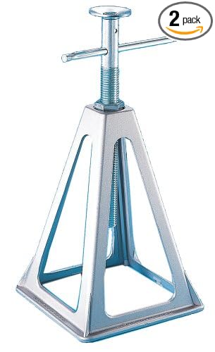

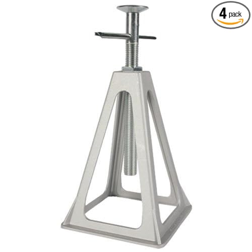

Imho, I hate those types of jack stands. Imho, they are good only for trucks/SUVs.
You want a jack stand that makes sense to use on a real life car.
I have a bunch of both of the following. Imho, someone else's life may not be worth ~$25-$50, but mine is!
Amazon Amazon
Camco 2 Pack 44561 Aluminum Camper Jack-2 Pack, 2 Pack
Price: $21.82
Amazon Amazon
Camco Olympian Aluminum Stack Jacks, Stabilize, Position And Level Your RV, Trailer Or Camper, Can Support Up to 6,000 lbs, Extends 17" - (4 Pack) (44560)
Price: $31.40

Imho, I use a composite decking as a wide and stable base, and a Camco jack stand, if the car is going to be on jack stands for any length of time.

Red, I like your suggestion to use the screw type jackstands. They’d fit the lifting points better than the cast ratchet type.

5by5, you have a concrete driveway and live in CO?
How the heck do you get away with that? CO weather is similar to New England weather. The temperature extremes and the above 32F/below32F winter temps are extremely abusive to anything concrete.
I agree that on concrete, those types of jacks are very stable, and are good.
For asphalt, they are not good. One end will begin to sink in, and so on.
My dad got me a set, when a car "didn't stay where it was, when it was jacked up".
So, those 4 jacks will stay with me for as long as I'm around. They are also a very good reminder that Safety must come first!
It's also interesting what and why, when have an emotional attachment to some objects.
