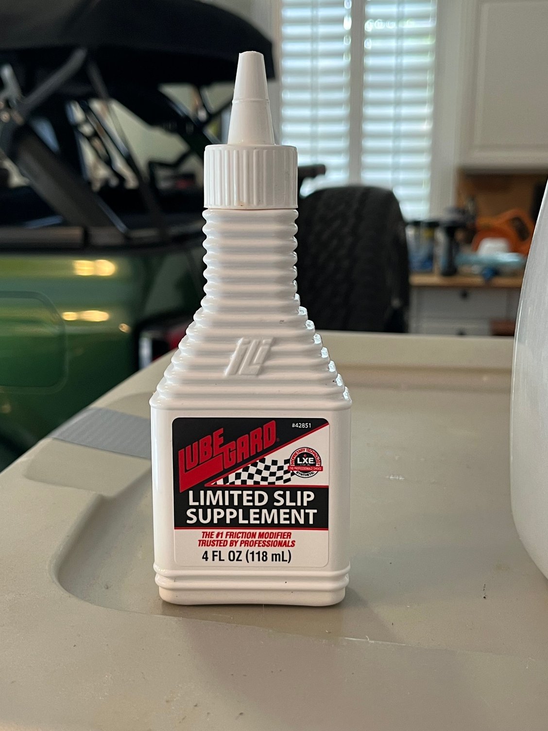

100% FIXED!!!! The Limited Slip Modifier / Additive into the transfer case was EXACTLY what it needed. I have no more noise, but more importantly, no more vibration from the slipping clutch packs. Silent as the day it was brand new. Thank God!!! This was absolutely eating away at me (I hate defeat).
The conclusion: The Mercedes Benz Gear Oil specification of 239.41 for the transfer case may be fine and dandy for when the car is new. But as they age, its limited slip properties are clearly not good enough anymore! I am surprised they have not included an additive after a certain amount of miles to be used during maintenance cycles......
Actually. I'm not surprised. Why let a $10 bottle of additive stand in the way of selling an $8,000 part (or, just buy a new car, because hey, it's got 100,000 miles, so it's probably time for a new one, right?)...
This is the one I used, but there are many Limited Slip Modifiers out there. I'm sure LiquiMoly probably has one too (they're German). But I trust this brand, have no complaints.
The bottle says drive it for 20 miles to let it mix in and set in. Do some Figure 8's and what not. I just drove it for about 10, hard. Cul-de-sac spins, slammed on the gas from dead stops and while rolling. Worked that car like it owed me money. It is now dead silent. No more humming on parking lot turns or full steering lock spins. What noise I do hear, is absolutely fat tire related as they grip/slide on the pavement in those situations.
From now on - NO more Mercedes Benz fluids for me. Will be changing the transmission fluid this summer, and will be going with the LiquiMoly fluid. MB lost my trust on their fluids after this.

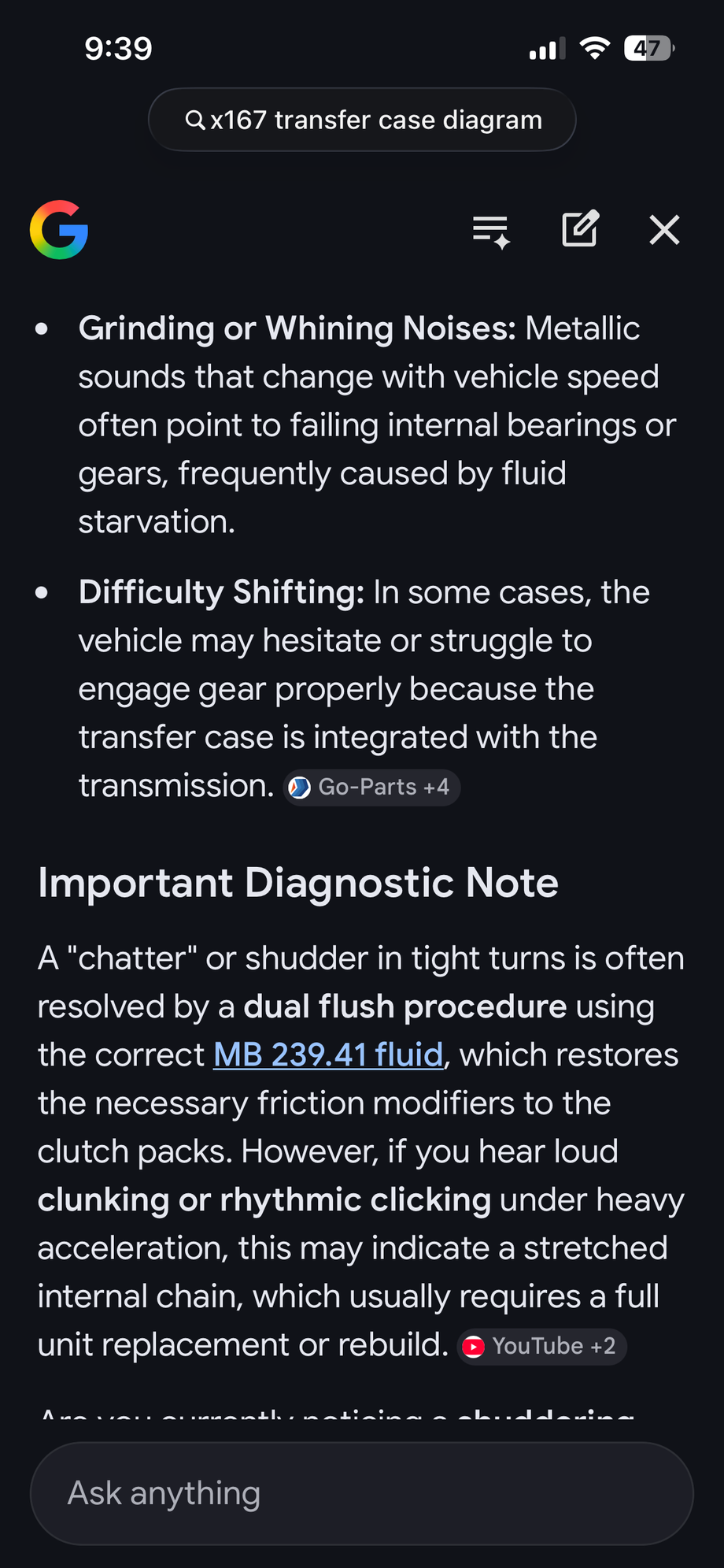

Went down the AI rabbit hole last night and found this. MB calls for a “Dual Flush” procedure on the transfer case. If you ask it what that means, you basically sacrifice the first fluid change as a cleaning agent to the clutches via a series of figure 8 driving procedures, get it hot, then change it again. This would make sense as to why a normal change procedure would not fix the issue. I had no idea about this when I did mine. Nor did my shop apparently. Someone on the other thread did mention a case where someone had issues with the Fuchs brand and switched at it went away. That would be a dual flush scenario.
So, according to MB - if you don’t succeed the first time, keep doing it until you do.
This makes sense to me now on why the Lube Gard has worked so well. It has a cleaning agent in it, which likely has cleaned off the varnish and grime from the two clutch surfaces (one for the front wheels, the other for the back), and therefore has returned a clean surface for the the clutches to grab instead of slip (droaning noise).
Going forward, I will try the dual flush next time. I may pull this current fluid out and go back to 100% MB soon too, but want the Lube Gard to have more time to clean it up.
What is interesting to me, is the old fluid with 40k on it, looked brand spankin’ new when it came out. But, was red like transmission fluid instead of honey like the 239.41 fluid. So I am thinking the Lube Gard as a cleaning agent may indeed be necessary for mine, as perhaps the wrong fluid was in there for 40k miles.
TOD (torque on demand) - reading about it, we definitely have it. This isn’t a standard limited slip, but instead has electronic actuators that push/release the two clutches as the computer anticipates slippage in either the front or rear. Makes perfect sense as to the low speed turning now with the droaning noise. It’s probably at a 50/50 split of power in that scenario to prevent a fishtail issue.
long (but interesting to me) story short - the transfer case in the X167 is just fine. No need to buy a new one. Just need to understand the procedure better to change its fluid. These cars are now entering the “tinkering” phase for ownership. Info like this will be important for the next round of owners who buy a used one and spend some time servicing it.

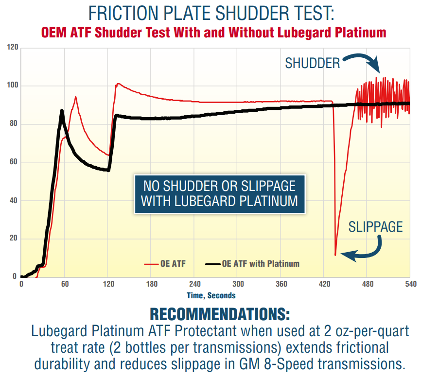

There are also similar olded threads for the torque converter in many cars that starts to cause some shudder. Lube Gard came up with a small tube additive that fixes that shudder. The way it works for the torque converter is similar to what you did for your transfer case, except that Lube Gard in that case had just a small tube that you add to the oil for the torque converter. Nice chart below (and also link) on how it works for the torque converter. Again the issue that also in the case it is often a solution for 5K miles or 10K before the physics takes over and mechanical/parts wear and tear become too much to overcome even with additives like this.
https://lubegard.com/wp-content/uplo...ll_sizes_2.pdf
These guys (lube Gard) have done soooo well, that at some point around 10 years ago companies like GM even included this solution as part of their official internal service bulletin. Again this is for the torque converter, not transfer case, but the way it works is similar to your solution. Many enthusiasts from the BMW community also used it around 10 years ago when torque converter failure was very common for some older 5 series vehicles.
If the claim to fame is ten years old, I'd treat it as Old News. It seems to be directed at GM and Ford.
Chemistry has changed so much in that time, that my first go-to would now be the most recent factory spec. I'm still reluctant to use additives that might dilute the fluid.

Wish this topic started last month when I had my fluids changed. I would have tried the lubegard for a month then changed the fluid.
