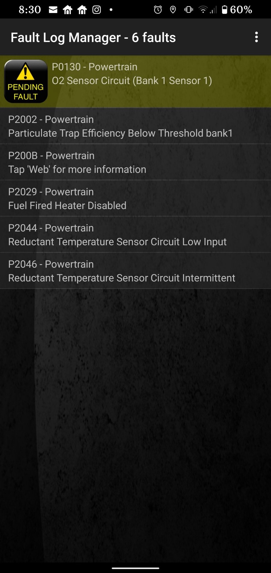

And here are the codes
do you have a diesel?????? --- except for the o2 code, those other codes pertain to a diesel
If you have a catalytic converter right off the manifold I would take that off and see if its clogged.. possibly a front o2 sensor as well.
Interesting as It is not a diesel
