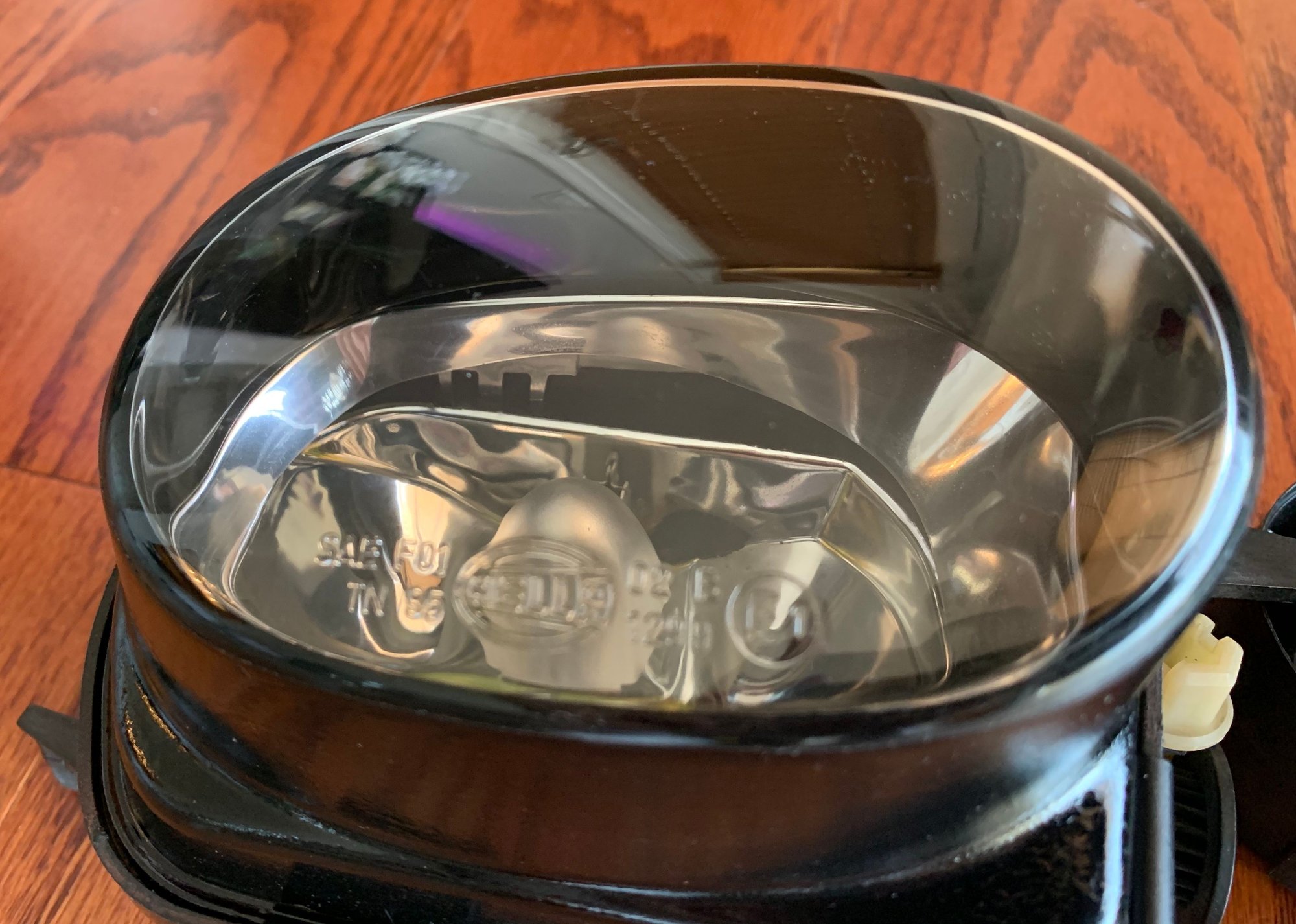

Here is the sorry state my fog lenses were in when I started, after hand-washing them:
Original Fog Lens condition, after removing from the housing, held by 3 clips.

Next, start by dry sanding the glass with the 40 grit with the drill until you can no longer see any of the pitting. If your lenses are severely pitted, you may not be able to sand down deep enough to eliminate all of the pits without cracking your lens. Use common sense and if you see your glass getting too thin, stop sanding and move on to the next grit. Since we are DRY sanding, you MUST MUST MUST be careful not to heat up the glass too much. I was only able to sand for about 5-10 seconds at a time in one area of the lens before it got too hot and I had to stop to let it cool down for 2-3 minutes. I can't emphasize this enough, dry sanding generates a lot of heat so you MUST take your time!!!
Here is what my lenses looked like after about 1 hour of dry sanding with the 40 grit and a little 80 grit (I got all the pitting out except for 1 or 2 pit which were just too deep, but it's too small to really see anyway
After using 40 & 80 grit sandpaper.
The 40 grit will take the longest because you have to keep going until you've corrected the pitted surface to a smoother surface. Next I did 80 grit for about 10 mins:
I kept going, using the edge of the sanding pad to sand down trouble spots until I had removed each preceding grit's sanding marks with the next finer grit. Since you'll be looking at semi-circular sanding marks, I rotated the lens 90 degrees each time I switched grits so I could make sure I saw nothing but the latest grit's sanding marks before I moved to the next grit. Periodically wipe down the lens with a damp microfiber to check your progress. Glass is very hard so it'll take 6-10 times more sanding time than plastic would. I had planned on going up to 2000 grit, but after 600 grit, the sandpaper just fell apart, it couldn't sand the glass any more. Doesn't matter anyway, the cerium oxide took care of the rest!!
