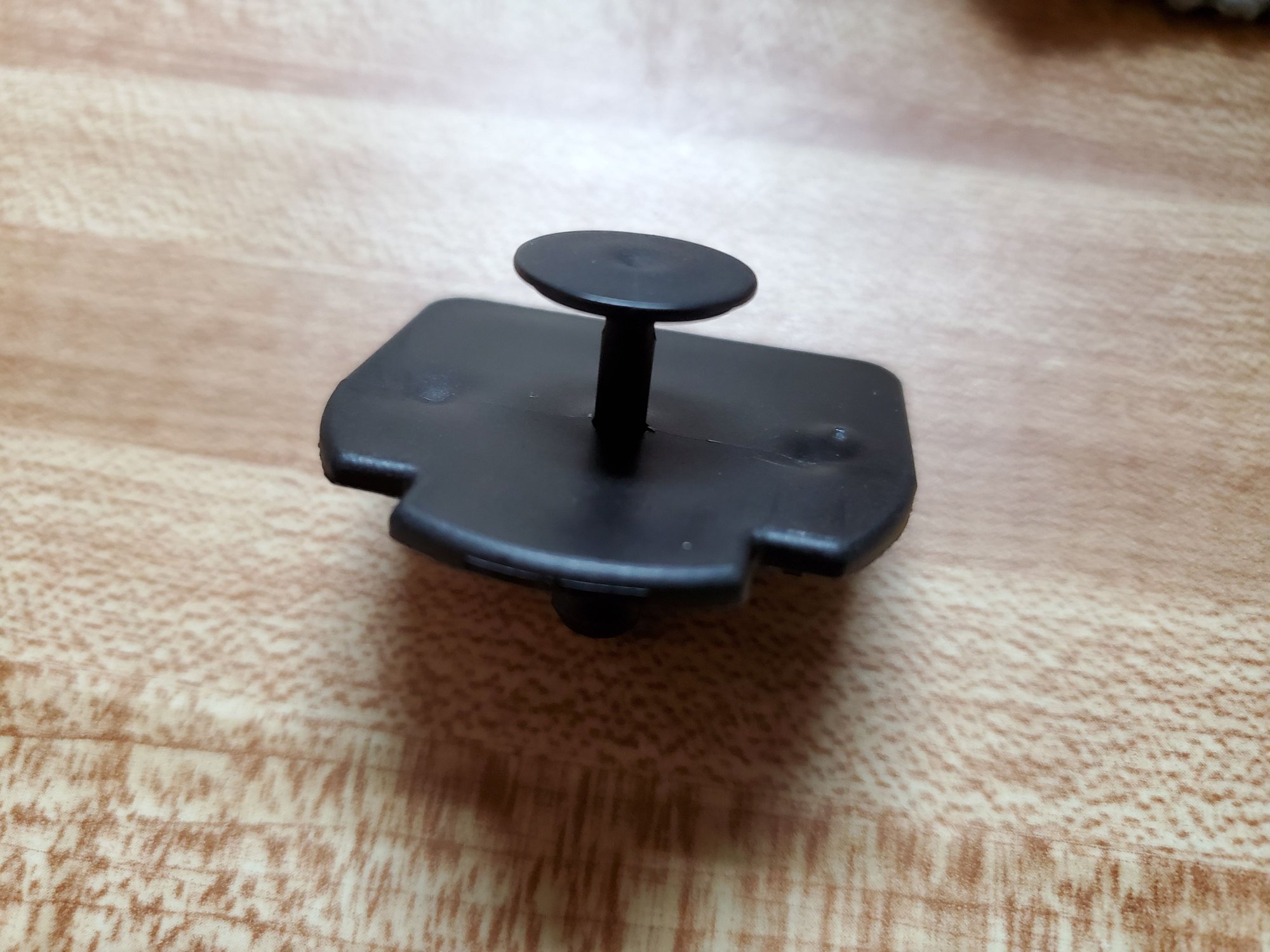

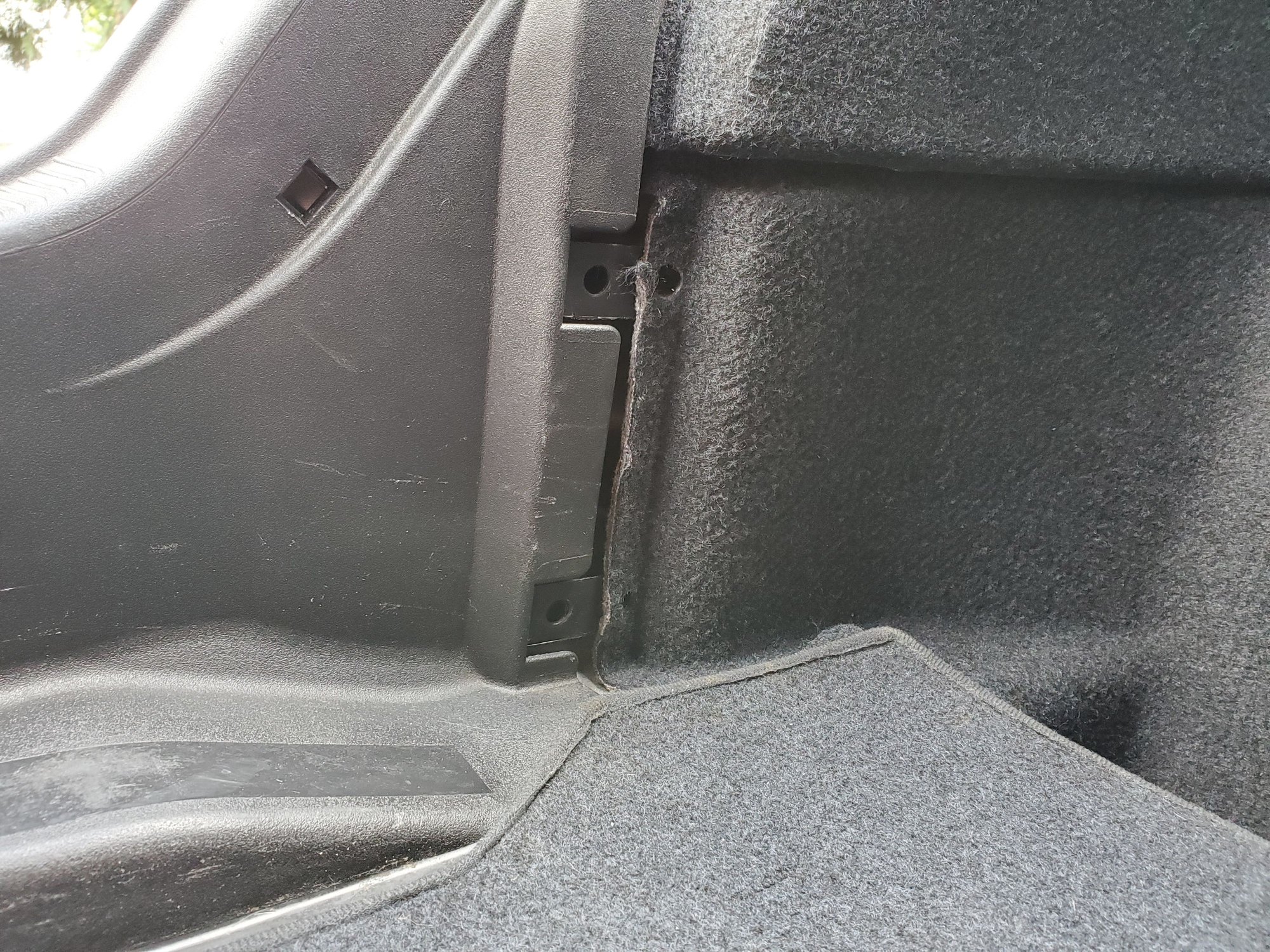

I am looking for the push pins, which secure the trunk liner in place. 2 on each side, right and left of the trunk opening vertical on top of each other.
Called the dealer and got the following part number which I ordered:
A 203 990 00 92

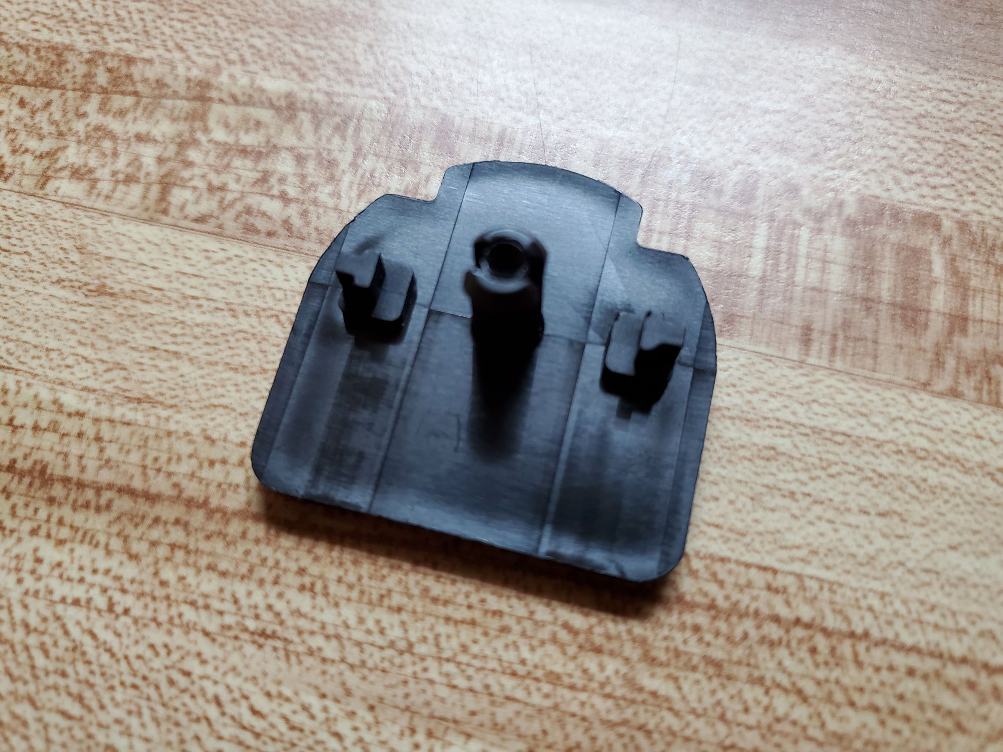

The part does unfortunately not fit, or I am too stupid to figure out how to attach it.
Can anyone pop one out and show me a picture of what it should look like, I would greatly appreciate it.
Thanks very much in advance.

Unless there was a change between 2004 and 2005, you aren’t stupid. The dealer sold you the wrong fastener. The correct fastener is round with a center plug that you pull up to loosen and press in to tighten.
Check at about the 3-minute point of this video to see the fasteners and the removal process:
There is a good close up of a fastener at the 4 minute point.

PERFECT, thank you very much.
YUP, definitely the wrong part. Guess I shall go back and exchange for the correct one.
Again, MANY THANKS KevinH2000
