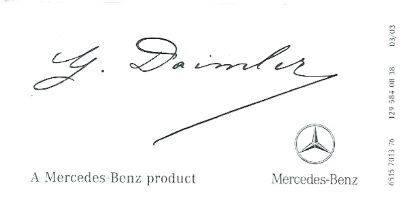

The attached image is the sticker that came on the windshield of my '05 C320 Sports Coupe.
Attached Thumbnails Windshield w/ rain sensor-window-sticker.jpg
