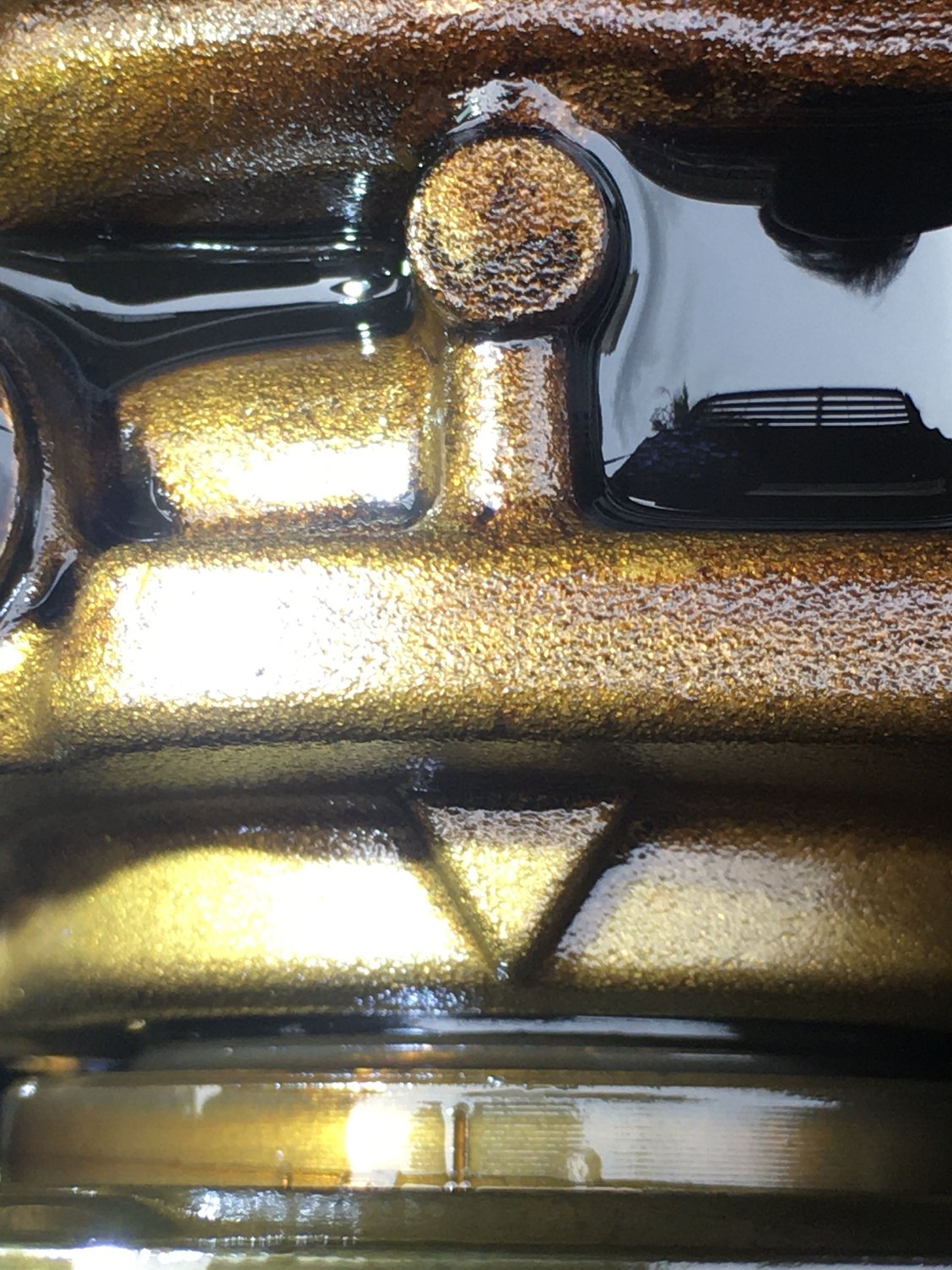

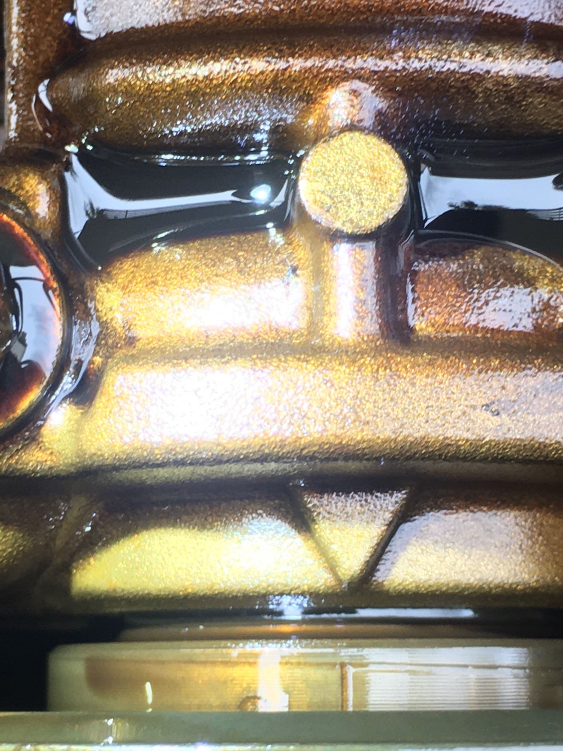

Can someone offer they’re opinion on the chain? 1st pic is the exhaust side and second pic is the intake side. This is a 2005 c230k with just over 100k miles. Does it look stretched enough that it needs to be replaced?

Check the slack between the intake and exhaust sprockets. If the chain is loose (ie it can be lifted off the guide), it needs to be replaced.
The sprockets have a computer controlled internal adjustment (won't explain here) that shifts the timing as needed. Therefore the marks will be slightly off most of the time.

the chain is tight and the sprockets are in good condition. Appears to be normal wear. I do however get the slight noise at cold start that goes away in about 2 seconds. Reading through the forums, everyone is like, you must replace the chain immediately...

To check properly you need to line up the timing on the exhaust cam.. then send a pic of where the crank position is.

At tdc, these are the timing marks. Exhaust is slightly off and intake is spot on. The camshaft locking tool fits on correctly like this. Rotating to align the exhaust cam, brings the crankshaft dampener to about 10 degrees. Is that enough to warrant replacing the chain?

If you are sure the chain is showing 10 degrees of stretch, then it would be worth it to replace the chain. I was told by my indie that ~7 degrees is when it's time to do the job.
Just looked back at my photos. Looks like my indie also measured the chain stretch by lining up the mark on the exhaust cam, then taking the reading off the crankshaft pulley.
Couldn't tell you why your chain is so stretched based on your maintenance and driving style. Wondering if it may also be caused by either a bad batch or a bad supplier. When I had mine inspected at some 180k km, I only had ~4 degrees of stretch. I too also drive my car moderately aggressively, with the occasional Italian tuneup.
