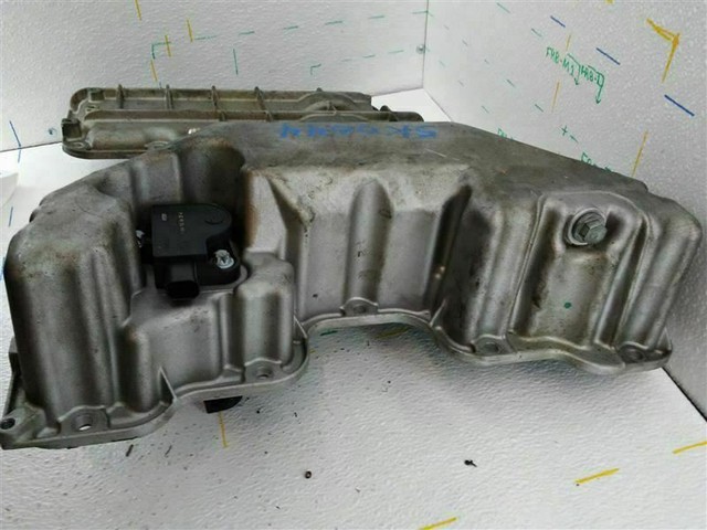

Take a look at this oil pan https://i.ebayimg.com/images/g/z0QAA...TCW/s-l640.jpg You can see the drain plug in the top right.
It is farther back then you think near the cats if memory serves me right.
