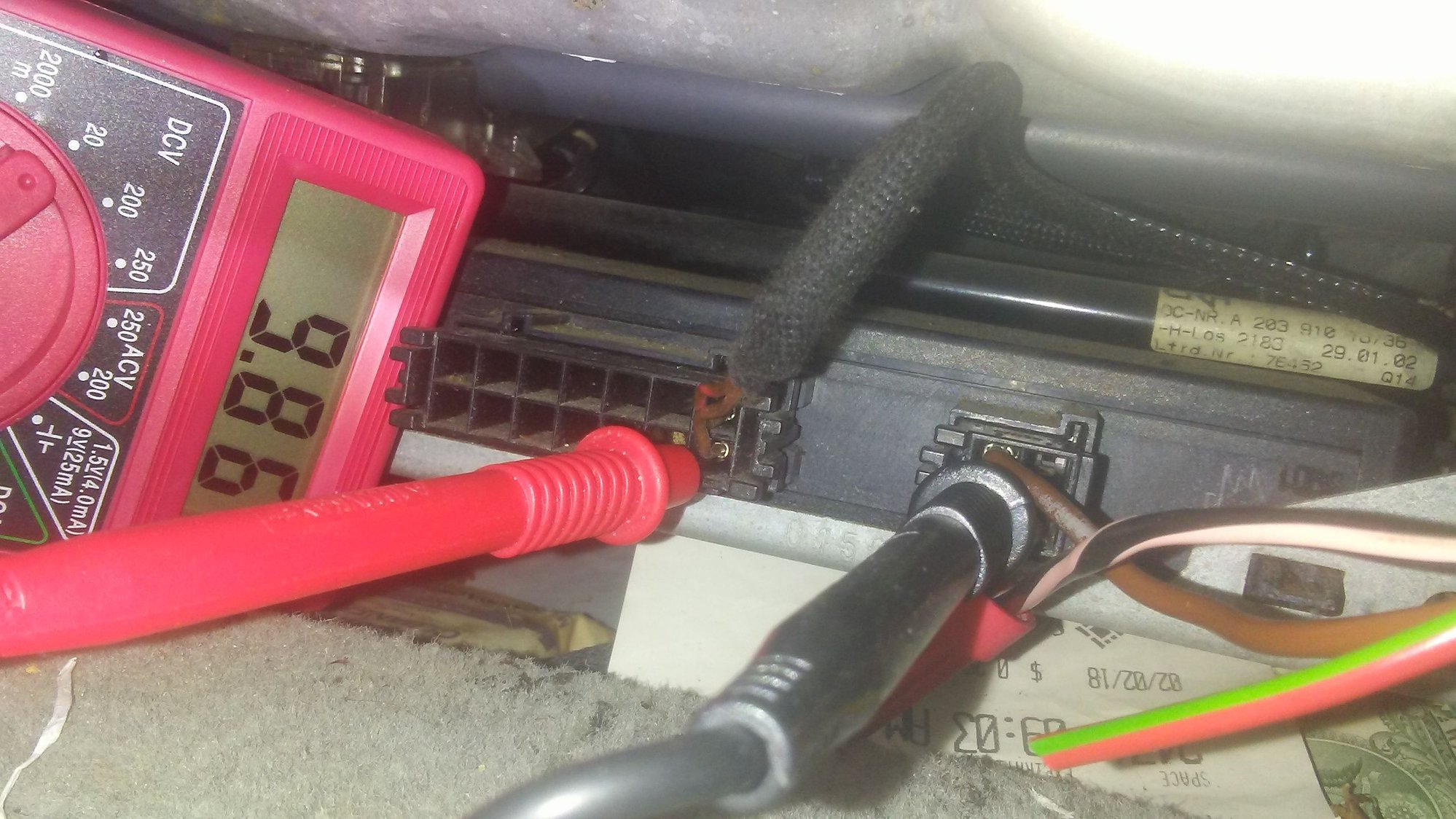

So after the seat mod we still have an unknown draw. So poking around under the seat i put the voltmeter on the brown wire in the adjacent plug and found it to have 9.88 volts when the key is off and out. Maybe this is the draw? Anyone with an idea? Thanks

Why are you taking voltage measurements looking for a current draw? Connect amp meter and Start disconnecting units if the drain is very high like over 5 amps. Start at alternator.. split the supply to fuse box to narrow the path down. Easy job! 30min you should know what the cause is

We disconnected the alternator. We have taken all relays and fuses out as i posted earlier. Yesterday i posted that there is a plug adjacent to the one i did the seat mod on that has a brown wire and a brown/blue wire in it. The brown wire on this plug has 9.88 volts on it with the key off and out unless i pull fuse #2 in the rear box.. My inquiry was does anyone know if this could be the draw and why does it have an odd voltage. Thanks
