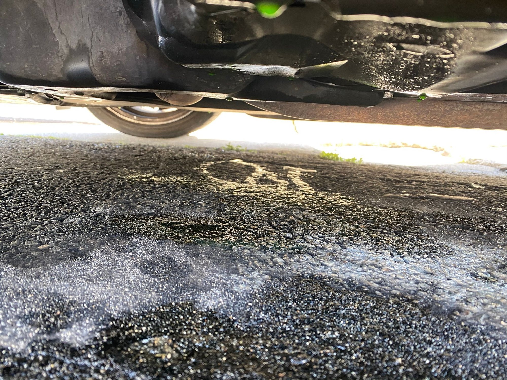

Hey every1, this my 1st post. I have a 04 c320 I just purchased, and it has developed a leaking issue on the drive and passenger side. I don’t know much about this car, so i need help.

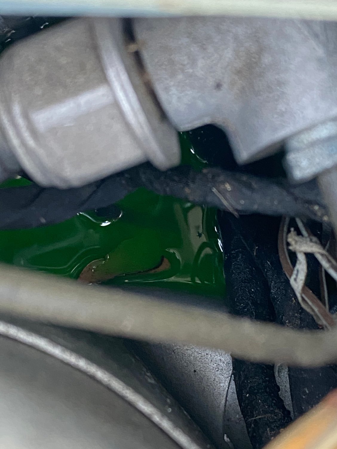

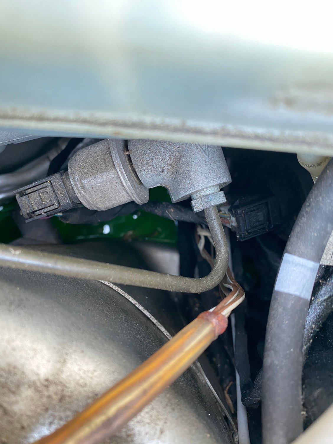

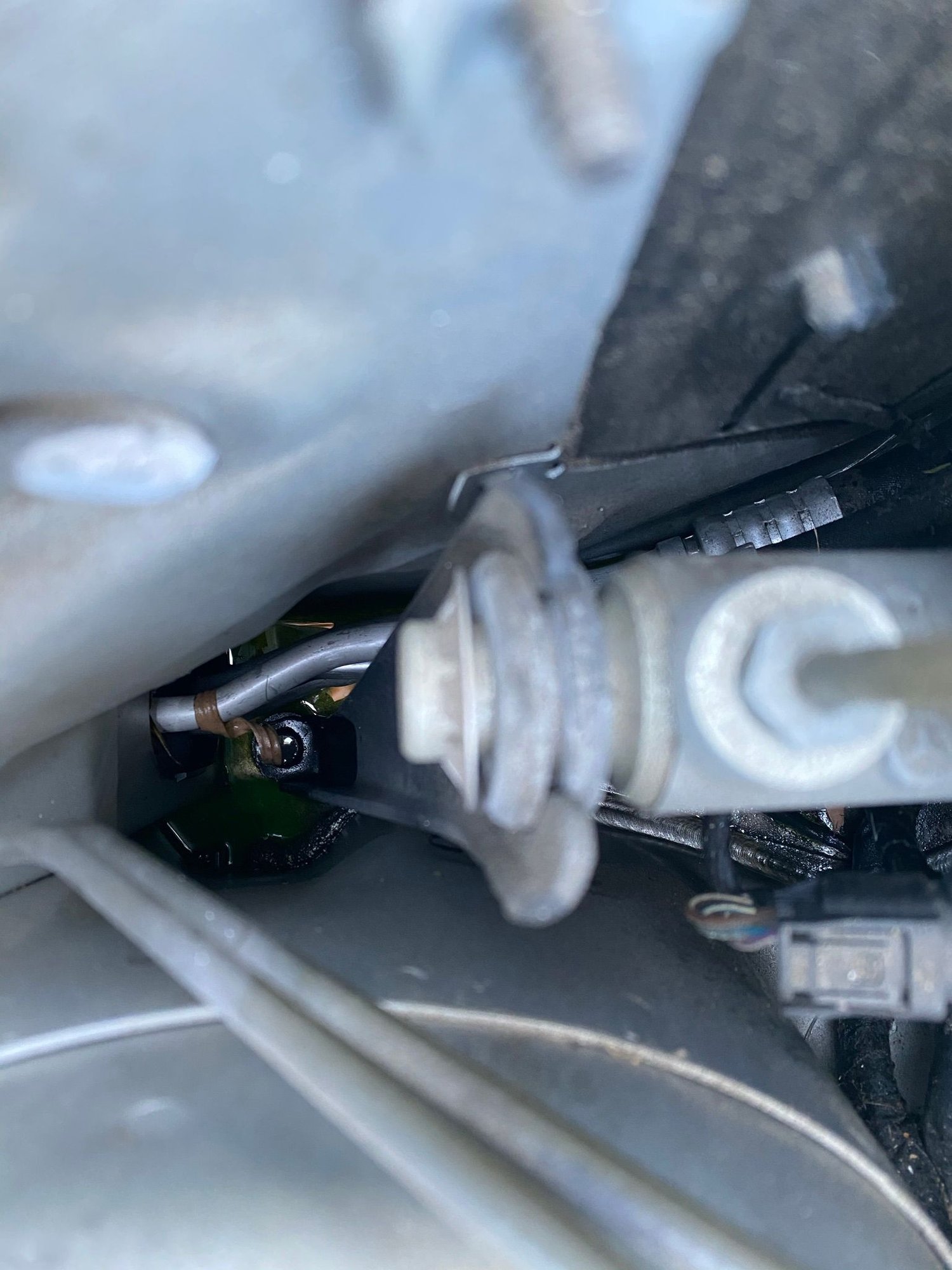

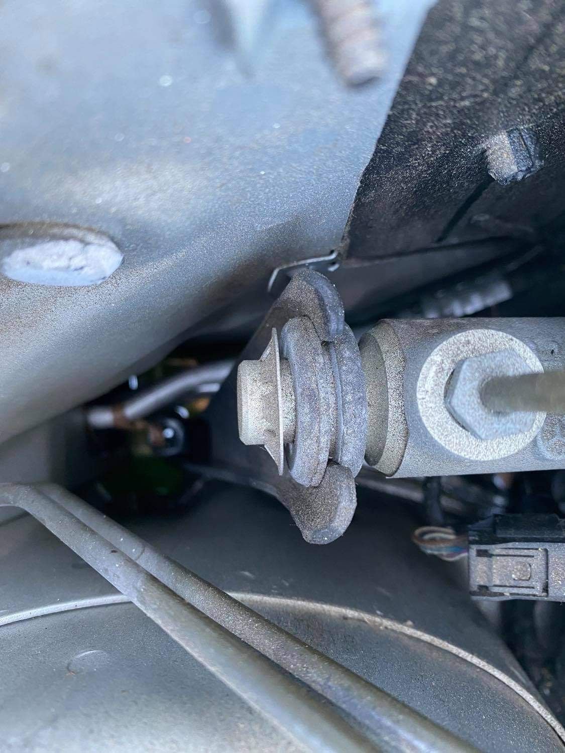

these are pics under the brake reservoir on the driver side by the fuse panel
Old Mar 20, 2021 | 07:12 AM
slammer111's Avatar
Joined: Dec 2003
Posts: 3,275
Likes: 236
From: BC, Canada
2003 C230K Coupe Orion Blue
That doesn't look like factory coolant. Wrong colour. Is the coolant level dropping in the expansion tank?
If it's not the coolant, it would be brake fluid, but that also doesn't look like the correct colour.

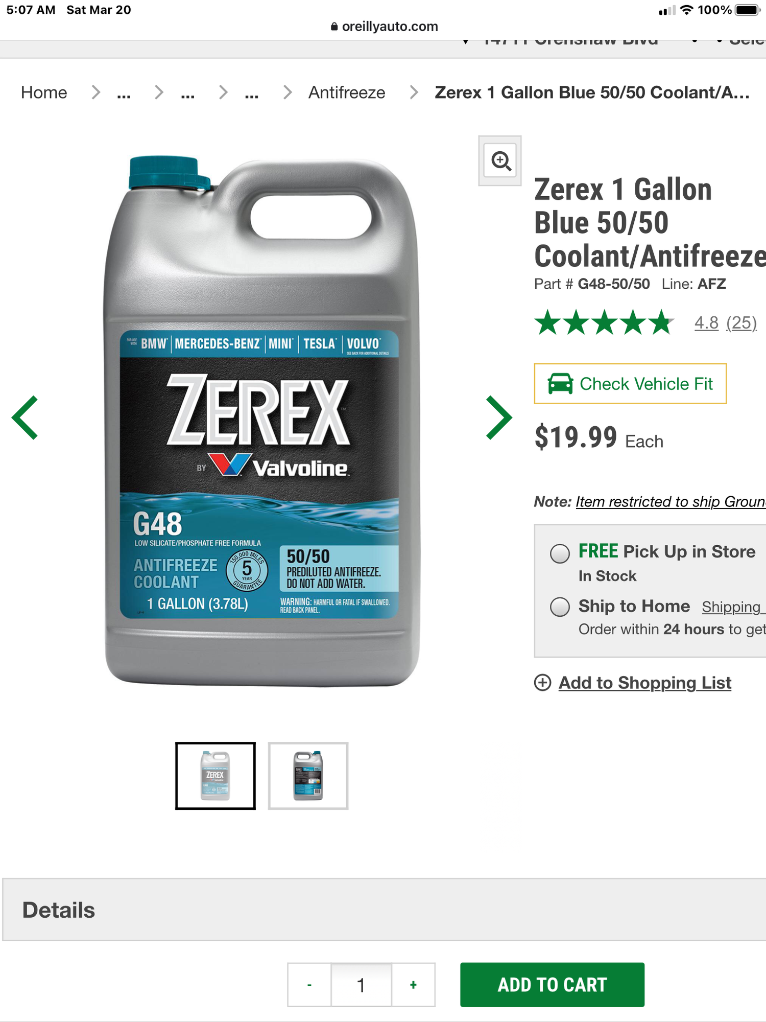

this is the coolant i currently use in my Saab, and it looks like it’s the same. my car is a 04 c320.
Old Mar 20, 2021 | 08:36 AM
slammer111's Avatar
Joined: Dec 2003
Posts: 3,275
Likes: 236
From: BC, Canada
Yes Zerex G48 will work on these cars. Notice it says MB Approval 325.0. There might be other brands that will work, but Zerex G48 is the most common aftermarket product off the top of my head. Zerex G05 will also work, though that is under an older superseded standard.
I'm just wondering why the puddles look green in your photos.
