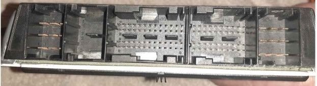

The connector pins look clean enough:

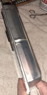

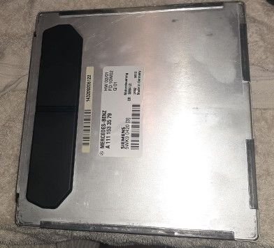

And because the damn thing looks like this, nothing is rattling inside, and I have no clue how to open it, I decided to put it right back.
