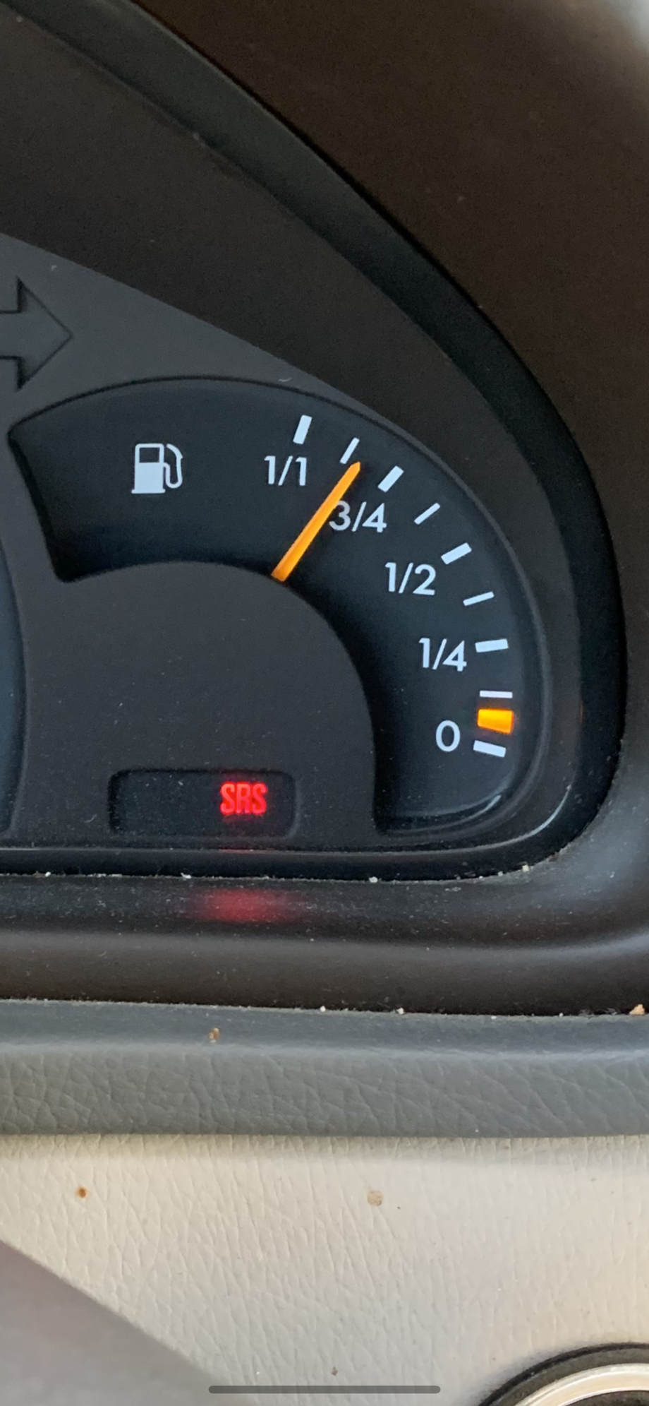

slammer my dad sent me this pic showing the tank almost full but now the orange light on fuel meter is on? Could fuel sender sided on driver side need to be replaced too? Thanks
Reason for orange light coming on after replacing fuel pump and fuel pump relay still cranks no start no fuel coming from shrader valve. Car did start right up after replacing fuel pump relay for 5 min approx before engine shutting off.

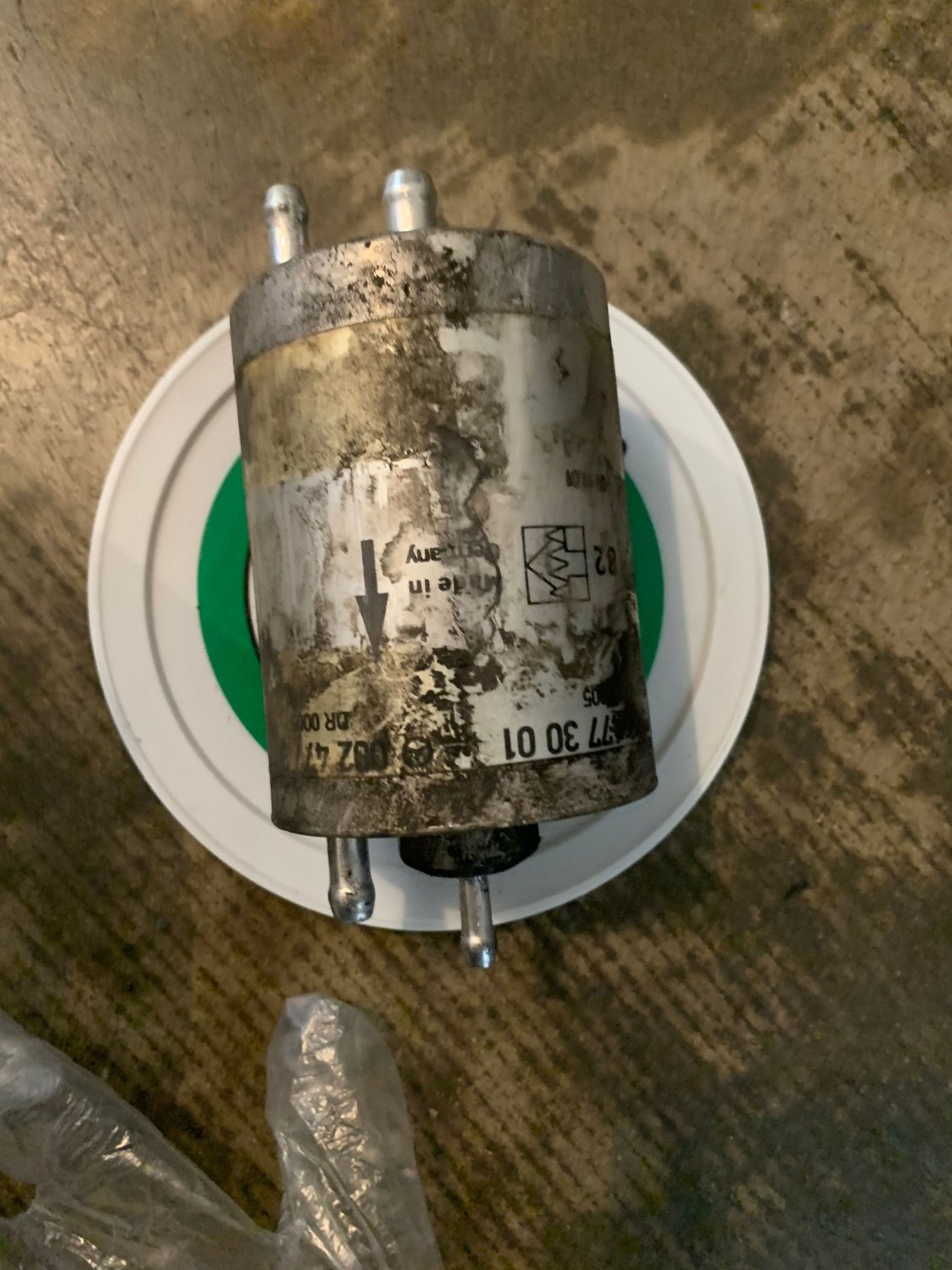

slammer check it out the original filter which is probably 19 years old never replaced my father said.
most came out really thick like slush mud sandy .
