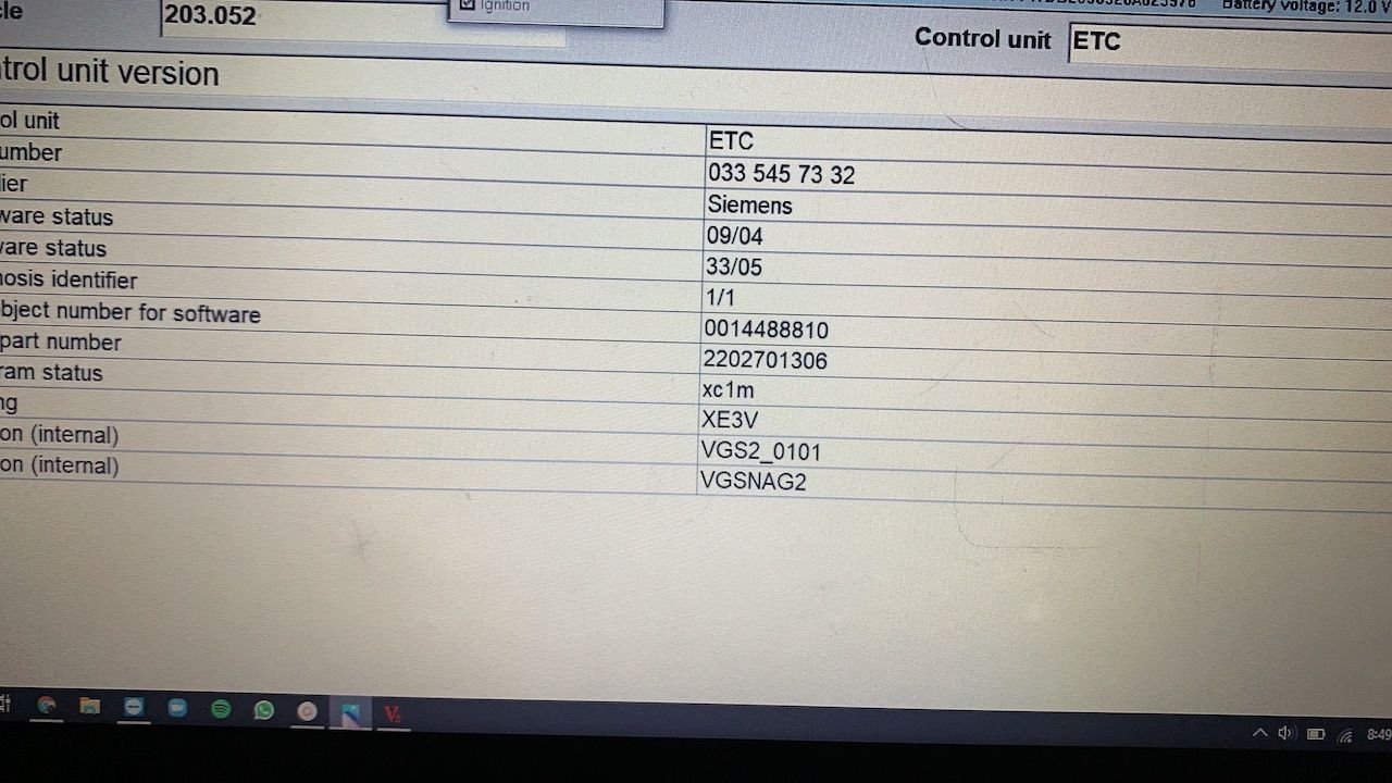

Can anyone help me to find initial data for my car? I have strange issue with my EHS number. My initial EHS number is 220701306 (physical number also the same). yesterday when I check the version using Star Diagnosis, EHS number changed to 220701206. How is that even possible?
What is exactly my correct EHS number based on my VIN #MHL2030525J042044
I plan to replace the valve body. how to find compatible list of EHS number with my VIN?

EHS is your valve body. Were you messing in development data? Just change it back to 1306 if that is what is printed on the EHS.
Why do you want to change it? Just order from vin via MB and you will get the right one. But you will have to scn online. New vgs has no data or coding

I didnt do anything with developing data actually. I am thinking to get EHS and TCM as MB price roughly $300l
