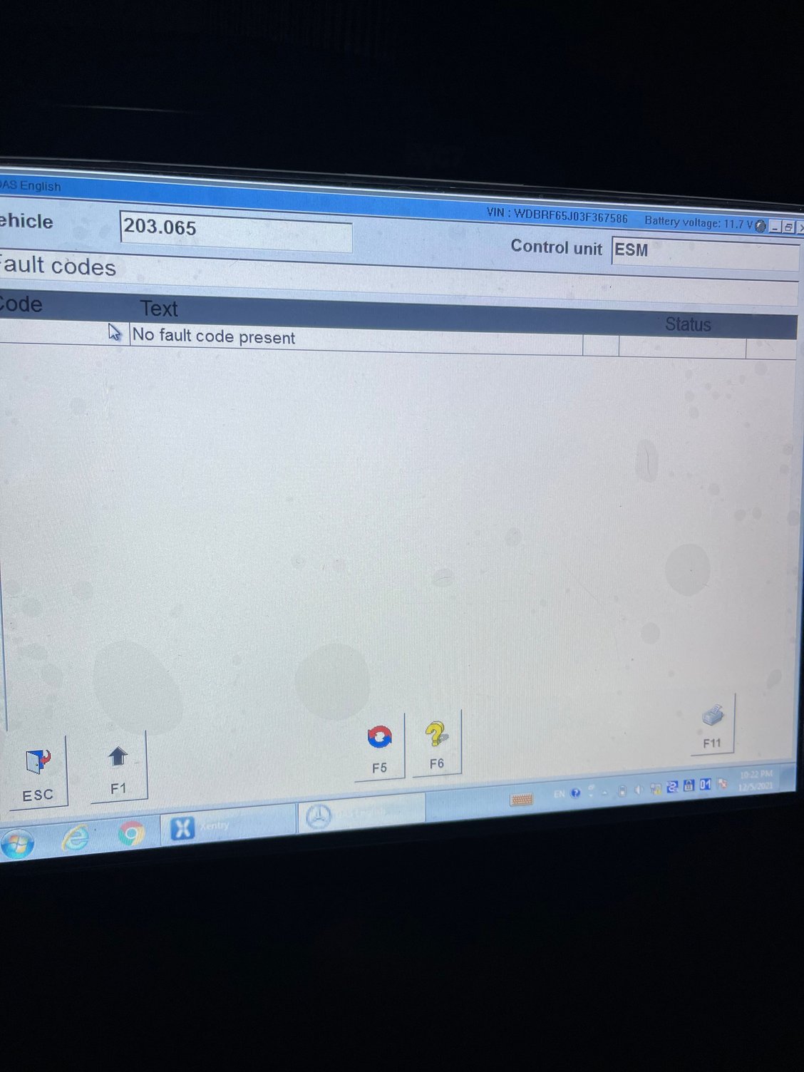

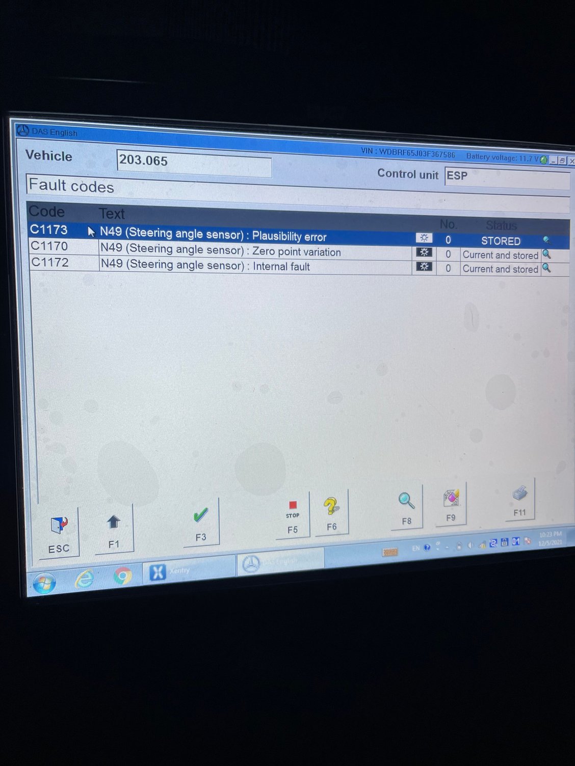

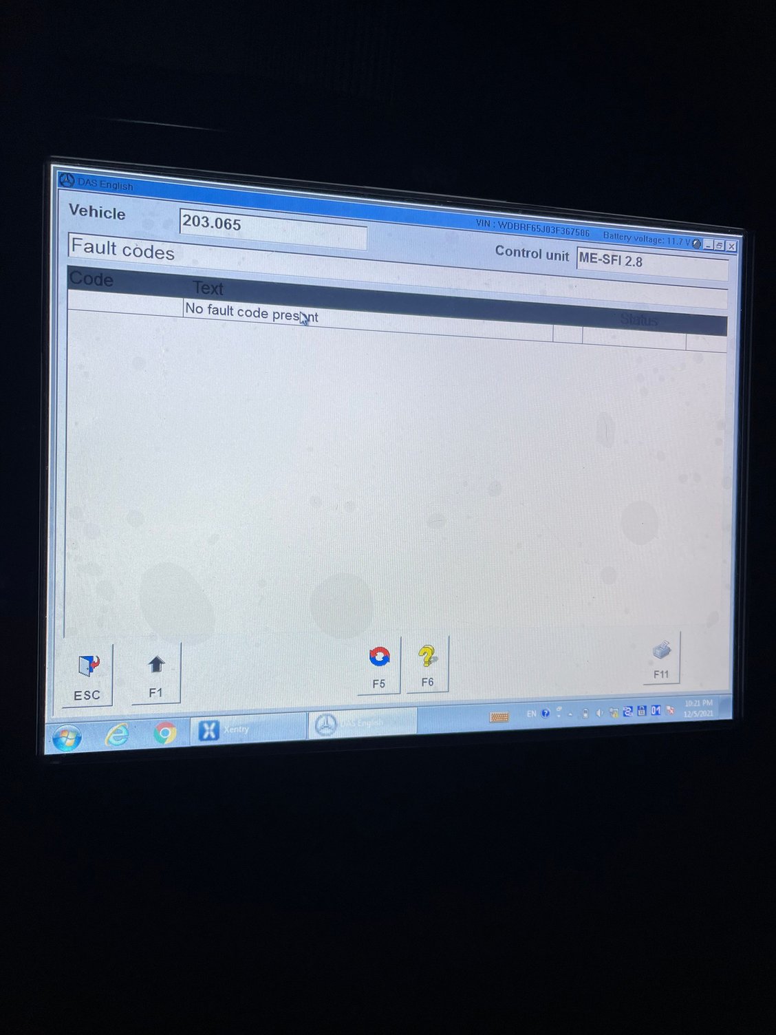

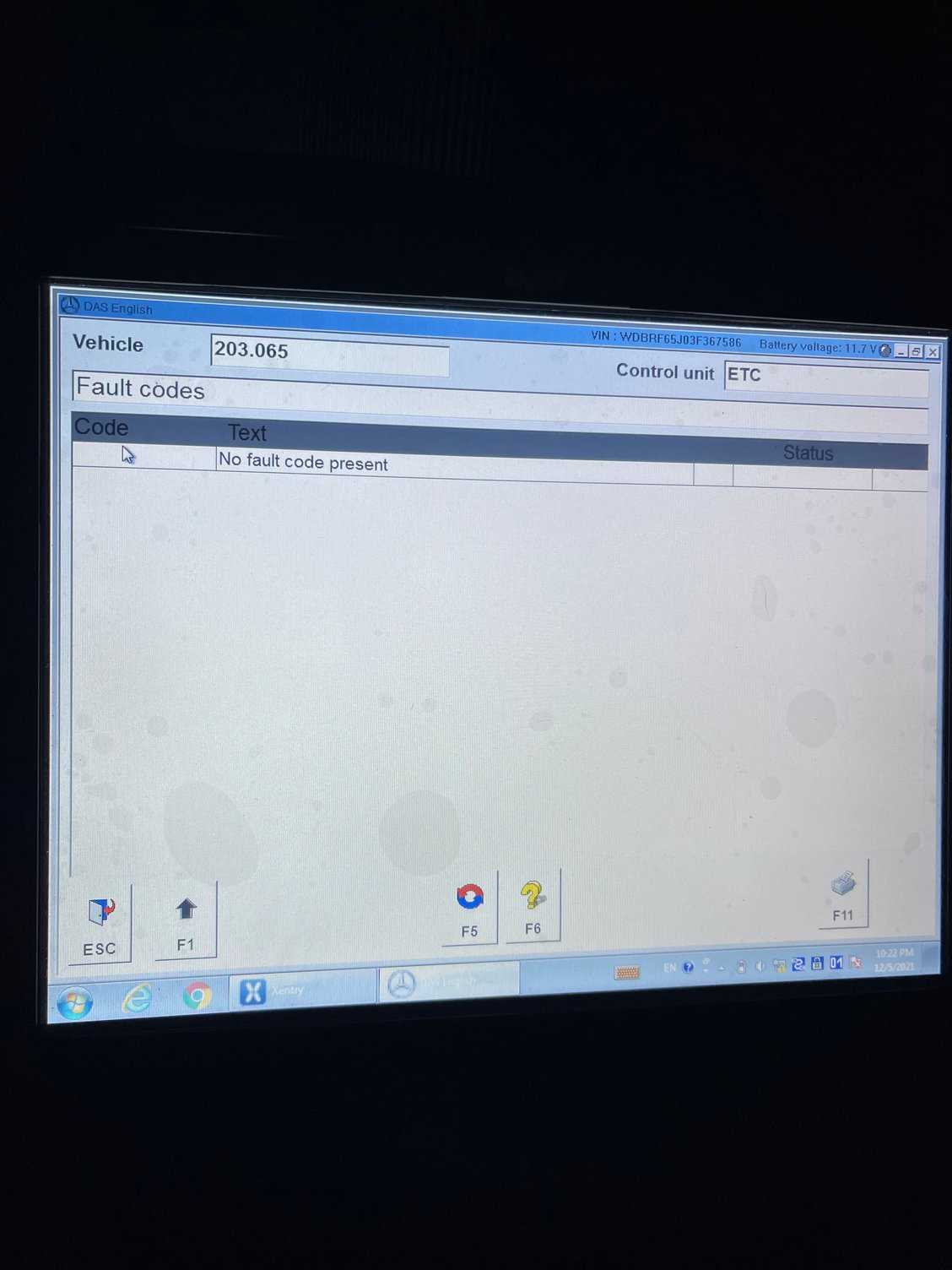

03 c32 idles at 1k won’t go past 1.2k
I have an 03 c32 I installed a smaller pulley, 550cc injectors, downpipes and headers. After flashing the car and turning on it died after 5 seconds and continued to do so everytime I tried. I plugged in scanner and through das gave me code (p2007). I cleared it and the car ran fine until I tried giving it gas to which it just revés to 1.2rpm and bogged no throttle response. I have new coil packs wires and spark plugs all oem

P2007 is intake manifold actuator, bank 2. Did you physically check to see if the throttle bodies are working? 2 person job obviously. The throttle body is what ultimately controls the revs. Is there a loose electrical connector to the throttle body?
If all else fails, as others have mentioned, flash the car back to stock and see if the problems go away.
