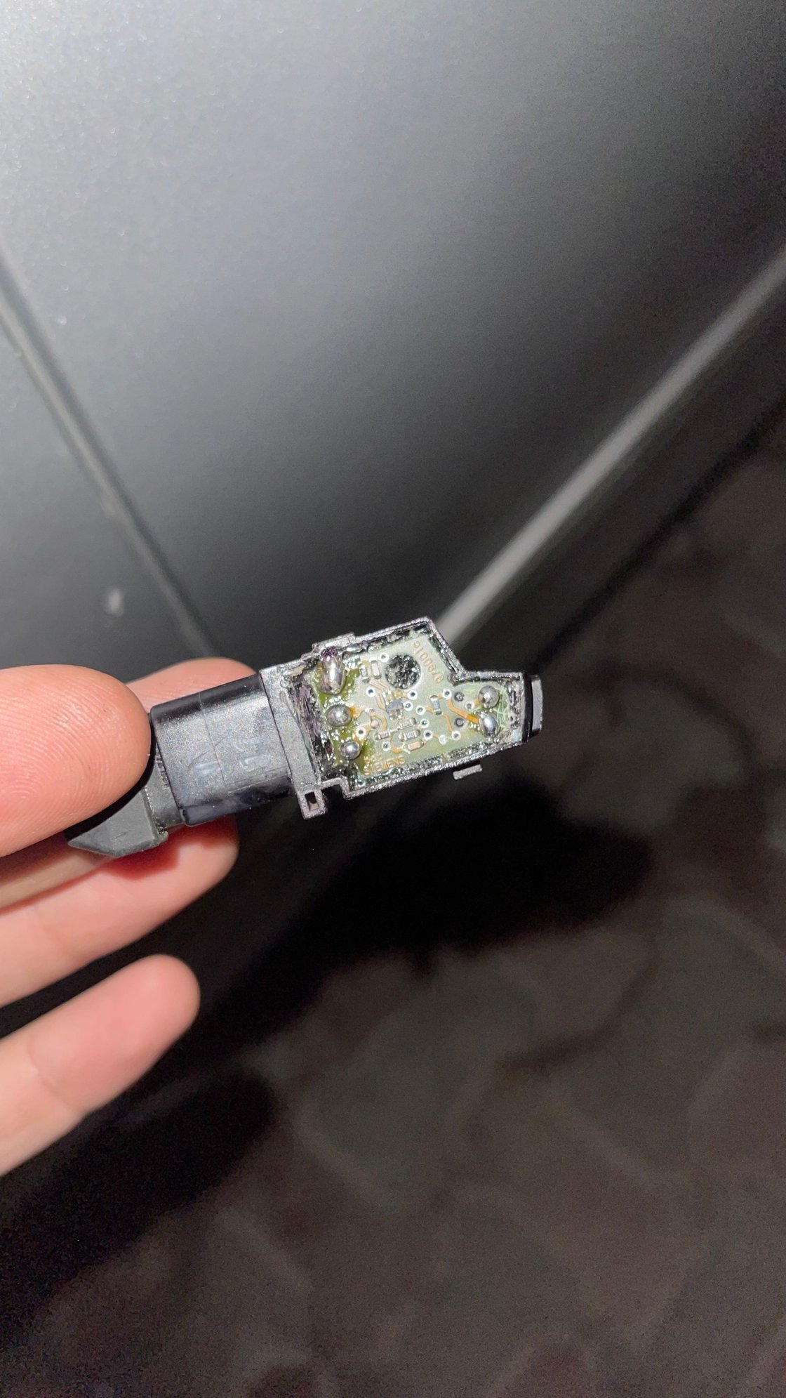

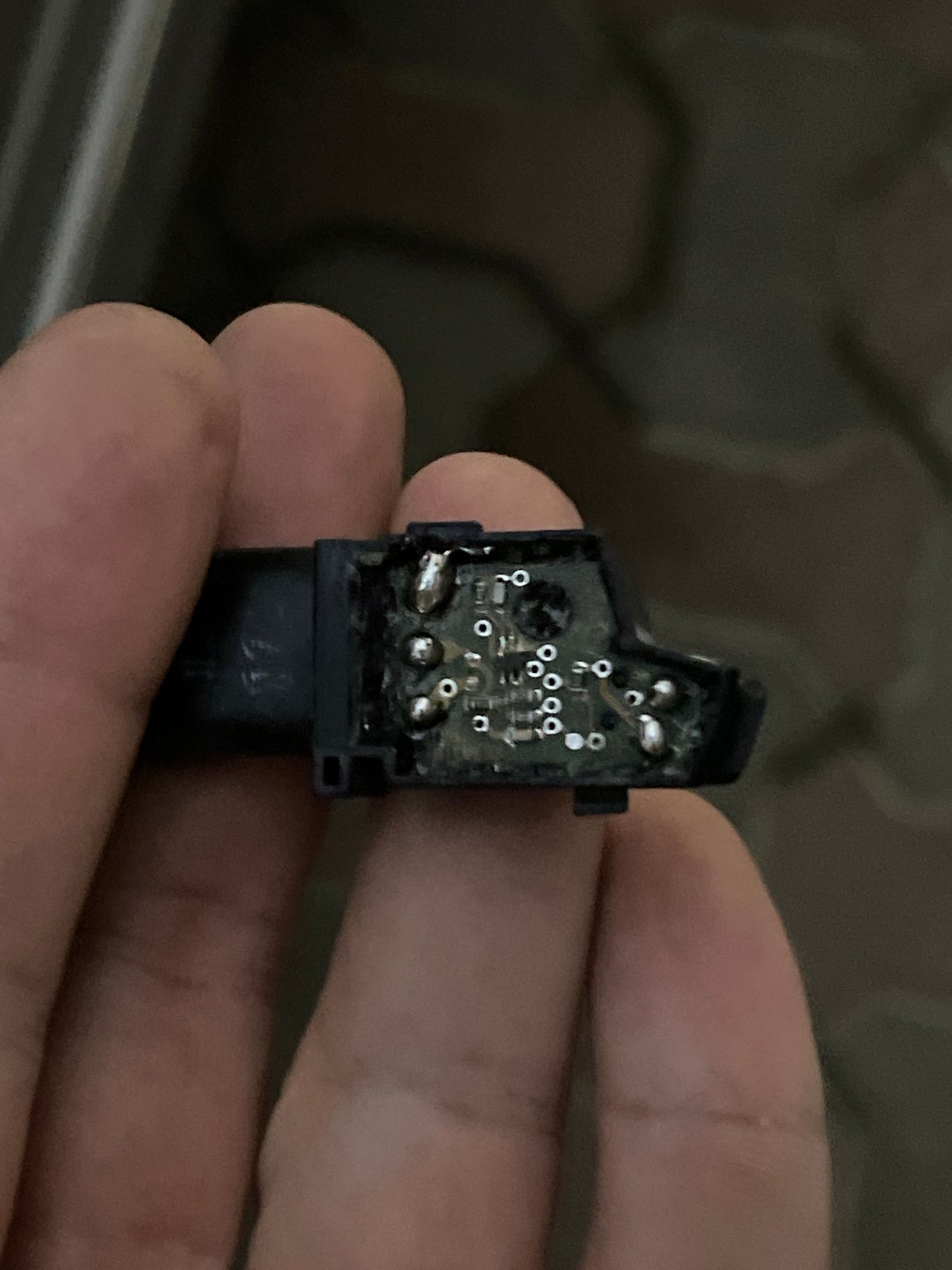

The door IR sensor is a separate problem. Talking about the ones in the door handles. They are known to go bad (cold joints in the solder). Those can be either replaced or the solder reflowed if you have access to soldering equipment. See post. It's not terribly difficult. I fixed the problem for both sides.

got it and has been fixed!
