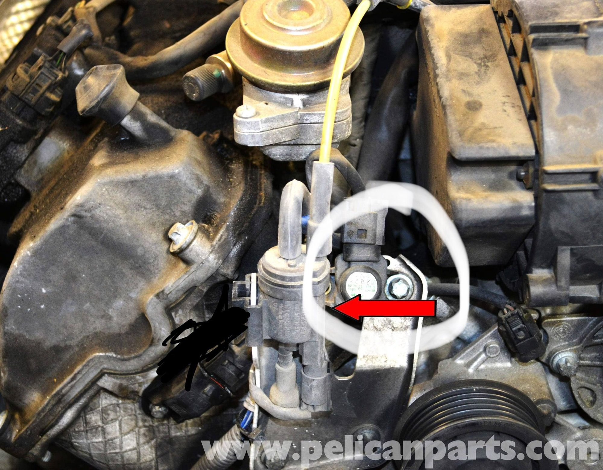

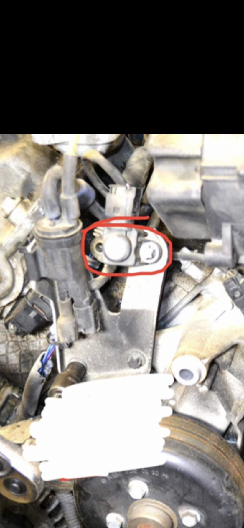

Hi, I’m new here. I’m trying to figure out the name of a part, I’ve search and search the internet but couldn’t find an answer. It’s right next to the change over valve, can anyone tell me the name of this part circled and highlighted in the pictures, thank you.

The PN is visible on the part, directly under the words "Mercedes-Benz" in the photo with the red arrow. Format will be Axxx-xxx-xx-xx.
The photo isn't quite clear enough or I'd be able to tell you the PN right here.
Give the PN to your local dealer and they'll be able to sell you the latest version of that part, or at least give you the PN for the latest version.

I already tried that but like you said the number aren’t very clear at all I can’t make them out either that’s why I posted on here hoping someone would know. I don’t have a local Mercedes’ dealer near me. If anyone know what that part is I’d appreciate the help. Thanks

Try looking here. I don't know the layout of your engine at all, but hopefully it is somewhere in the link.
All I know is that the circled part is probably some sort of pressure sensor.

If it's not pressure it'd be temperature. Problem is I can't see where the probe part goes. Is it attached to a hose?
Just my guess here, but is the part #11 in the link? Manifold pressure sensor, PN 005-153-50-28.

yea it’s a MAP sensor, thanks a lot that really help to figure it out. Do you know if the MAP sensor was completely missing like not installed at all would that stop the car from starting and not even turning over?
