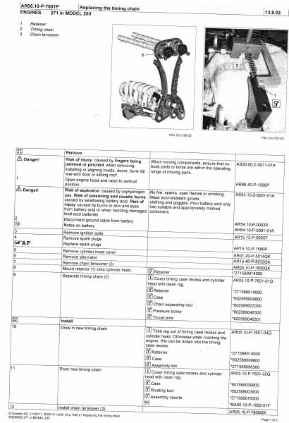

Regarding a DIY chain/tensioner replacement on the M271 I4. I do not have it & there are a couple of special tools that make the job a lot easier to feed the new chain & hold the camshafts in the correct position so that you get the valve timing correct to the crankshaft.
Maybe someone could post the method from the maintenance CD or Star.

Will the attached help ?
Attached Thumbnails 2005 C230 Kompressor jumped time..HELP$$$-m-2271-cam-chain.jpg   2005 C230 Kompressor jumped time..HELP$$$-271-camshaft-2.jpg
