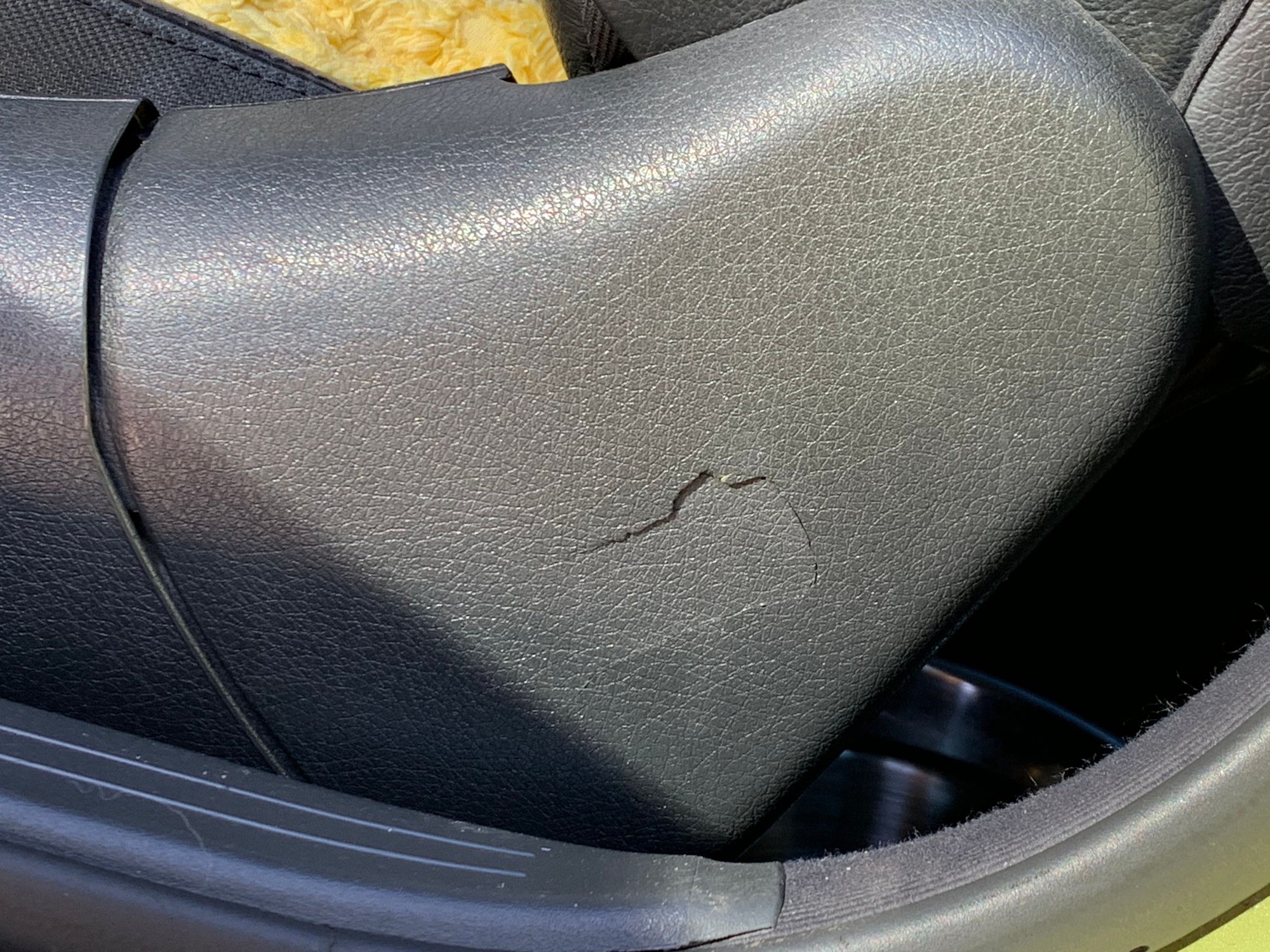

Right side seat control cover.

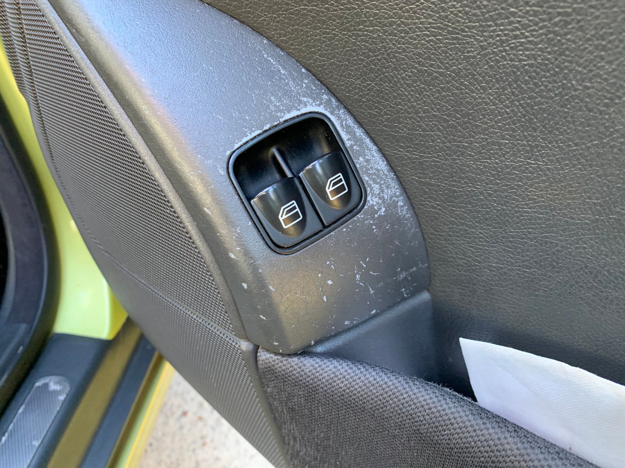

Driver’s side window switch panel.

The window switch plastic trim would be something like 203-727-05-28-xxxx. (xxxx being the colour code, give the VIN to the dealer) PN can be found in the same link above. I would like to say the trim colour xxxx is also 9051 or 9B51, but verify on your own. Your car is RHD, so the PN above is probably incorrect as your R door would have 2 window switches instead of 1 for the LHD cars. Hopefully the PN will point you in the right direction though. The dealer will know for sure.
The cracked seat trim unfortunately needs to be replaced in pairs. The broken piece in your photo "hooks" into the adjacent piece, and they've changed the hook design over the years so the adjacent piece can't be reused. The good news is the new pieces appear to be made of a more flexible grade of plastic compared to the brittle original stuff. You'll also need new fasteners as they changed the length of the screws. The trim PNs are 209-912-23-30-xxxx and 209-918-31-30-xxxx. The (new) screws with the correct length should be 001-984-59-29. You'll need 2 of them.

looking for the replacement for the cracked seat trim on the one parts site you’ve referred to and I can’t see the 2 parts you mean.
However it seems that MB have replaced them with one whole piece instead. Would this be correct ?

The 2 plastic seat pieces are 209-912-23-30-xxxx and 209-918-31-30-xxxx. Just look at the physical seat. The hinge part is actually 2 plastic pieces, fastened together by 2 screws. You have to replace both because one piece hooks into the other piece (you can't see this until you separate the 2 pieces), and they changed the hook design so that older pieces have different hooks compared to newer made pieces, despite them having the same PN. MB are notorious for this.
Personally I had both L and R sides destroyed over the years by rear passengers kicking the pieces on the way out. I'd honestly recommend replacing the other side as well. They used the wrong grade of plastic on the earlier versions.
