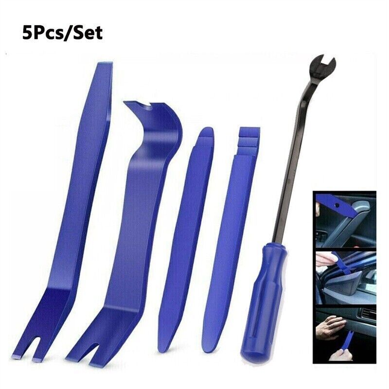

I used a plastic trim removal tool to pry them off. I did break one of the covers, and I replaced it with one from a wreck. I forget whether prying from the top, side or bottom was better.
You can find these at most auto parts stores or from online sellers.
