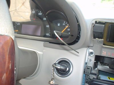

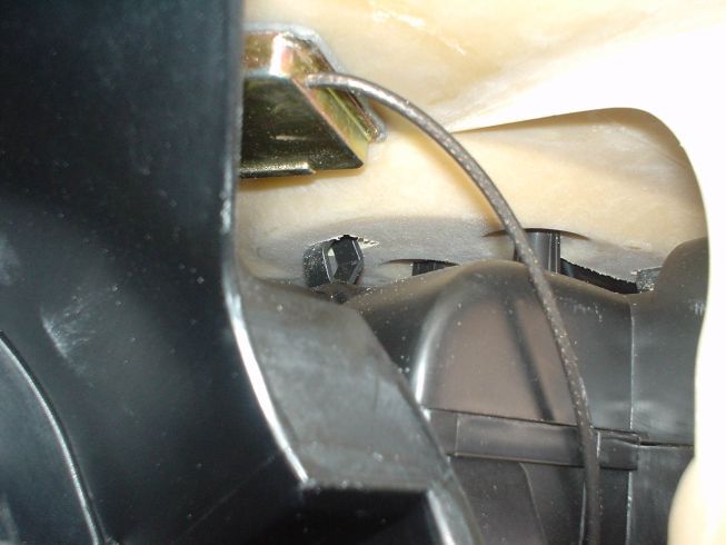

Andy, it is easy
Below are some photos I took while installing the XM antenna.
First is the tool I used, two coat hangers:
Second is the correct tools, about $12 at MB dealers
Third is a photo of the Comand antenna, note in photo there is space behind that the antenna can be wedged into with some stiky stuff to keep it from falling off. My install by Steve lasted about a month! No problems with the Comand since.

Any of us will help you remove this. Several of us will be at the Meguiars clinic this Saturday, and Mark usually has a couple of dozen MB people arround his garage, more when Steve is here. His neighbors must wonder?

Tariq,
Take the speedometer dash out using the proper tool or coathanger wire. Take the Comand antenna and with the top pointing up, push it between the metal frame and the soft underside of the dash covering.
When you look inside the dash opening there is a metal frame, the underside of the dash top has a small space that you can force the antenna into, and it will stay there.
I just re-did my Comand antenna and XM Radio satellite antenna in five minutes at lunch time
