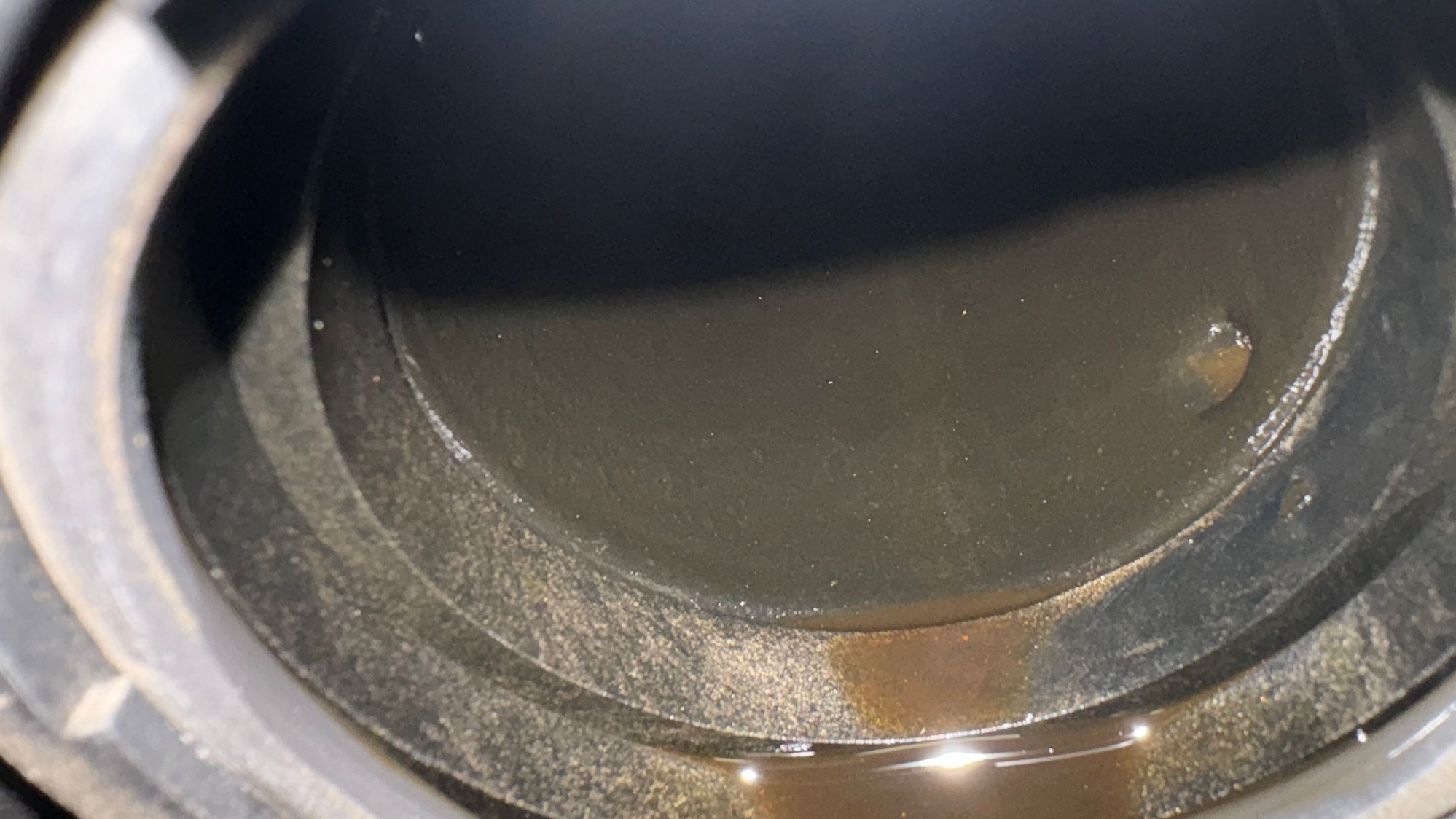

Here is how much oil I had in the MAF and intake right by the throttle body.
I don't think this is healthy, which leads me to believe something is really wrong.
The coupe has been sitting for a while and is now leaking oil.
I'll have to borrow some jacks and remove the full intake and try and find the source of this leak.

The oil in the MAF is kind of normal, you can clean the cyclone oil separator, helps a bit.
Tuning tip, remove the fine metal mesh in the MAF and the mesh below the TB (only the mesh, the ring is the gasket) ~ +5 HP

Originally Posted by TheRotaryFox
Well, I figured out the P0243 code.
Reattached the PCV hoses that disconnected under pressure.
The cause of the PCV code was the SAI switchover valve, and after paying $70 for the superseded part number at a stealership, throwing it in the car resulted in me having full boost again!
The coupe sounds great, drives great, and is a blast.
But now a new CEL has shown itself.
P0101 - MAF not reading correctly.
I thought the cause was that I installed the MAF upside down (silly me)
So I cleaned it out and put it back in the correct orientation.
Then I took the coupe on a 2 hour long highway commute to get some miles on the car, and it performed brilliantly.
However, on the way back, the P0101 came back again.
The car still runs well, but I am stumped as to why I get the code.
I wonder if my MAF has given up, or if there is just too much oil on it.
I need to figure this out and pass emissions.

Originally Posted by ziigen
i got a cheap ebay MAF and have the same p0101, you need a genuine siemens maf if you want the ecu to be happy. I have no performance issues with the ebay maf or cam pos sensor tho
I picked up this MAF from the stealership and paid WELL over what it's worth.
Just dunno what to do now, I either think its the intake oil separator thats given up or another vacuum leak.
Either way, can't do anything right now as I am at university without the coupe.
I'm thinking of taking it to a shop and having them diagnose and potentially fix it since I am kinda just fed up.
Yeah it's not the cars fault, its mine but y'know, after doing the head gasket and having boost back I just want the car to be legal again and be able to survive the 1000 mile roadtrips I want to take her on.

Originally Posted by an6dk
Hey on the bright side at least that car isn't the one you're relying on to get you to and from classes and back home (situation I'm in). Each time I get somewhere without any weird noises I give thanks. Have you thought about a potential engine swap? It sounds crazy but if the repair prices you're looking at cost as much as getting a new engine for it then it might be worth because you're able to have it not running for extended periods. Or maybe putting in a standalone ECU to rid yourself of all the Mercedes nonsense (not sure if that'll pass inspections in your state)
True, that is a plus.
Although I would kinda like it to be with me lol.
I feel like finding another M111K EVO would be impossible, and swapping to a M112 or M113 is not very economical considering I'd have to swap in a new transmission.
Standalone would probably cause some bs reason to not pass CA smog test.
I do think the P0101 is some wiring issue or a vacuum leak somewhere hopefully.
I do think a shop diag is worth it atp and would save me the headache.

Yeah at this point. Find a good shop who will actually do a dianosis and not just sell you parts.
Definately NOT Walnut Creek Mercedes. So "your car’s computer sees a mismatch between the amount of air entering the engine and the reading it’s receiving from the mass airflow sensor. This kind of mismatch can set a P0101,"
Just wondering...is the O rong in the plastic pipe where the MAF connects to the oupuut of the superharger still there?
A dealer lost mine once and it was years before I could find another as you can't purchase from Mercedes and
it only comes with the plastic intake pipe for $$$$. I got some Orings locally but they weren't exactly the right size and I had to jury rig with duct tape. Arrgh. I finally got one from a junkyard,
Is there air leaking out around the MAF? Any of the connections between the MAF and throttle body leaking at all?
There's a screen nelow the throttle body with a gasket is that still there?
What scanner are you using to read this error? P0101 is a generic error.
If you were getting the Mercedes codes you might find it.
After all how the heck does the car know there's a mismatch on air levels when the only
thing that measures that is the MAF?
Vacuum leaks resulted in lean conditoin for me. Not
P0101. Never had that one.

If you have compressed air you can do an easy and fast vacuum test. Use the hose connector at the TB from the EVAP system for compressed air input, remove the air filter and close the oval inlet with a latex glove and a rubber band. Put pressure at the system and watch the glove get inflated and more important how slow it deflates. Should be very slow.
When I return in December, I'll check to see if the O-ring is still there.
The screen below the TB is there with its gasket, but I'll double-check.
I am using a cheap FIXD scanner I bought a while back.
Along with the P0101, I sometimes experience a lean condition, so I think there may be a correlation.
I think the MAF connection is either wack or there is just too much oil being thrown at it.
Maybe my oil air separator failed. I'll probably tinker with the coupe some more when I go back home, and hopefully, by Christmas, she will be legal again.
I will try this as well, thank you!
I wonder if all my fiddling with the head gasket has messed up some of the hoses, and that's why I'm having these problems.
If I have to go deep into the motor again, I will be bummed.
I just want to have fun with this coupe after all that effort.
