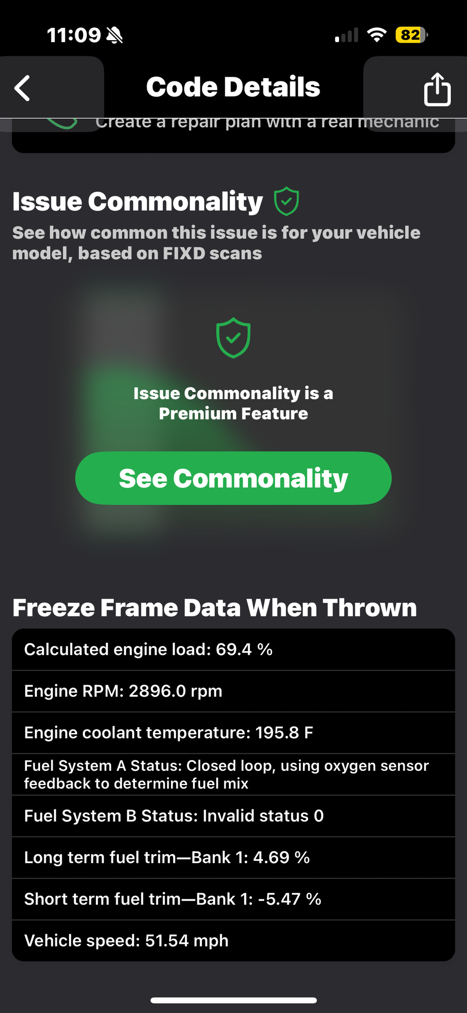

Car has been driving fine, except no boost with CEL showing P0243.
I'm planning on checking the MAF and replacing some gaskets for the intake when I go back in May.
Currently, the coupe has expired registration and needs a smog check.
So the car will sadly sit again until I go back.

Check the connector for the boost valve (ie recirculating air valve) on the intake. Likely you forgot to connect it.
Has happened to me before. Also that red rubber piece on the oil catch piece.
You have to put a little oil on it when you re-assemble or it will get smooshed, leak, and same result.
Doubt you need a MAF. That typically doesn't hard fail. Just gives P0171 lean engine.
PIA because it won't pass smog with that.
Frickin' CARB has you by *****. Any CEL can prevennt you from passing smog even itf you pass at the tailpipe.
Clearing an error clears the readiness indicators.
You can't get a registration unless the readiness indicators all are good.
Maybe they allow one? Used be you could but tight**s MF's want to scrap your car.
You can't get the readiness indicators to go ready unless you drive the car.
A LOT. Thousand of miles even and maybe still won't go.
And DMV will only give you a one day pass. But it could take a month....or more.
After 6 months they can impound the car if not registered and you are caught driving it.

Well, the car still isn't 100% yet.
Replaced the battery, and the car starts fine.
Now I only have a P0243 CEL to worry about.
Main thing is the cars reg is expired and I gotta smog it but I need to get the code removed to be able to get the car smogged.
I do have an oil leak from the hose that goes from the supercharger to the crankcase ventilation hose that connects to the oil separator.
I ordered the replacement hose, and so I hope that fixes the CEL; otherwise, I don't know what to do.
The car sometimes has boost, and if I go past 4k in 4th gear, I feel some hesitation, and the car is naturally aspirated again.
I will let you all know if the coupey is 100% after I get that hose.
Here are some pics in the meantime:

P2043. Hmmm....like I said get a Mercedes scanner. You might need a new recirc air valve or...not?
I paid $300 + on rockauto for a new one, and that was lowest price I could find, but in the end it was also bad MAF.
Before you do anything, check that all the hoses and that red gasket thingy in the oil catch that the recirc valve is attached it.
If you don't put some oil on it, it smooshes and causes alll kinds of sheet.

Do a basic test with the recirculation flap: Close it by hand with your fingers and release it. It must snap right open. If it opens slower than removing your fingers, you must clean the flap. Disassemble the flap cover and take out the motor, clean and grease/oil the bearings. Delete the code.
I think the recirc flap is dirty, because I remember it didn't snap right up and I had the issue of it not letting the coupe boost without leaving the key turned for 5 seconds.
So it probably needs a clean, and if that doesn't help I'll clean the MAF, then replace it, then replace recirc.
It is pretty funny that the code is basically gone until 4th gear 4k rpms.
Then it throws a light and then boom no more kompressor.

Was it the "overvoltage" code? I would think that is a MAF based fault, because the SIM 4LE doesn't use the boost value for driving.
I dunno.
It was a P0243 and I only have a basic scanner, nothing too fancy or for mercs specifically.
Technically, I had a P0638 and a P0120 when I first started the car after doing my headgasket, but unplugging and replugging in the TPS seemed to fix those.
Then I got the P0243.
Old May 25, 2025 | 02:34 PM

Do you have compressed air? If yes, take a rubber glove, put it over the oval intake after the air filter and use e.g. the tiny hose at the TB to pump the system up. If the glove looses air only slow, you're good.

OK, so ask yourself this, did the car have these problems before you worked on it? Yes, than it was an existing problem.
No? Then it was likely caused during the repair. Which means, you just need to go back and check everything. Did you check that
red rubber gasket on the oil catch/SC intake? You need to lube it up with a little oil and make sure it doesn't get smooshed when putting that piece
back on. All hose are connected and good?
Whooshing sound: You know that this car uses the SC as an air pump to help heat the Cat on startup, vs. electric motor in other cars, right?
If you didn't know, thats likely your whooshing sound. I'd check all the gasket and hoses.
As fas driving like a granny to get past smog...uh, so what if you drive harder CEL comes on?
So you're clearing it, and then driving easy to smog?
If you clear it, you also clear all the readiness indicators and you will fail.
I've written about this frustration quite a bit in the past.
