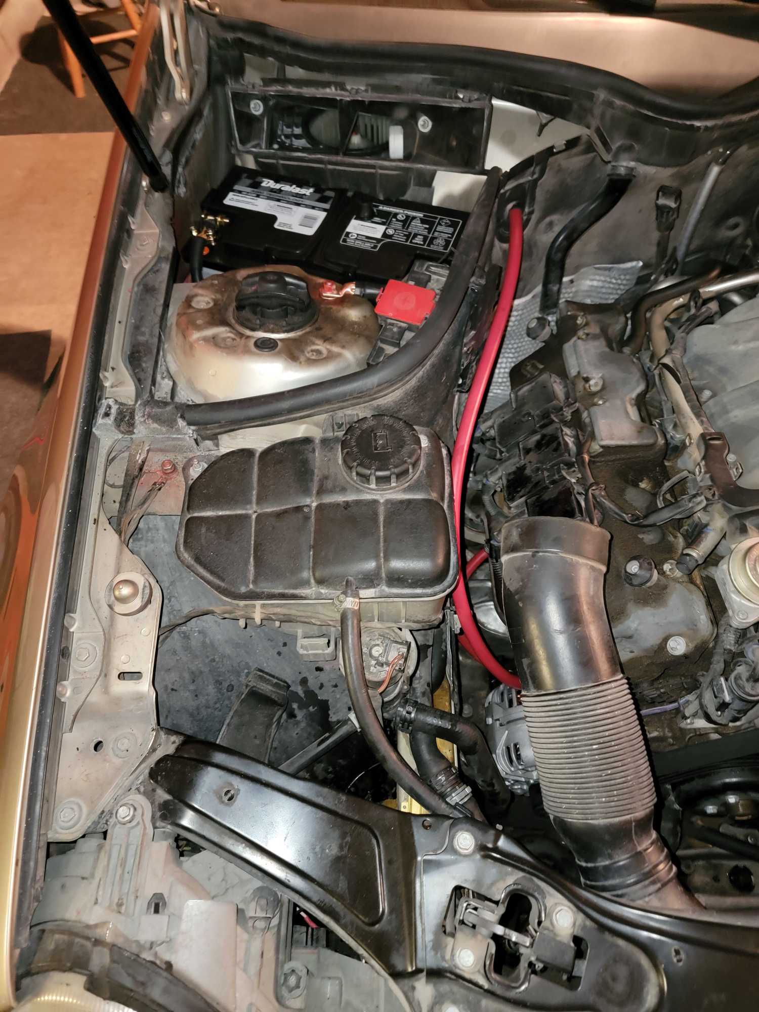

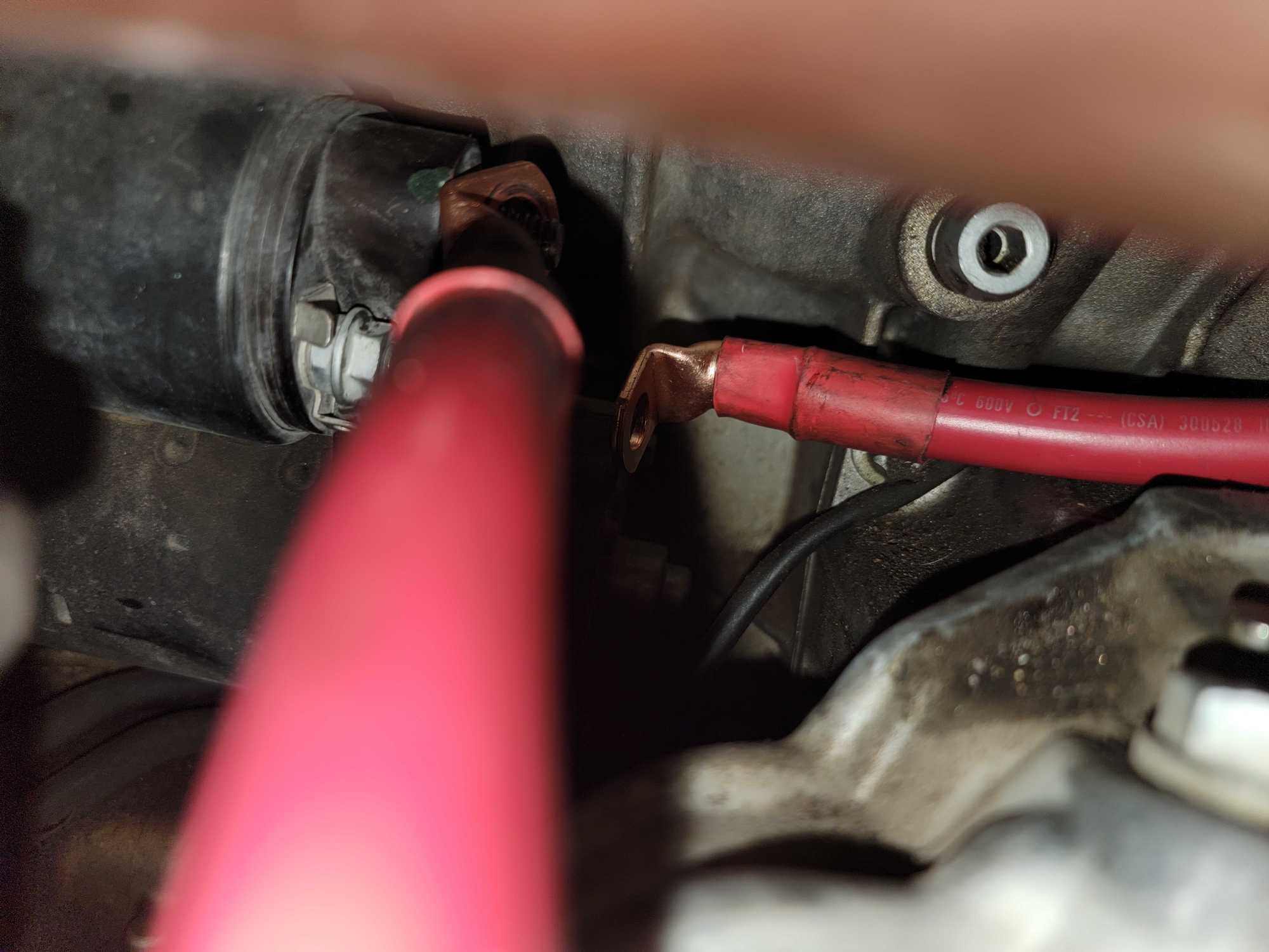

2003 C320 Sports Koupe issues starting
So a month ago, had an issue with C320 not starting. 204,000 miles roughly, got codes for P0355, crankshaft sensor, but had already changed it from Bosch to Hella. At this many miles, figured the starter had given up. Tried to replace it myself, but didn't have the ability to lift the motor, and noticed a bolt sheared off from having them changed last year. Took it in, let them do the work removing mounts, they called, starter wasn't the issue. Change it anyways, you've got the mounts out and one needs the broken bolt removed. So they did it, and changed the Hella to a variant, whatever it was, and had same issue starting. It won't catch. Did say that it likely needed the electronic control module replaced or flashed. No one local could do it, so before sending it out, neighbor has about 8 Mercedes laying around the house, we used his code scanner, same thing, over and over, P0355. We'd clear it, try to start, every time, same code. So, pulled the ECM, sent it to New York to be cloned, got it back today. Put it in, wired the car back up. First crank, no go, second, and on and on. Called cloner, they said they'd send a replacement. But before I did anything else, I checked fittings on battery, and some are a little loose, tightened everything down, fired right up. Checked codes, no codes, none. Turned it off, turned it back on, no fire. I'm almost back where I was before laying money into it, except eventually it will fire, isn't rough idling now, and is far, far smoother driving, it's just getting it to light and go. Checked battery, Duralast H8 Platinum, checked out fine, too. Also replaced batteries in key fob. Yes, stock wiring was replaced about 5 years ago, because with navigation system, micro amp and subwoofer, the alternator was too weak at 120 amp to support, so I replaced it with a 160 amp, which necessitated replacing the wire with 0 gauge to not burn up anything. The last two summers here have been brutal on heat, over 100 days over 100, and this car went from El Paso to Disneyland and all around Los Angeles and back in September of 2022. The terminals are Kicker, and the positive fits on smooth as butter, the negative, however, is a 3 eyed mother I had to cut an Allen key down to even be able to tighten it, and it's also got a plastic plate under it, so only about half the terminal is actually connected. Am I up to something with the ignition switch itself, the keyfob, or keep digging?
Starter connections, line going to alternator.
Main line from positive terminal to starter.
Positive terminal, 3 way kicker with 8 gauge going to block for entertainment system, 0 gauge going to starter, other 0 gauge going to the terminal block.

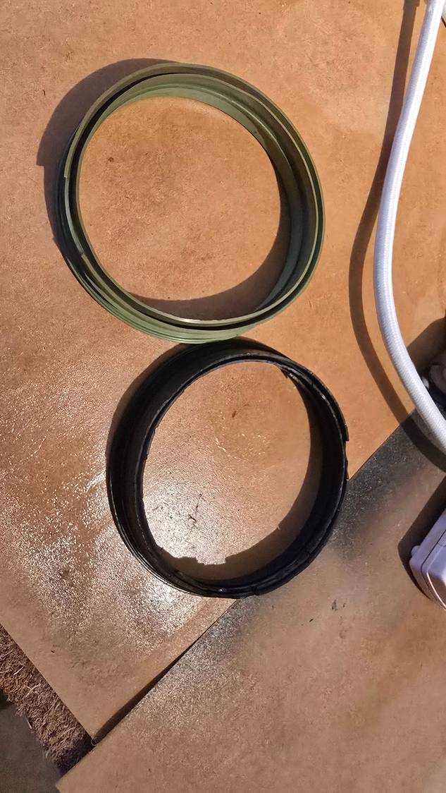

What if I told you, while thinking about the rings on the fuel pump and sending unit, I didn't think they were fully tightened? Better than that, the sealing rings weren't replaced, and I know one had a chunk missing out of it? and both were severely expanded and out of shape? Ordered 2 more and getting a loan a tool to tighten the rings correctly.

A bad tank ring(s) would result in fuel leaks at most. Obviously a good idea to replace those while everything else is out of the car.
I don't want to keep adding to the list of random parts to throw at the car and driving your costs up. Worst case, there's always the local indie.

It is driving me nuts. Along with the seal, I don't think the rings are tightened all the way, so loan a tool from autozone and make sure they're tight. Just insane, no codes, nothing showing up at all, and when it does fire, it's not stalling, losing power, nothing.

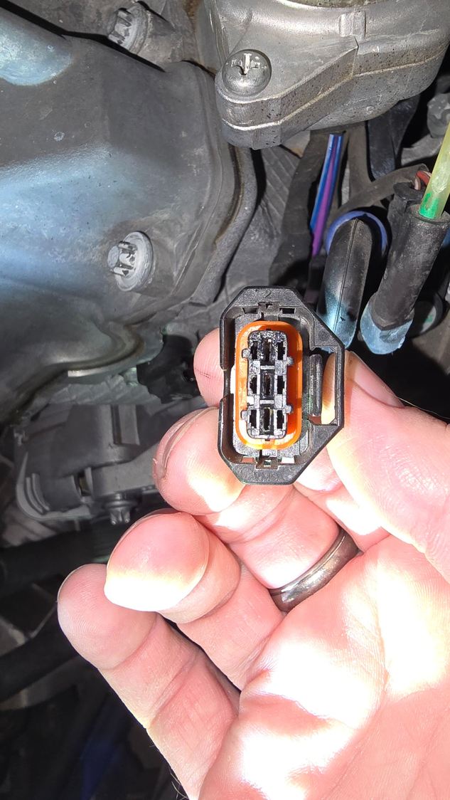

Let's try this on for size. So the issues started when I was getting a camshaft and crankshaft sensor error. I replaced both at the same time, with Hella brand. Years ago, probably the last time I changed the camshaft sensor, I had to replace the pigtail on it because it was falling apart, and I was holding it together with zip ties. Looking tonight, the shrink tube I used on the wiring is suspect, and I'm wondering if I didn't break a connection or something in the tube, and that's causing the issue, like the middle line looks worst of the 3 as far as crimped at an odd angle.

So, I was close to what it was; I redid the wiring for the camshaft sensor. Go to love how the same how the exact same pigtail for ABS control modules is the same as the camshaft sensor, but the camshaft sensor is $40 more. So, $10, redid wiring. No change. Pulled pumps, changed seals, the pump side hard as a rock and looked like it fought with a pineapple and lost, sender was bad, but flexible. No change. Went and got a new crankshaft sensor, let car cool down. Bosch, 100% Bosch part. No change. I knew the camshaft was supposed to be a Hella, and was. But as a last ditch effort, went and got a Bosch, tools in hand, at Autozone. Fired on first crank. Went to 4 more destinations, 4 starts, no issues at all. Fingers crossed in the morning that this is it, because diagnosing this thing is impossible when there are literally no codes. But at least I've avoided any other major maintenance for a few years with all that's been done.
