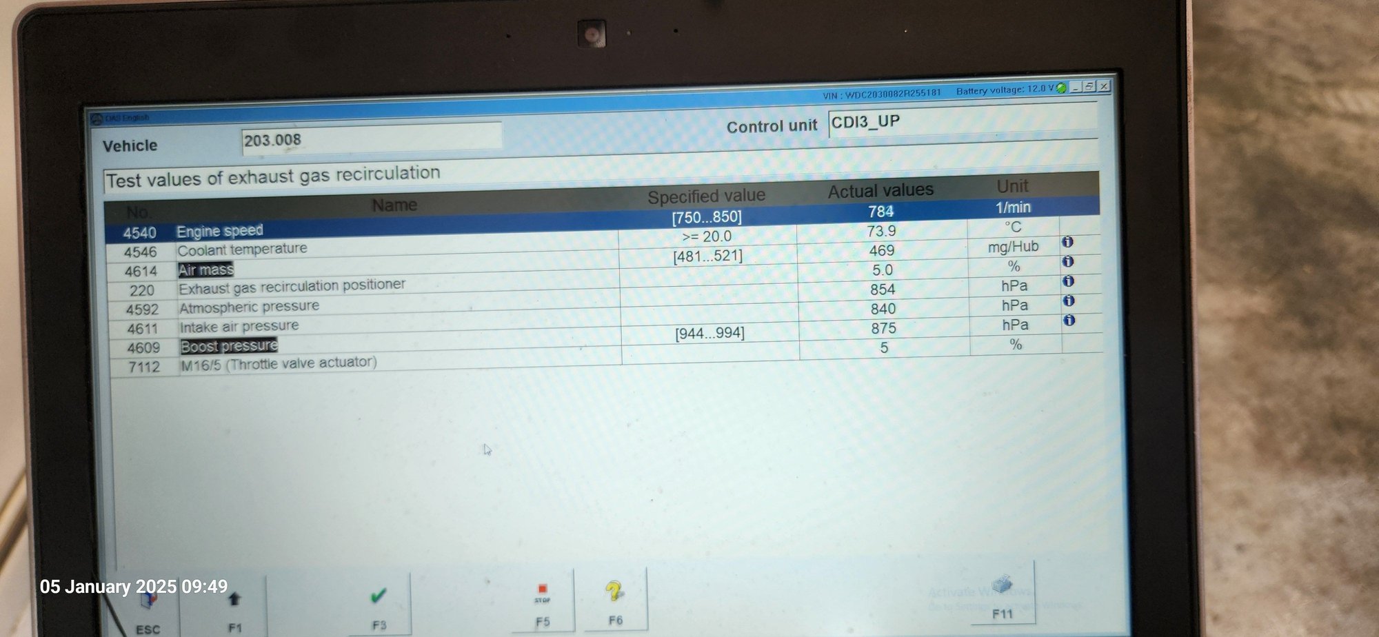

hi i have been struggling with my c220 cdi for some time now, vehicle lost power last year November, vehicle felt like it was not boosting, and it did not want to rev past 3000rpm but it would drive to around 80 km/h but struggling i would have to drive it in manual mode to go up a hill, first suspect was turbocharger.

  2. vehicle still had no power this time I got a fault code (check component Y100/1 right charge pressure positioner signals fault) - permanent
  3. when I checked actual values on idle or when the idle is raised the boost value and air mass values our out as per screen shots below, if i rev the car and switch the vehicle on and off the car would then allow we to rev past 3000rpm and vehicle boosted briefly then it would go into a limp again.

I am not sure what else to do here, can anyone recommend what I should look at? i dont want to keep replacing parts and not getting anywhere, i was thinking there might be an issue with the air mass meter but was not able to locate a used one to test.
