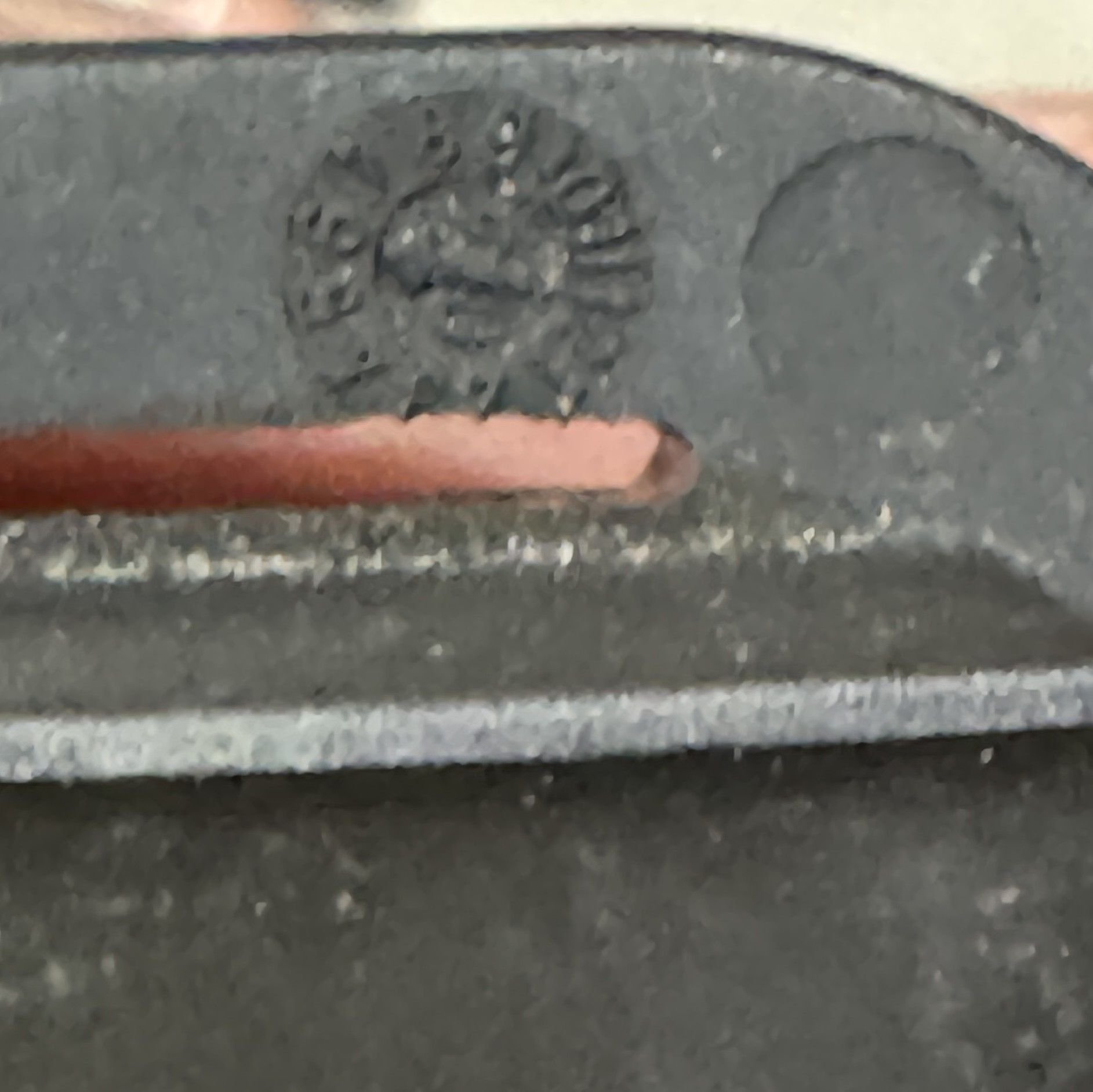

The connectors are easy to install. I pulled off the old ones and pressed on the new ones. The connectors turned a coil with a split in the connector:
Into this:
I was working on the assumption that the coils were the original ones installed at the factory. I looked more closely at the information written and stamped on the coil.
Note the small marking at the top right of the coil.
It appears to be a date stamp with the arrow pointing to the 6.
S
Merecedes manufactured my car in 2004, and I bought it in August 2017. I'm thinking that a previous owner replaced the coils in 2016 or 2017 with coils manufactured in 2016. If that is accurate, I repaired a 9-year-old coil instead of a 21-year-old coil. That gives my gamble to fix rather than replace the coils a higher probability of success.
Wish me luck.

FYI the old coil (green writing) in your photo is original from the car, manufactured in 2004 late August (04, 231st day). MB have an updated PN A000-150-29-80.
The Beru aftermarket equivalent is PN ZS053 (old?) or ZS077 (new?). Not sure what the difference is between them, but both PNs work fine on my car, and they look identical. Interestingly enough, the official equivalent is ZS053.
