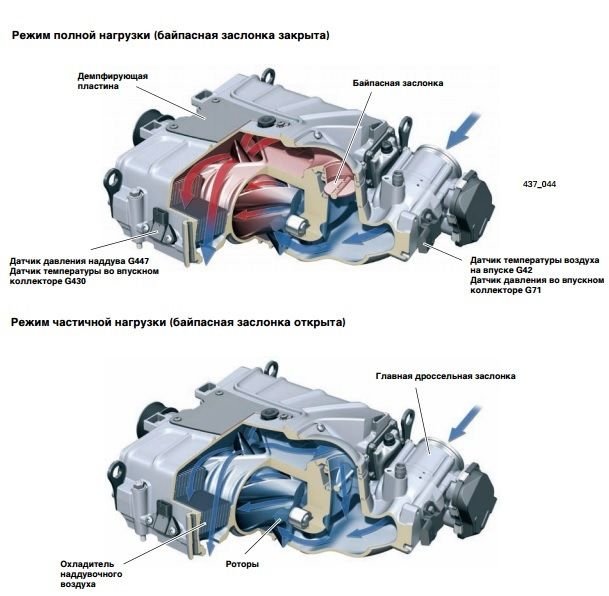

with the 64mm pulley you get around 17000 rpm at redline. The boost that you see is okay. With the tune you will not see more as it is not so limiting on boost. The aem wideband that you have is a huge plus.
Oh the Audi supercharger that becomes TVS1320 is the thing that I saw like a week ago on gkingz in Facebook?
upload your original file and any tuned files if you have and I will help you do it
