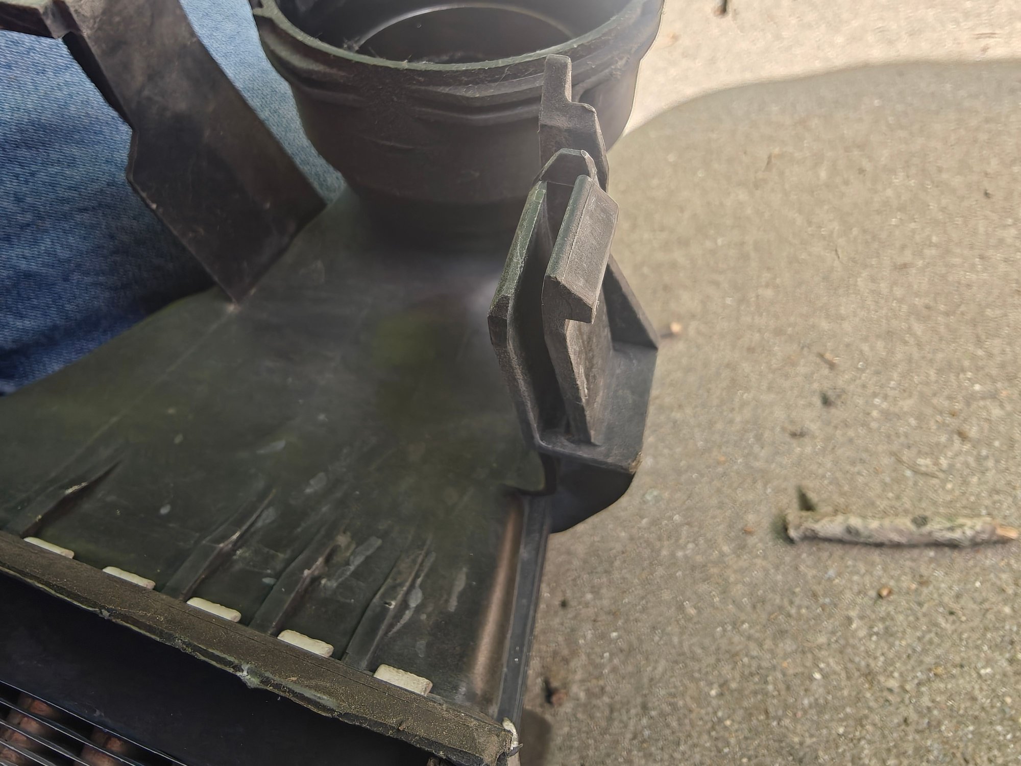

Ive figured out how to get the intercooler off. Essentially once you have the bumper and lower skid plate/engine under cover off you just need to pop the clips off on each side of the hose then press up on the little tab on the bottom part of the mount of the intercooler. After that clip is lifted up you can pull the bottom of the intercooler up and out and push down on the top mount with a screwdriver and it should pop out. Included are pictures of the mounting points on the car and the intercooler to help anyone else who needs to do this understand how it comes out. Way easier than I was expecting.
inter cooler mounts on the radiator assembly passenger side.
Inter cooler mounts on the inter cooler driver side
Inter cooler mounts on the inter cooler passenger  side
Inter cooler mounts on the radiator assembly driver side
