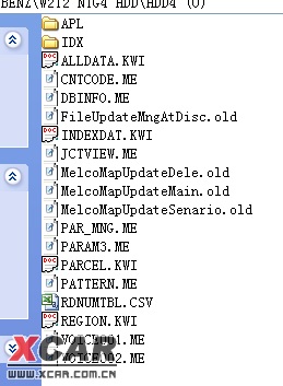

Some people in China have hacked the HDD of W212 E. The files in HDD are shown as below.
HDD of W212

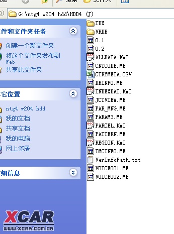

HDD in my car:
They have tried to simply copy the W212's map data to W204, but failed.
What's the problem? Why?
Any ideas? Thx~~~~~ to every reply

OK, the first problem you will encounter is that the W212 uses a different map disc than the W211 or W204. That's why the head unit is officially named NTG4.212. Secondly, by simply copying the files and not doing a disc-based update, you are only copying the files and missing any instructions that are included with the update software. Thus if there's a configuration file that needs to be initialized, updated, etc. that step will be bypassed. Also I know there's a stage during the GPS startup where the maps are authorized and authenticated, most likely a form of DRM to prevent piracy. That means the files you copy could have something like a watermark or a digital signature from the vehicle it was installed on, and again by bypassing the installation disc, there is a mismatch.
