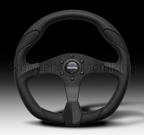

or, since you are a Momo fan, you could get the Momo wheel for $157 USD.
http://cgi.ebay.com/ebaymotors/MOMO-...item20b7e6e657
I hear that AMG partners with Momo in making AMG steering wheels. notice the resemblance.
