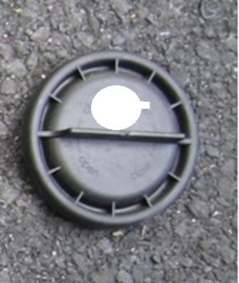

OK, finally got around to installing the HID kit for my low beams.
As it turns out, it was pretty simple and straight forward. It took me a little over an hour but simply because I has a hard time putting the bulb retainer/pressure spring back on the left headlight. Had it not been for that, I probably would have finished it in half the time.
Originally Posted by lemzen
the lows, i used a 7/8 drill bit to put a hole in the cover, then i had to pull the wires out of the grommet of the kit to put the grommet in since the harnesses were too big to fit in the 7/8 holes.
I started to do that but it seemed like I would either tear the rubber grommet, or I would have to cut off the end connectors, pass it through and reconnect; didn't want to do either so I simply notched out a small square on the edge of the 7/8" hole (see attached pic (and i forgot to take pics so I just cropped/edited one of lemzen's picture )), then I slipped the big harness through, slipped the 2 small harnesses after it, slipped the grommet on (and yes, it still covers the small square notch) and connected all the wires.
plug red and black wires into the cars harness.(black matches up with single black, red matches up with double black of harness)
Hahaa, I actually read somewhere on this forum that the double black *IS* the ground.
So I connected "the black wire from the HID kit" to the "double black connector on the car's bulb harness", and "red wire from the HID kit" to the "single black connector on the car's bulb harness".
Worked fine for me!!! (May be 'cause the polarity on the harness connecting back into the ballast matched that on the harness into the power supply harness??? )
Anyway, thank you lemzen for the direction and help with the install.
And of course, thank you Michael for all your work on getting these lights to us and for all the tips on the install as well.
Also, I read somewhere else on this forum that installing HIDs into the halogen projectors can result in a different beam pattern output and too high of a cut-off... So I took "before" pics of the cutoff (with the halogen bulbs @ 25 feet away from a wall)...
I will also take "after" pics of the cutoff (with HIDs/same distance/same wall) later on tonight and post the before/after comparison.
Then, it'll be on to installing the matching fogs!
