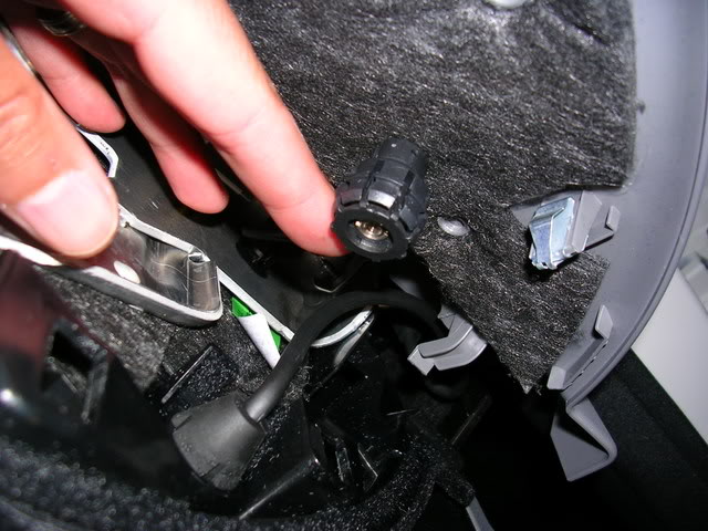

You want to use the iPod Integration Kit for an Android?
You should have a 3.5mm mini jack hidden behind the side dash panel. When you open your passenger door, gently remove the panel. They usually just loop up the aux port and stuff it back there. I have both but I was one of the first to add the iPod adapter.
Well, I don't necessarily want to, but I didn't really see another option except for buying an iPod. I'd like to be able to stream Pandora and Spotify as well.
Now, the panel you're saying to remove, is this on the passenger door or on the dash?
You need to open the door to see the panel on the side of the dash. It's on the other side of the panel where the aux jack is plugged in.
