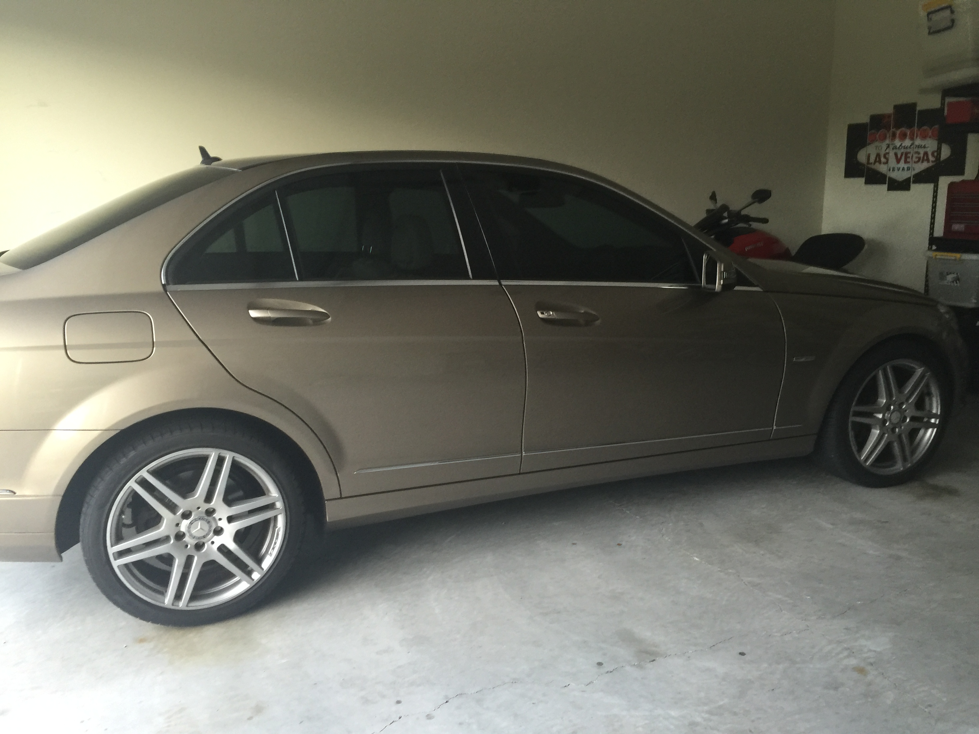

Lowering a W204 C200 Kompressor 2009 Avantgarde Australia
Hi All
I have read the entire threads on this subject
My understanding is that the C 200 Classic has the highest suspension standard and my model the W204 C200 Avantgarde and AMG have a lower suspension standard ?
What would be the best H&R springs to fit Sports or Supersports
Wheels AMG 18 x 85. and 9.5
car ATM

It rides very well maybe 10% firmer but really nice as the days go on it settles a little , so rubbing either
