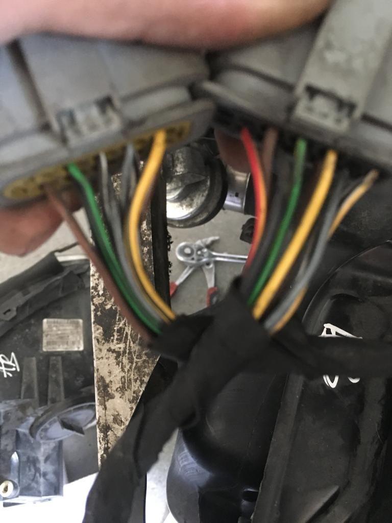

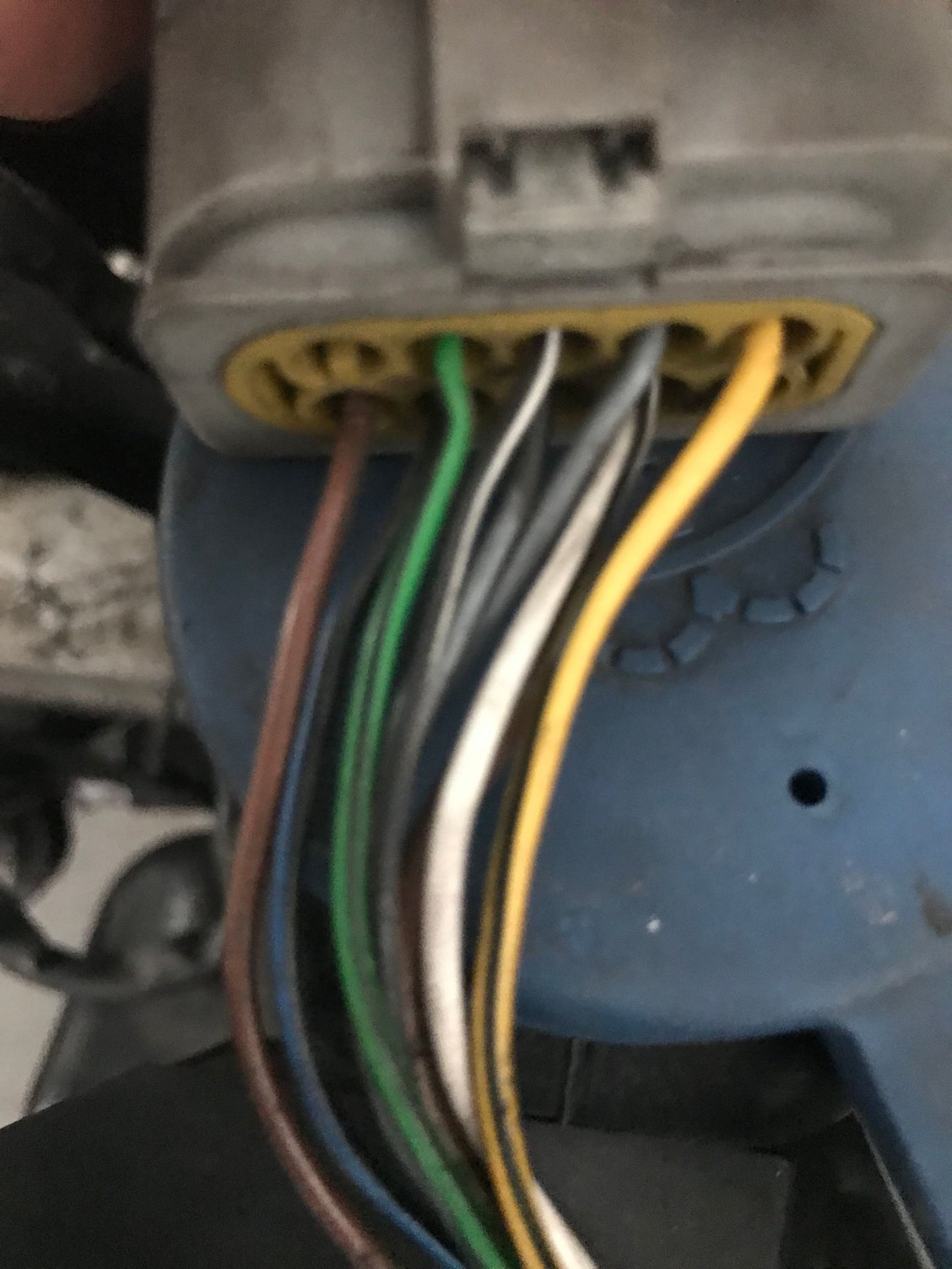

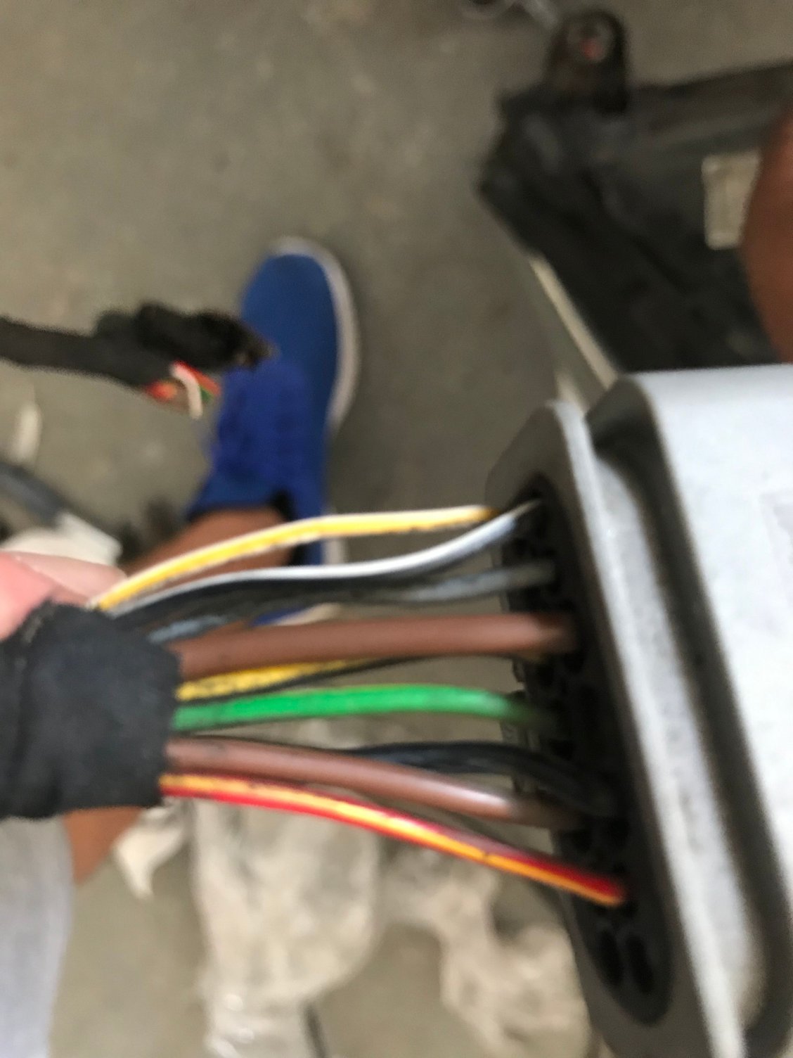

Hi mate, any chance that you could help me? I'm trying to upgrade from 2010 C Class Halogen Headlights to Bi xenons headlights from 2011 sport C class, halogen lights connector (yellow) has 10pin with 10 wires and Bi xenons has 14pin with 9 wires going in, I just wanna cut the cables from 10pin and join them to the 9 cables coming out from 14pin connectors, getting confused with wires colors also where i'm suppose to install capacitors? Best regards.

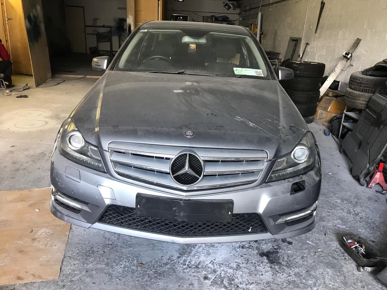

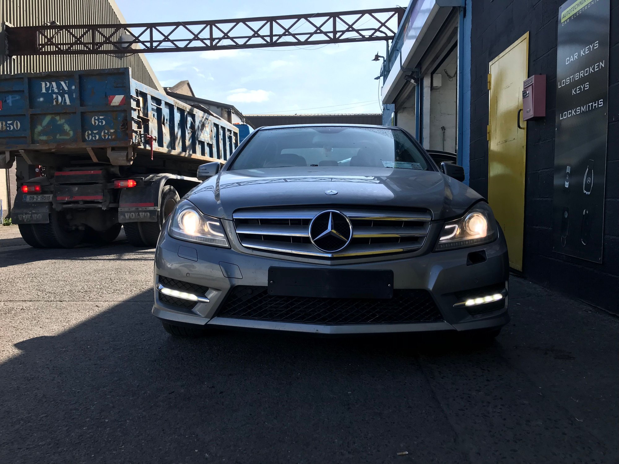

don't know if did the wiring right or not but im just getting left and right parking light faults? and C lights doesn't look bright enough? any help much appreciated.
