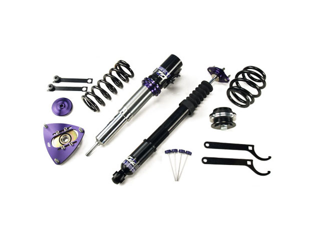

Originally Posted by kevink2
Those are very stiff, highly adjustable Racing Coilovers, probably the best way to slam a ride.
I had some experience with similar Buddy Club coilovers, trying to fix mistakes made by BC in a custom batch of CO's for another car. Changing the spanner at the bottom is the normal way to set ride height. Messing with the upper spanner nuts only changes the preload, and does not directly change ride height.
You may have the option of stiffer, shorter springs to drop ride height. Need to contact D2 tech on that.
www.d2racing.com optional springs....
redkid's ml :
To lower the car, did you turn the shock body (part that purple lock nuts turn on) all the way into the lower body (bottom right of pic above) that does not rotate? That would be the lowest setting. The "preload" set by the upper 2 purple lock nuts, does not change ride height. Most kits say don't mess with the preload setting.
redkid's ml :
yeah i didn't mess with the actually strut body, just the purple spanners for the springs... i can probably drop my front another inch
You can go too low, wher bump steer and other problems show up.
The purple nuts should be set precisely for the right preload, or bench compression of the spring. You messed with it, although the instructions say don't do it, so you should call D2 and find the correct way to reset the "preload", which has nothing to do with ride height. It's a standard proceedure, and you can do it with the struts on the car.
well i maxxed out the rear and wasn't satisfied with it so i pulled out the locking spanners and the rubber grommets the springs sit on
Just to be clear, you lower the ride height by screwing the threaded part ( that has the 2 spanner-nuts below the spring) into the lower body, where ther is a single spanner nut. This is a pic of the D2 front strut, but hight change method applies to rear too.
As I said before, don't change the pre-compression of the spring, as defined by the two vertical arrow heads pointing toward each other, by messing with the "A" nuts.
The D2 spring rates are about 600 lb/in, vs about 200 lb/in stock rates.

the locking spanner was removed
Old Apr 15, 2013 | 03:29 PM
  #65
Mixedfruits's Avatar
Joined: Dec 2010
Posts: 1,170
From: 626
E63 Black on Black
there is only one in the rear so I cant adjust hieght its on max low..
Old Apr 15, 2013 | 04:35 PM
  #66
kevink2's Avatar
Joined: Sep 2008
Posts: 1,331
From: Delaware
2004 Mazda6, 1993 RX7
1) -- Looks like the rear has one threaded ring that supports the spring's bottom, and a 2nd lock ring, no?
http://www.carshopusa.com/ebay/d2-rally.jpg
2) -- On the front, you must not change the two spanner-nuts that set the preload, as shipped, correct?
