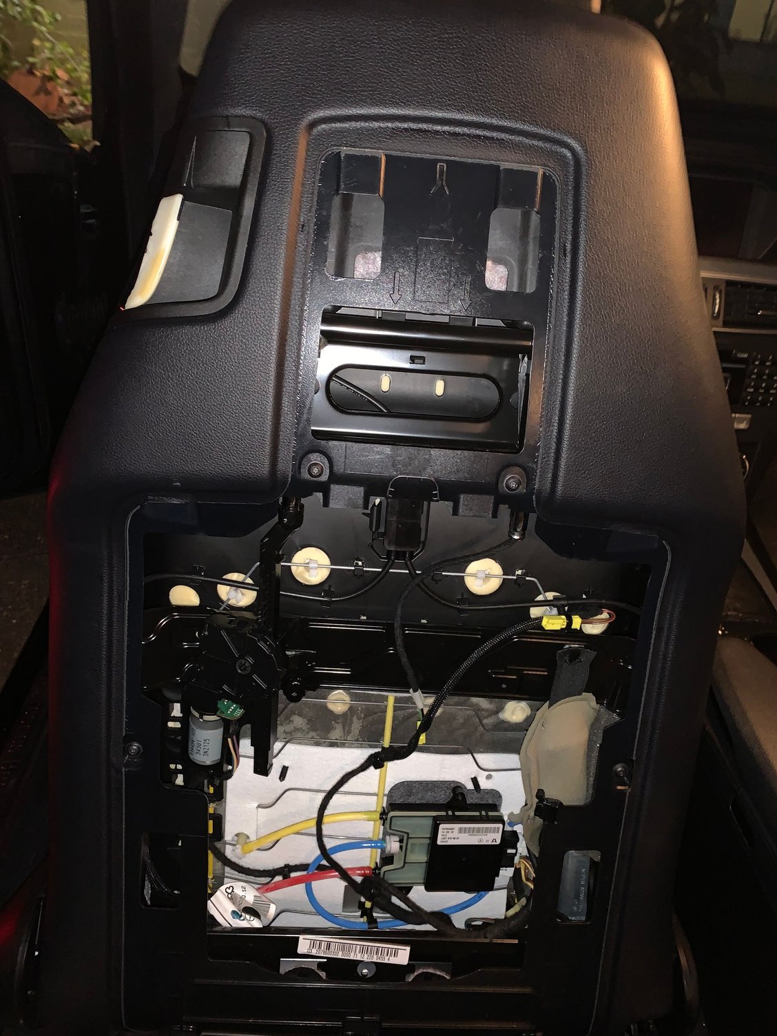

Help with Pro Headrest please
Can someone help me with mine. I have the clips out. It won’t come out. What am I missing?

What wont come out, what are you trying to do?
the headrest. I got a new one. The old one just randomly broke while I was driving. I must of leaned too hard on it. Plastic pieces was everywhere. Bought new one off eBay.

I have a floppy headrest so was searching around for answers. i came across a video, its for a Jeep but looks the same as a Mercedes, its not in english but pretty easy to understand what he is doing. He shows how he removed the headrest.
https://youtu.be/YUBwfb99UDU
Thanks. Mine doesn’t have the buttons to push in on top but I’ll give it a try.
