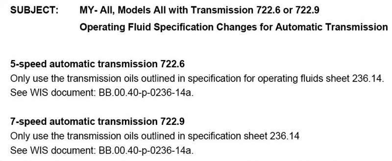

I have a 2007/2008 220 CDI Auto. My MB dealers mechanic says that I should do an oil & filter change every 50,000 to 60,000 kilometers , NOT MILES. Please see attachment.
He also says that a full flush is not necessary unless the fluid is discoloured badly. Just a drain & filter change. Best to drain overnight to obtain max amount of fluid drained.
Make sure you use the MB recommended auto trans fluid.
Transmission oil change?-204-service-sheet-2.jpg   Transmission oil change?-mb-trans-oils.jpg
