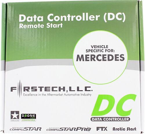

Hey guys. I just placed a order for a compustar unit that utilizes the factory mb remote as a remote starter. Has anyone had any experience installing or using it? was wondering how good was the range and the installation difficulty. My order should come in within a week and i'm planning on doing a detailed review and install as soon as it comes in. Im also thinking about getting the drone capability so i can be able to control the car functions from my phone.

i still haven't installed it yet. its been sitting in my trunk for a few weeks now. haven't been brave enough to tackle the job myself, waiting for my friend to have the same day off with me to install everything since he is way more tech savvy with ignition wiring. but from what i seen it is only 6 plug and play harness and one tap into accessory wire. So i might be doing this this weekend myself after i opened the box. yes stay tuned a detailed...well the first DIY ill do will be posted. hopefully its detailed enough.

BTW, I did find the Compustar remote and Dronemobile setup on Bestbuy. If anyone else knows where I can also get it please let me know. Thanks
http://www.bestbuy.com/site/olstempl...c=abcat0300000

SUPER easy install, All DIY in about 15 mins tops, If you have the right tools. I bought these sets from Harbor Freight. $2 for the first link and $7 for the second link.
http://www.harborfreight.com/4-piece...set-66836.html
http://www.harborfreight.com/5-piece...set-67021.html
Here is the installation guide for the "Brains" of the unit. (This will get you the remote start off the Panic Button from your factory keys and gives you an extra accelerometer (motion/bump sensor) within the unit.)
Firstech Mercedes DC MB204
Install Guide Here:
http://www.compustar.com/dealersuppo...stallation.pdf
Then you'll need the Drone Mobile DR-2000, This will get you (Lowjack) GPS tracking and remote start from your Smartphone anywhere you have cell service.
Install guide here for DroneMobile DR-2000:
http://www.compustar.com/dealersuppo...l_Guide5x5.pdf
Drone Mobile requires a subscription service for GPS tracking. View Dronemobile.com for Rates. I'm just doing the yearly plan for now. Also the DR-2000 has a sim card in it which needs to be activated through the DroneMobile website. It means that your car is essentially a cell phone that needs to have cell service (I haven't figured out which cell company it uses) but take a look at this map, if you live in an area that doesn't have great coverage either move or don't get this product. It took me forever to re-find all these install guides on-line if you buy the products they come with them as paper print outs. So sorry for the delay, also I still will post a video on YouTube as soon as I get time.
EDIT: I called Firstech maker of DroneMoblie and found out that the GPS/Cell unit (DR-2000) Uses AT&T Carrier. Basically anywhere in the USA/Canada that has AT&T Data coverage (All data services GPRS, 2G, 3G, 4G...ETC) the remote start from the DroneMobile App will work. Keep in mind that your smartphones cell carrier has NOTHING to do with the car's cell service. Basically you can have any data service on your phone and it will work. It's like sending a picture message from your phone AT&T to someone who has Verizon. They all communicate together over data. This AT&T service for the DroneMobile DR-2000 is covered by your yearly subscription service with DroneMobile.com. Again check the map below, the only time I have trouble will the App remote start is when I park in a underground parking garage (Common sense). I have an AT&T iPhone 5 so now I'll be able to gauge when I don't have cell service I can just use the factories panic button remote start when walking up to my car. Hope this makes sense and helps you guys out.
