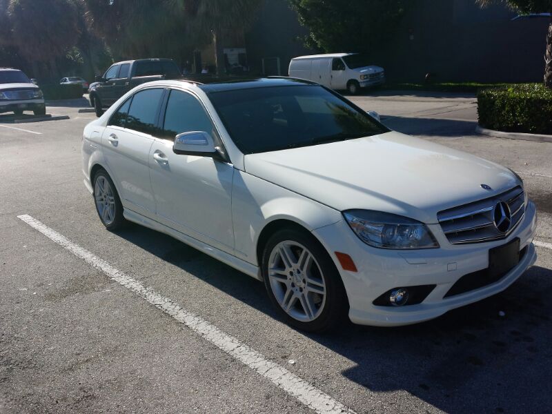

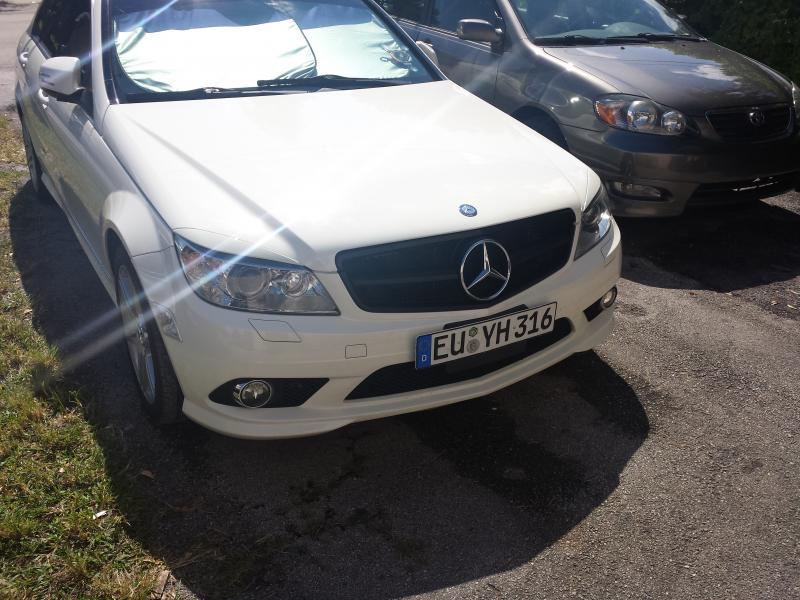

This is my car, I think that the black finish will look nice.
