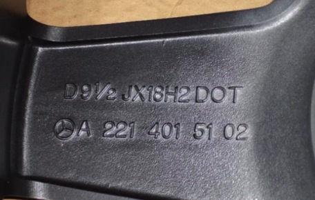

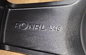

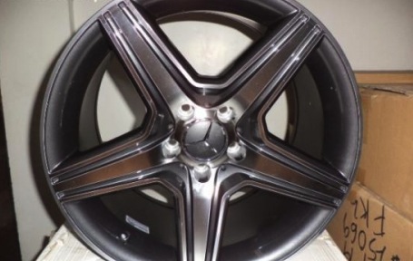

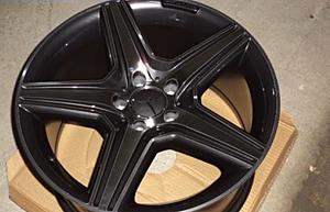

Hi Sirs.
I just got my w204 a few months ago and i am planning to upsize my rims from 17s to 18s. I have attached some pics of an ad that i saw online. Based on the pics, the rims have the AMG logo on the front. It seems that the markings are all there at the backside, even down to the part number. Im just not familiar with the "RONRL" marking. I've also seen "MADE IN ITALY" on AMG rims, but never "MADE IN GERMANY". Just would like to make sure that Im buying original rims before I make my decision.
Your comments would be greatly appreciated.
BTW, what tire size would you suggest for these rims? i dont plan on lowering my car.
Thanks!

The stampings on the inside doesnt look quite OEM and the RONRL logo pretty much sums it up, it should say RONAL.
My guess is that it is a pretty well made replica.

Ran the part number and this is what I got
A221 401 51 02
