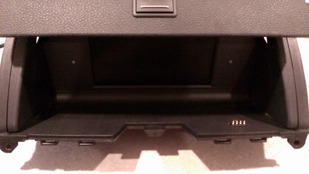

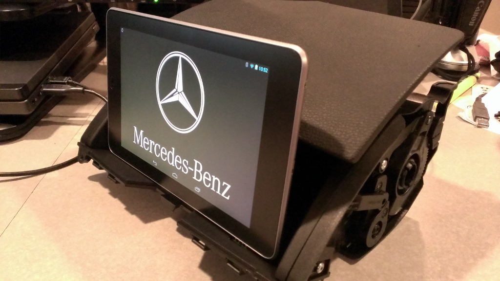

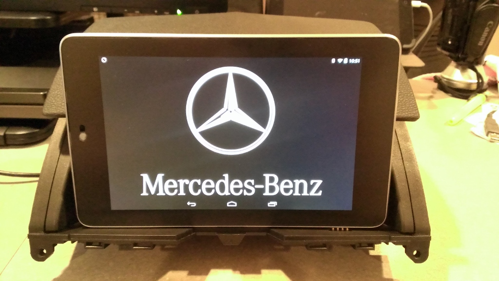

So I've been getting asked a number of questions on my tablet nav setup. I've been meaning to do this write up for a while now but have just been too busy. I apologize for the video quality in advance. Hope you like it anyway.
Here's a quick rundown of what I did:
  • Buy a Nexus 7 dock, take it apart and remove the circuit boards.
  • Remove A/C vents in car and then the head unit
  • Measure out where you want the pogo pins to lie and use a dremel to make the hole. Peel out the rubber mat and remove the goo before you start cutting.
  • Screw the pogo pin circuit board into the bottom of the head unit.
  • Pull down the glove compartment to drill a hole in it so you can run the power cable and audio cable to the 12v power and aux port. Grommet the hole makes it more stock looking.
  • Plug everything in and put everything back together.

Attached Thumbnails My Command Nav alternative (pics & videos)-image1.jpg   My Command Nav alternative (pics & videos)-image2.jpg   My Command Nav alternative (pics & videos)-image3.jpg
