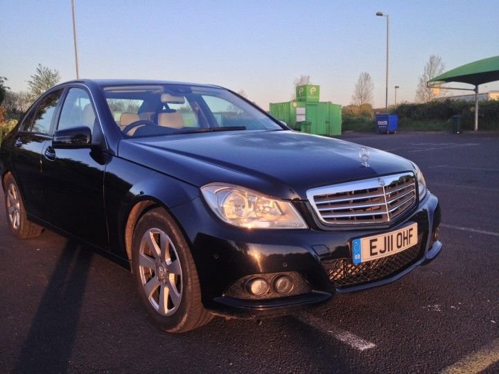

Base car - 2011 (Facelift) Mercedes C180 CGI BlueEfficiency. 4 Door Automatic in Obsidian Black.
Firstly, I am well aware that many people are not big on replica builds. And my message to you - It's my car!
Right where to start...
Purchased from Park Royal in Wembley at a great price with 29,000 on the clock as of April 2014.

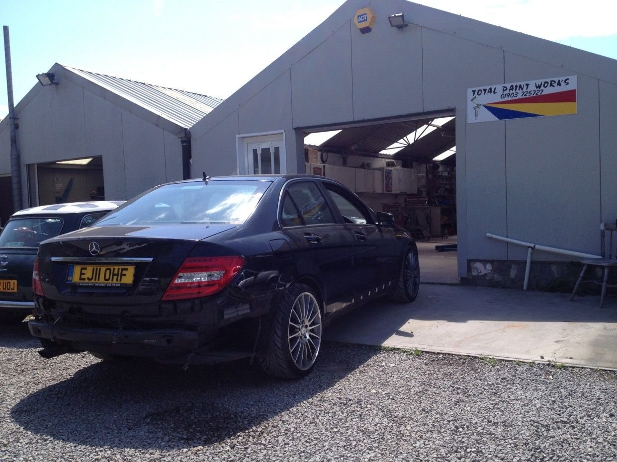

First move was the wheels, Couldn't bare to have the standard ones anymore! Decided on multispoke 19" C63 Style Alloys with low profiles. 8.5j's so 2.5" wider than the standard 6j's.
They have the same rolling radius as the standard 16" Rims so there won't be any affect to the geometry.
You can clearly see the new wheels extra width.
Looking much more appealing with the wheels on!

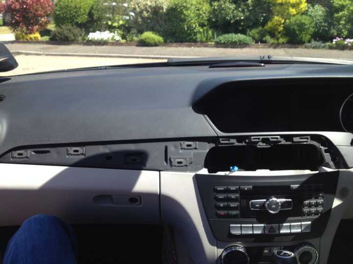

Next step whilst I waited for the body panels to arrive was the interior trim! I still need to tackle to door strips. Very easy to remove the dash and gear shifter trims (I took plenty of photos during the removal so if anyone would like a detailed walkthrough drop me a message).
Carbon Vinyl was the plan; Excuse the photo quality - My iPhone was having a bad day.

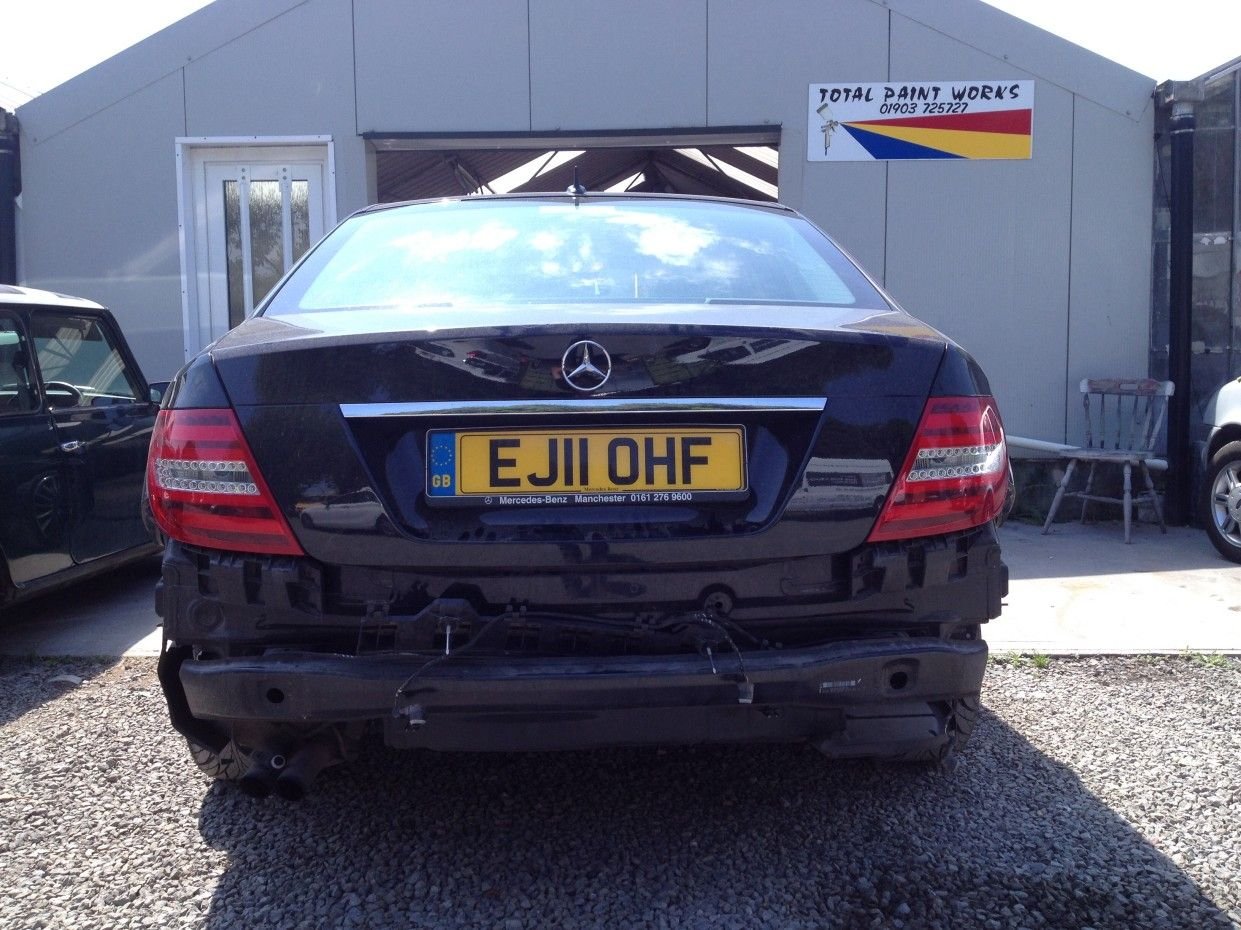

Waited 3 weeks for the body panels to arrive - Purchased from a European based tuning company - Haggled the price down by a few hundred which was a bonus - The main issue was the primer quality (all of the panels had to be re primered).
Here's some photos before we sent the car to the bodyshop!

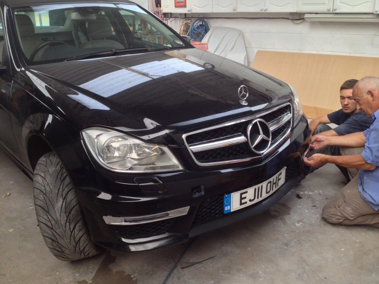

Off to the bodyshop we go, booked the car in for 3 days work. Total Paint Works based in Lyminster, West Sussex. Visited a few various local bodyshops and this guy seemed to have the most experience working on Mercedes. He also came with a reccommendation from a friend of mine which is always re-assuring! Great service, always there to help and couldn't of asked for more. Even gave an extra day's labour on the car (3 men!) to re-polish and finish some outstanding jobs all for the original quoted price.

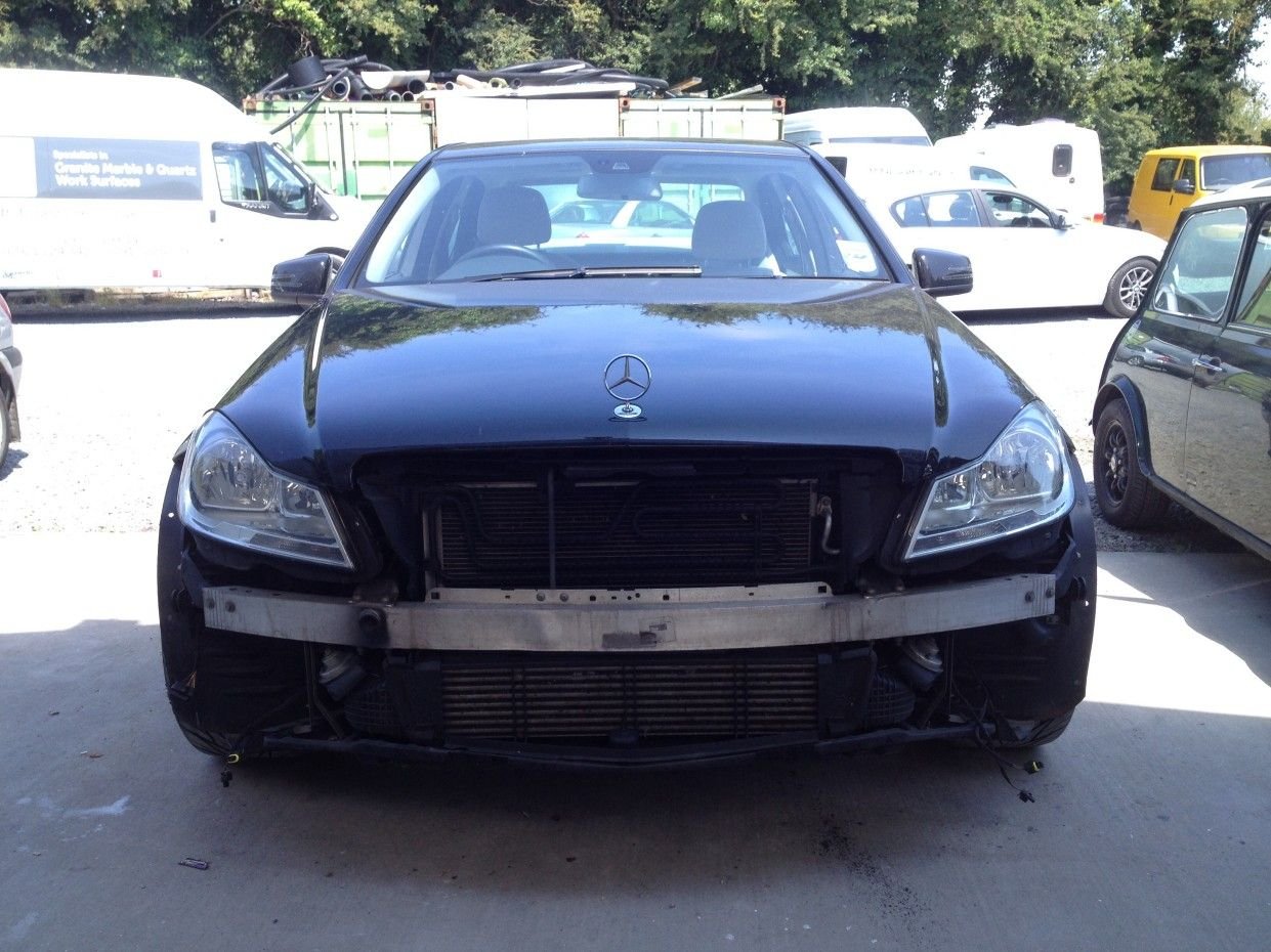

Had to give the guys a quick visit mid work to see how things were going, old primer being removed - Slow process!
Rear Bumper Removed
Front Bumper Removed
Side View

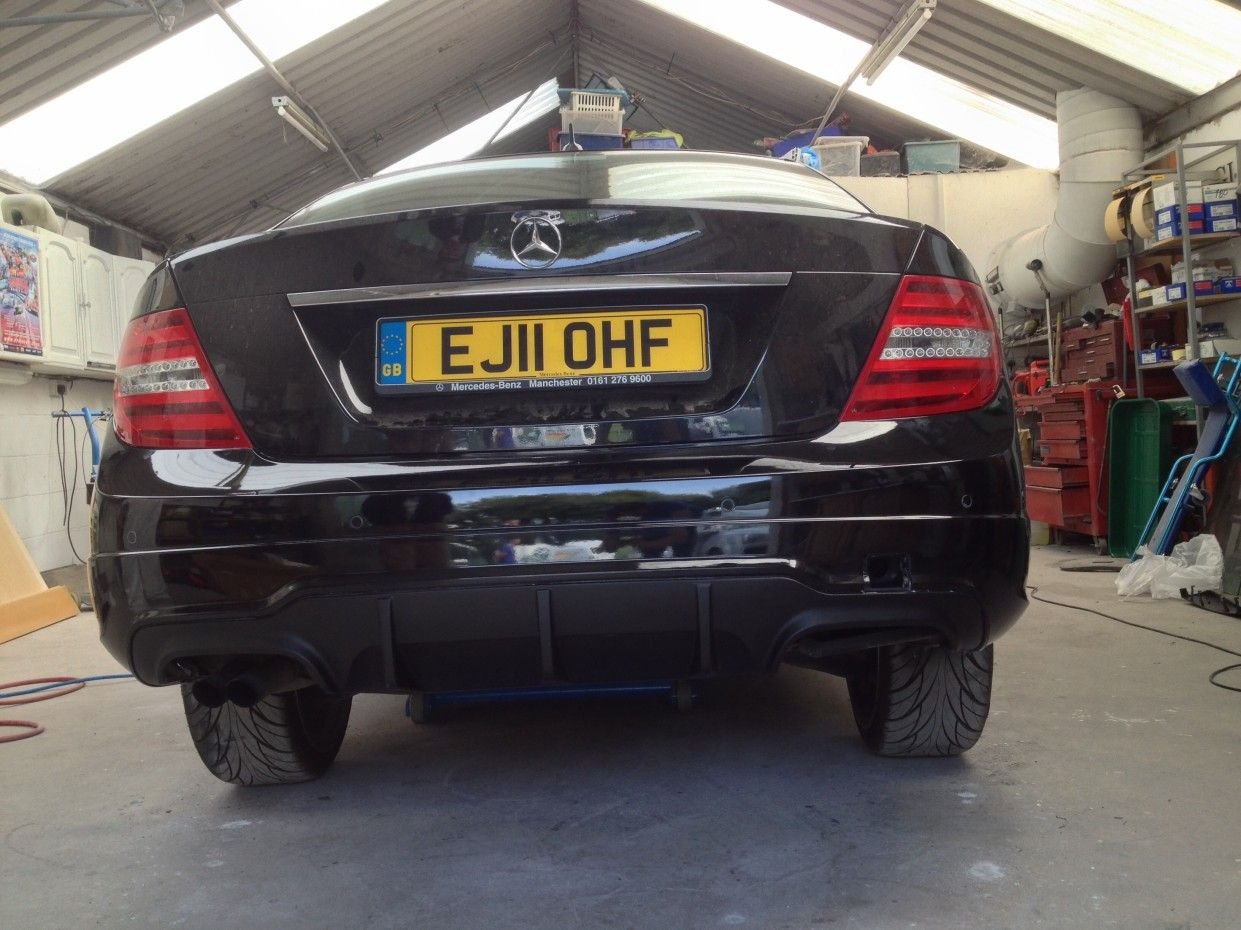

A few days later and I was back - Bumpers on, all painted and looking fresh! They did a great job matching the colour! Only issues we had were the DRL Casings, couldn't get the to remain cliped into the bumper! The car was booked into the Exhaust Garage the day after so some duct tape had to do untill I could bring it back!
Looked very weird without the exhaust tips...
And weird with the bonnet star still in place! - Soon to be removed...

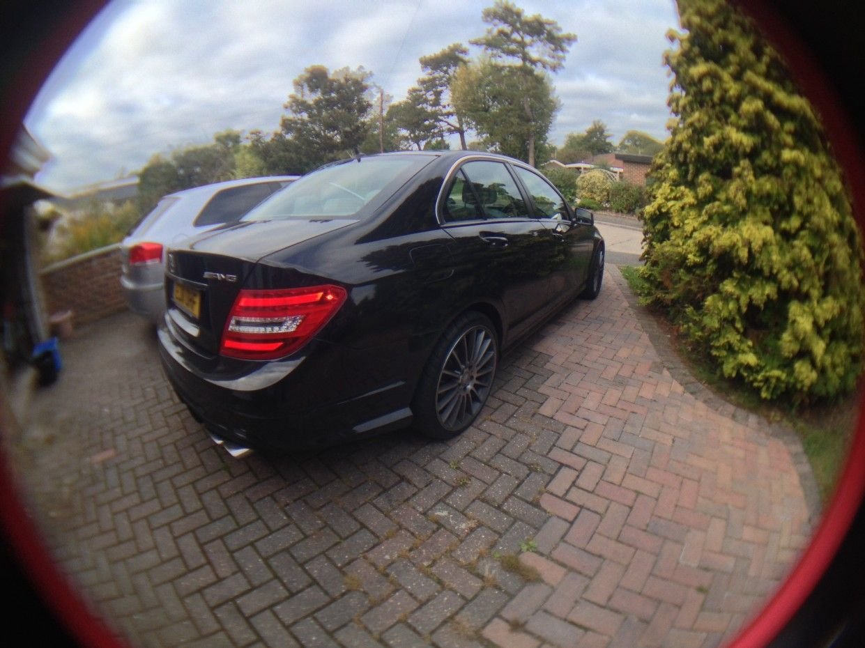

The finished product...
Exactly how I wanted it to turn out...
I am well aware that it isn't an EXACT replica, the bonnet for example, brakes, interior etc. but for me, it looks good enough!
