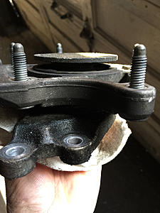

I would say that the issue is on transmission mount and engine mounts. When the rubber piece between the 2 plates is gone, the transmission vibrates on stop or idle. While in neutral is ok because the tranny is not doing anything. I just replaced mine and the issue is solved. Is an easy job as long as you have the proper tools to do the job. Hope it helps.
Attached Thumbnails Vibration in brake pedal stopped in gear-image-4020954525.jpg

Forgot to attach pic of the new part.
Attached Thumbnails Vibration in brake pedal stopped in gear-image-2761978744.jpg
