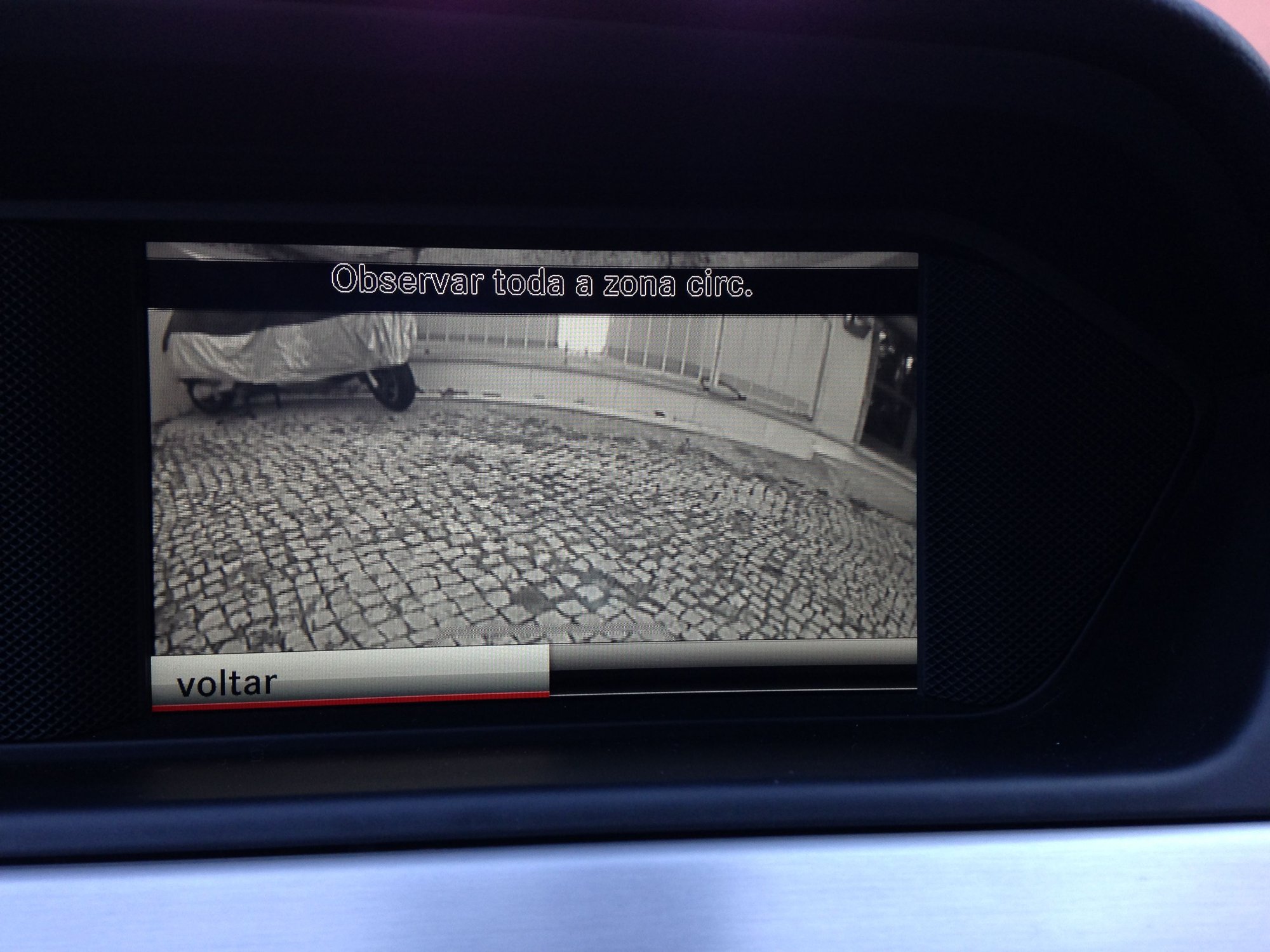

Image shows in black and white.

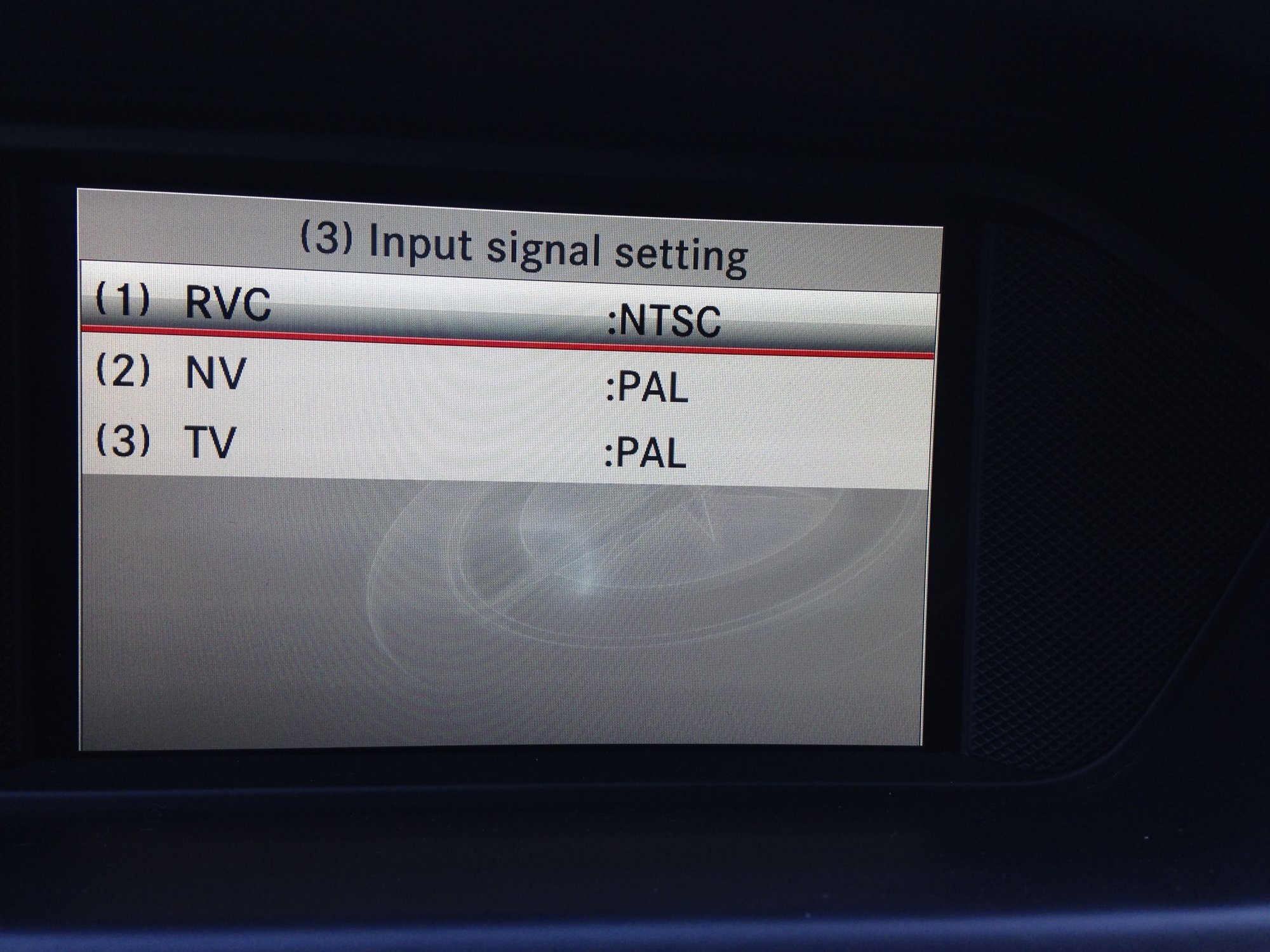

I went to the engineering menu, "Input Signal Setting", and the default for the Reverse Camera is NTSC. My camera is PAL.
When I change to PAL I click END and the system reboots and when it back again, the signal is in NTSC again.
If I make a preview on the engineering menu in PAL, image is fine.
Any ideas on how make this change to PAL permanent?

I have the NTG4 and not the NTG4.5. In my system, for reverse camera it only accepts NTSC cameras, not PAL cameras. And i think that for NTG4.5 is the same thing.

The strange thing is that I can change the video input from NTSC to PAL, but after system restart it goes back to NTSC again.

Well, i installed myself the rearview camera in my car. First, i checked all the options in the enginering menu (secret menu). But that was all ok! Then i tried with a pal camera (i had one in home before get one). With the PAL camera the screen flickered and just give a black and white image. Then i adquire a NTSC camera and the image is ok since then in colour, without any problem. Just get a NTSC camera with water protection! And dont connect the power to rear lamp power!! Search for fuse 71 that is constant power! Get a fuse in that for the camera! As the camera will be on all the time (even if in the Command unit doesnt give any image), dont get a cmos camera. Get a CCD camera!!
